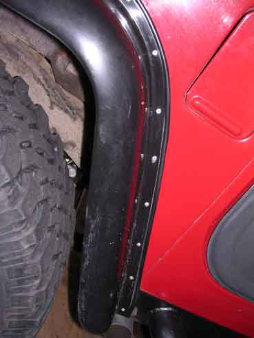

x2 - I run this exact tire size and the fenders wells were cut.
Anyway.... the best, cleanest appearing route will be small drill holes with rivets. Most nice fender flares (like those by MAF) come with nice evenly spaced holes already on the flares, you just make nice clean holes in the body and rivet (forget screws) and it looks as good as it gets. Hell, you can even get black rivets so it blends in even more.

that is not my rig.... just the one off of Man-A-Fre to show the dude the flares with rivets.. but I have the exact same setup
here are mine...
