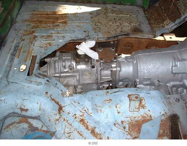

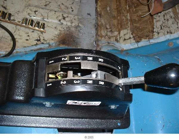

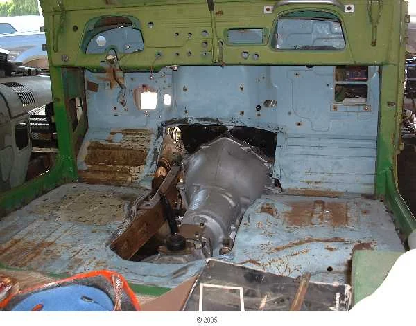

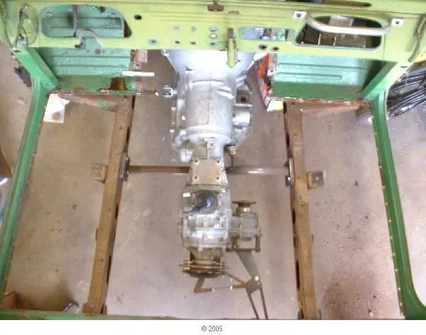

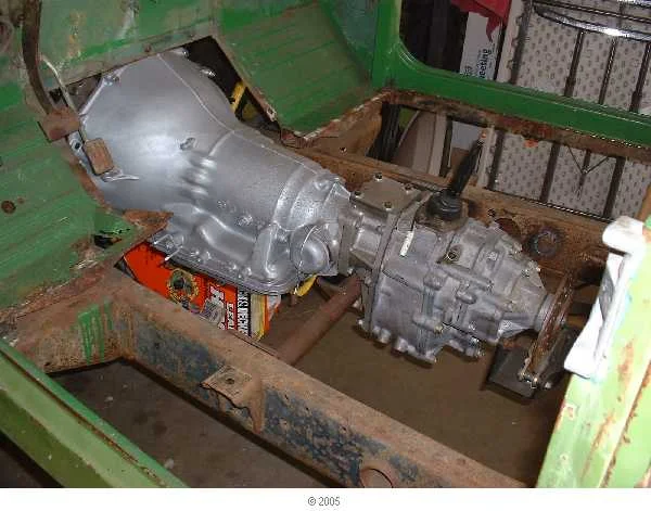

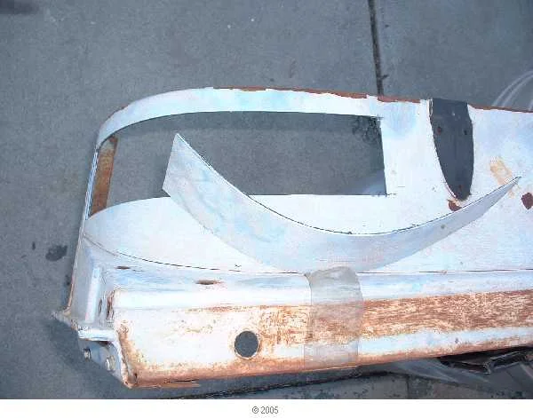

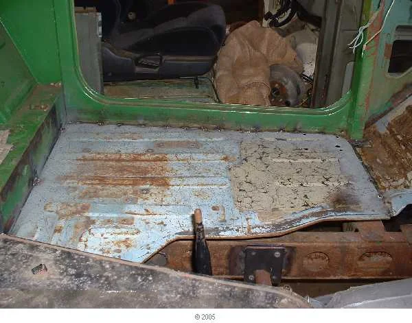

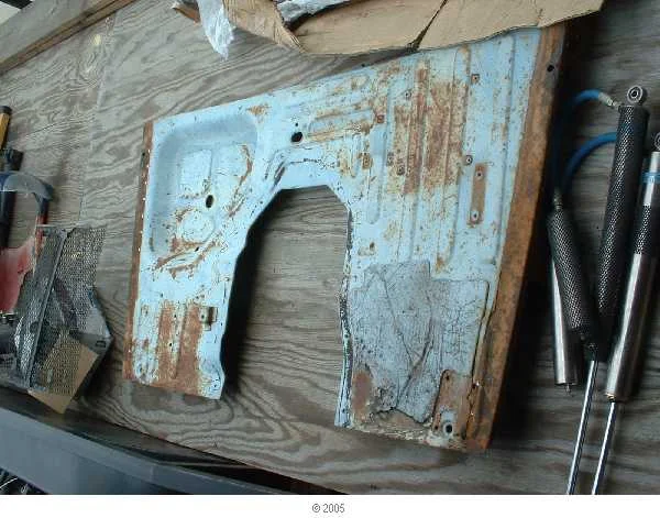

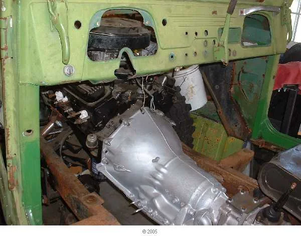

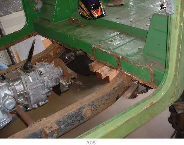

Well, I am pretty much finished with my sons car (still needs a clutch ), so now I am back working on my own junk. Got to have 1 cruiser running, right?? Feels pretty good working on it again.
I scored a tub from Wasabi, cut it up, sold off what I did not need and kept the floor and firewall. I cut out the cancerous floor today with the plasma, again what a time saver. I know it has been a long time away, because within 15 minutes of starting to cut out the floor, I started a fire under the cruiser. I had stored a front axle under the cruiser, it had some towels covering (key word "had"), anyway they caught on fire and I was under the cruiser smacking the flames with my gloves to put it out. Whew, that is the most fire I have seen in a while!!! The wife just gave me the look of, your such an idiot
Okay, pics of todays progress.

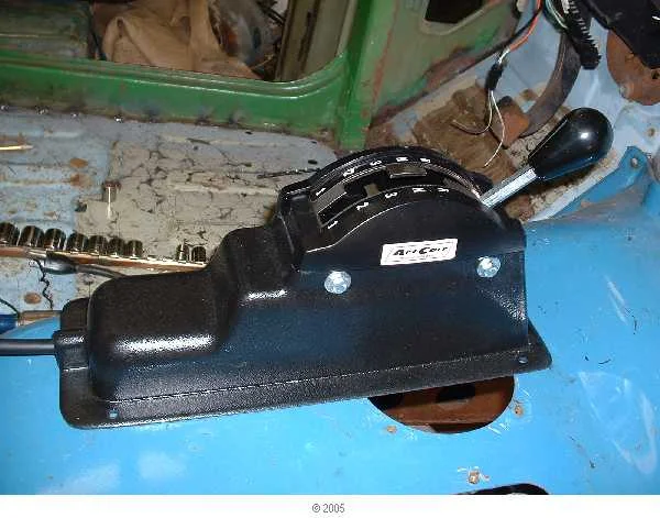

A couple of more. Once the floor is in, I will be installing the late model firewall.

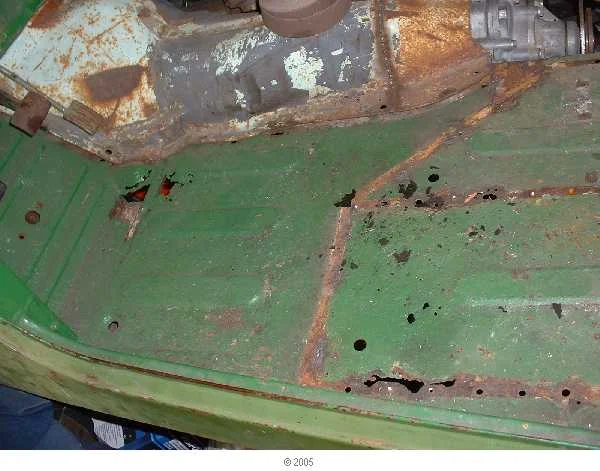

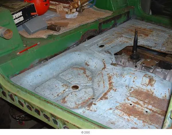

I removed the firewall today and started prepping the joint areas of the tub (flapper disc and self etching primer) for re-assembly. The new firewall has been prepped for install, as well as the new floor. I hope to have the tub back together by Friday.

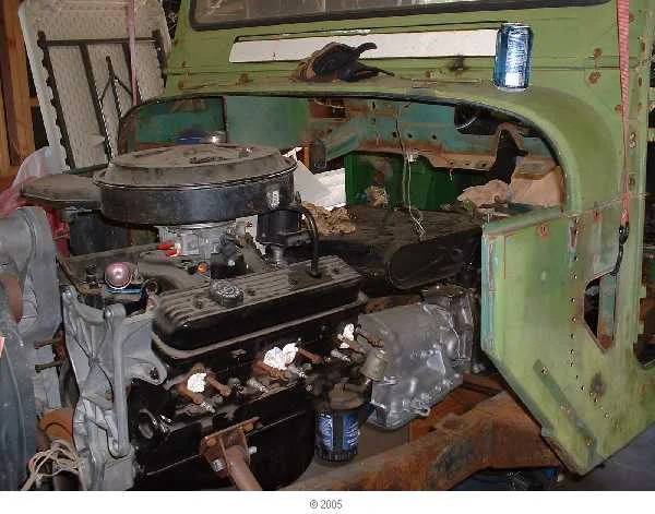

It seems I remember those exact same pictures but the sheetmetal surrounding the drivetrain was tan instead of green...

I have gotten the new firewall and floor welded in and am getting the frame ready for sand blast. I am making progress, slow and steady wins the race, so get off my back, Lumpy.

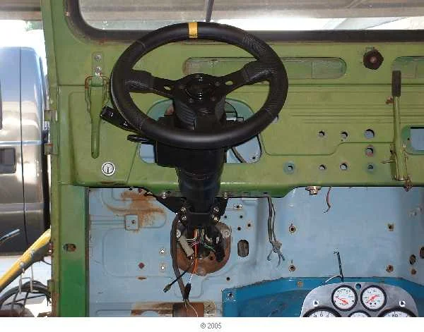

Found the pics of the new firewall and floor. After a lot of fitting trial and error, I was able to weld it in place. A nice improvement over the old floor, this one has only minor surface rust.Now the body work begins!!

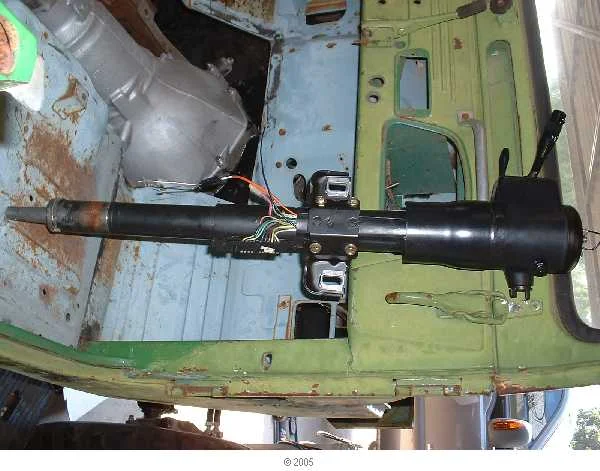

One more of the firewall and dash. A pic of my new tilt steering column out of an 89 Trans Am. Got it from pick a part over the labor day 1/2 off weekend, paid $15.00 for it!!! Grabbed a Taurus fan while I was there,too.

I have been taking baby steps on this project lately, but it has been progress (so get off my A$$ Terry). Today, I fabbed up my new mount to install my new tilt column and bolted on the new 13" steering wheel. The Art Carr shifter with one of their new modified shift gates showed up on the door step while I was at work. Now to figure out where it is going to be mounted. I will need to allow room for the twin stick for the t-case.

Today I put the body back down on the frame. In order to do that, I had to clearance the floor. Since this is my new floor, I made a tester cut around my e-brake disc and trimmed as little as possible. I then had to stretch my new trans cover 3". I had an old cowl in the garage, so I cut out a 3"x15" strip to use as my filler. After getting the bends pretty close I tacked it together, flapper disc the welds down and added a little primer. I still need to finish the edges and drill some mounting holes to keep it to the floor.

A few more
