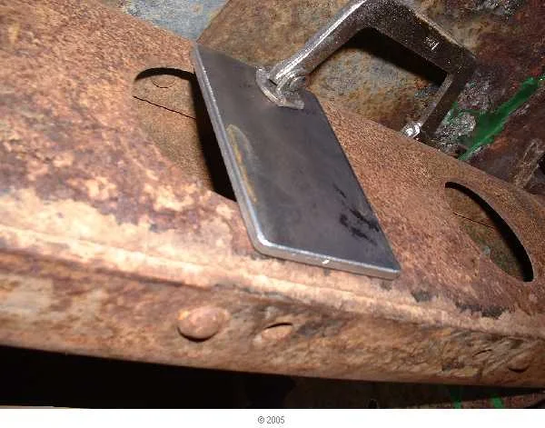

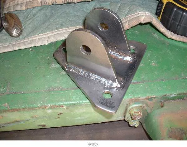

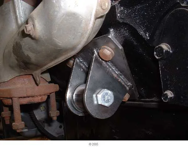

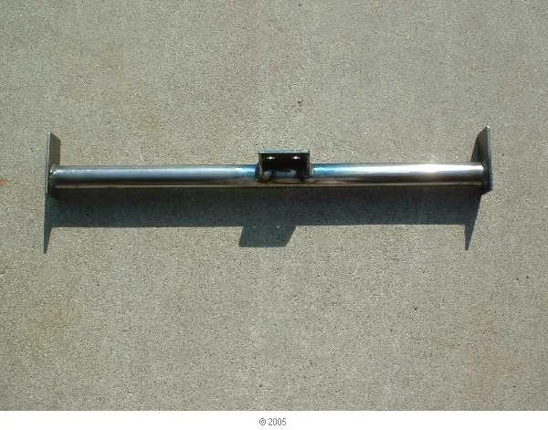

Thanks for the info Lumpy. I ordered the twin stick from them today.

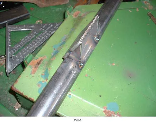

This morning I fabbed new motor mounts. The motor will be going in next week.
A couple of photos of the mounts.

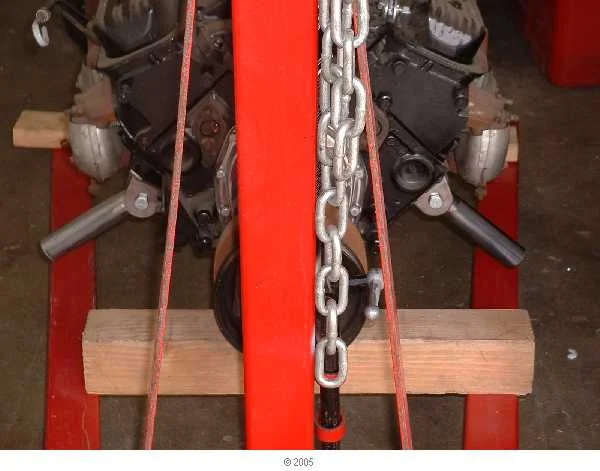

2 more

you wanna make me some mounts?
dang nice work

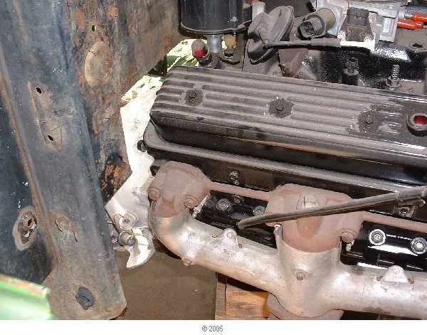

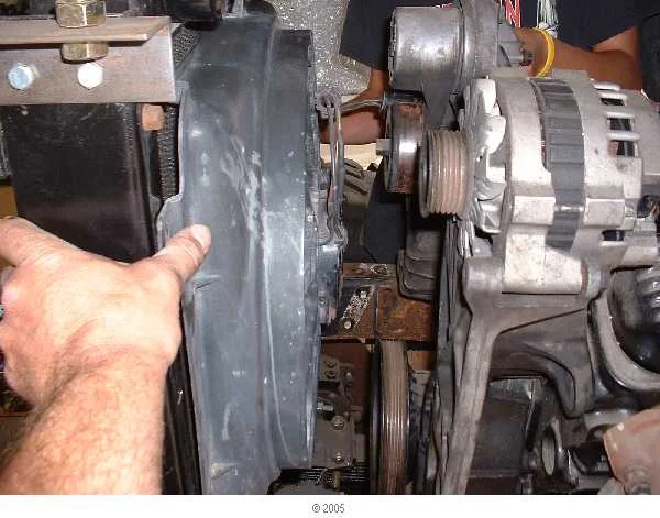

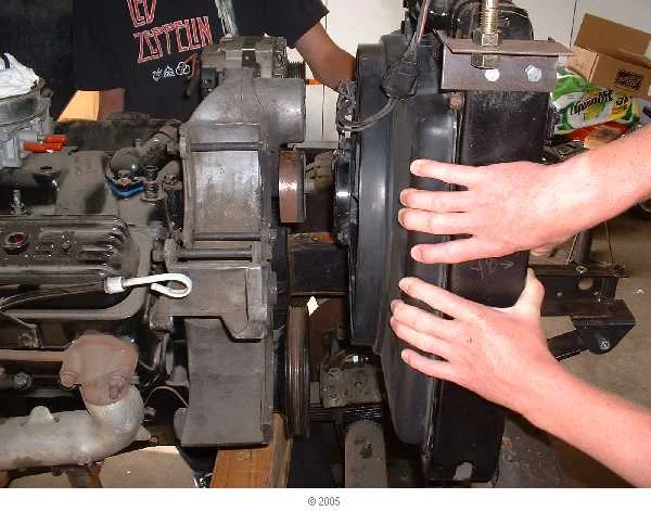

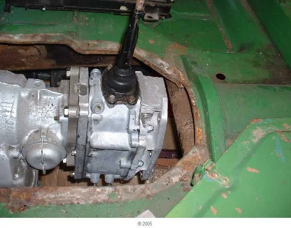

This afternoon I got the motor sitting back in the frame rails. I have about 3" between the fan and pulleys, and 1 1/2" between the firewall and the pass. side head. Tomorrow I will be welding the motor mounts to the frame and fabbing a new cross member/transmission mount. Here are a few pics of todays progress.

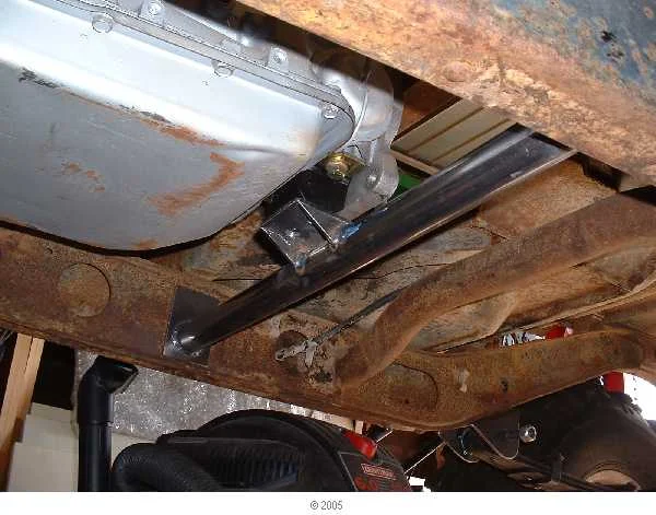

Posts: 8
Can you make me a sparkling wiggle container for my hoobajiggers??
couldbeworse is offline   Reply With Quote
Old 05-23-07, 07:48 PM   #129 (permalink)

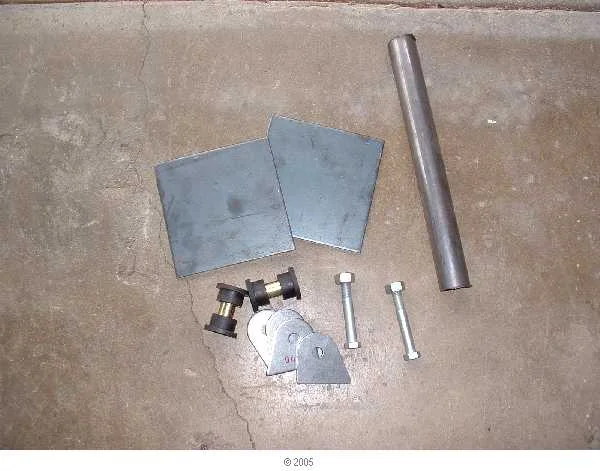

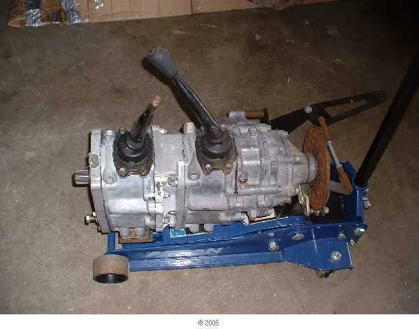

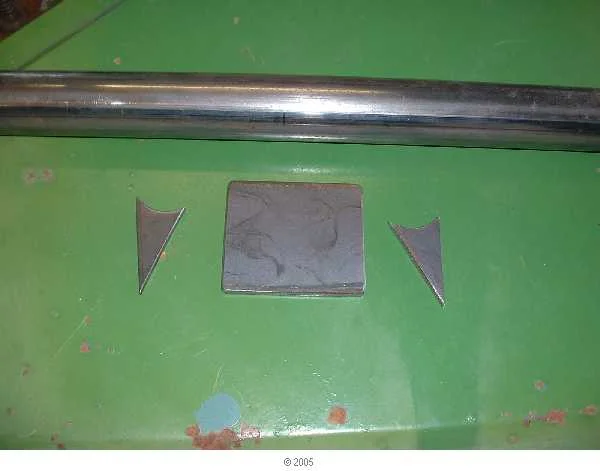

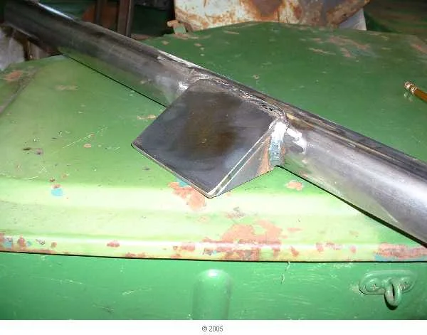

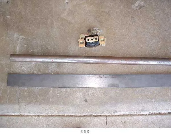

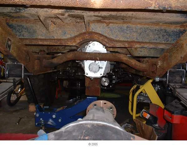

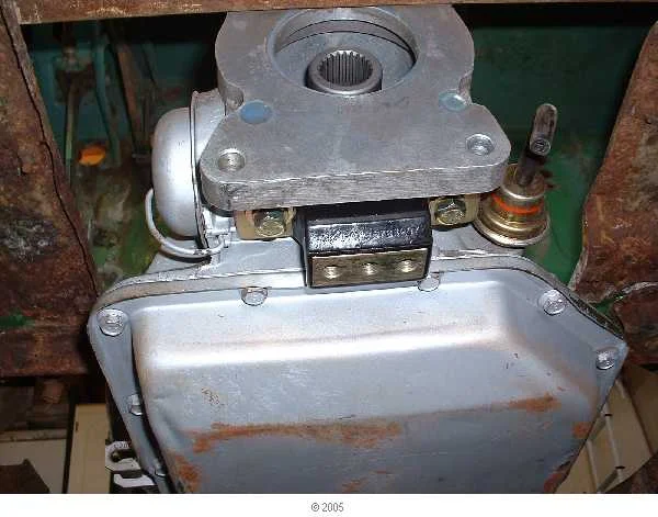

Today, I made my trans mount and welded in the motor mounts. The trans mounts I made out of 1 1/2" tubing, 3/16" plate and a new isolator from Energy Suspension. The pics tell the story better than I can, so here you go......

more........

Motor mounts welded up.

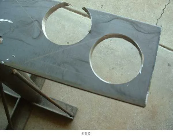

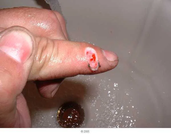

Well I finally get some time in the garage on the cruiser. Everything was going great until I tried using the angle grinder. As I am trying to get the bleeding to stop, I snapped a pic of my finger I managed to get between the wheel and the guard. It is amazing how fast it tore through my flesh down to the cartilage!!!
In my best Napolean Dynamite voice" It hurts real bad"

cool
Quote:
Originally Posted by rockcod View Post
"Builder Balls" and mounts.
Hi,
Any more info on these ? Why did you pick them and have you ever seen them in action ? Any ideas on what they would be like in a DD ?
turbo42 is offline   Reply With Quote

Turbo,
Rubicon Express has a website, they use these on their suspension kits. My car will see limited time on the street, but I will let you know how it works out when it is finished. I wanted more shackle movement than the conventional bushing would allow.

Okay, enough blood and guts and tales of whoa!!
Finally back into the garage and ready get something done. The dual transfer case idea will probably have to be scrapped. I installed the front t-case to see where everything is going to end up. If I continue with this I will cut out 13" out of the floor and probably have a big issue with the fuel tank My next step is to remove the cross member, remove the rock box and bolt up the single t-case to the transmission and see how that fits up.
One last option is maybe a 1" body lift. Now I am not a fan of body lifts, but I am keeping my options open at this point.
