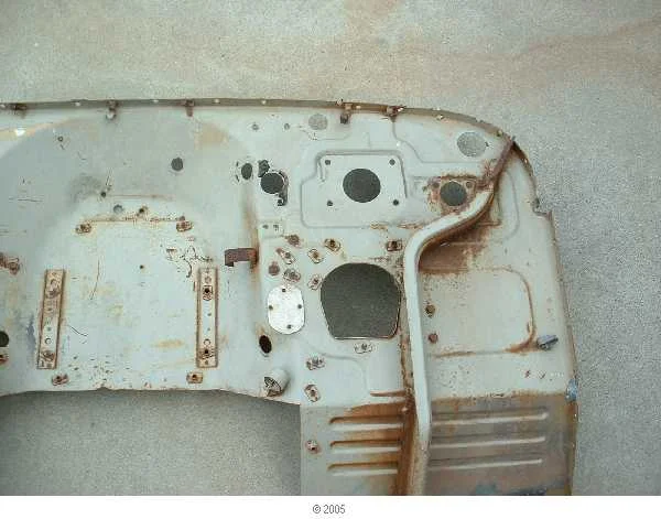

Did a little filling this morning. The PO had drilled holes in the bezel, to mount something???? My Father-in-law gave me this hole filling trick for sheet metal. I took a piece of copper clamping it behind the holes I was filling. The copper acts as a heat sink (no warping the sheet metal) and backing for the fill weld. The weld does not stick to the copper, it just falls off once the clamp is taken off. It worked really well. After grinding down the welds I hit it with some primer to prevent any surface rust, until I get it into the sand blaster and finish paint.

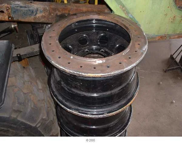

A new garage toy and some new wheels!!!!!!
I have a spare stamped bezel just like that, had a license plate mounted to it. What do people think when they do horrible things like that!

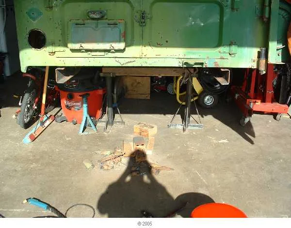

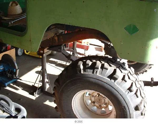

This morning I cut off the old spring perches (with the new plasma) and ground the excess smooth. Next I made some headway my rear spring hangers, I used 4 x 4 x.250 wall. Keeping them flush with the bottom of the frame.

Yesterday I picked my beadlocks from the weld shop and found my new later model firewall with the power booster ribbing and steering column mount.

you got skillz, why didnt you diy beadlocks,

To have them do it, it cost me a coffee mug to get them welded, so I figured what the heck!!!

I was able to spend some time in the garage today. I had to remove the rear cross member, due to it being bent. I was able to get it out without removing the tub (thanks to the plasma!!!), it made short work of the rivets and frozen in place body bolts. I clamped the rear spring hangers on the frame to see where the shackles will end up, and the WB is now 105". I hate to trim that much out of the fender opening, but the room will be needed for my motor, trans and t-case combo. I still need to make a rear bumper/cross member, my upper shackle mount will attach to it as well. I am waiting for my Rubicon Express builder balls, they will be used for my upper shackle mounts. Couple of pics from today.
