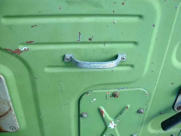

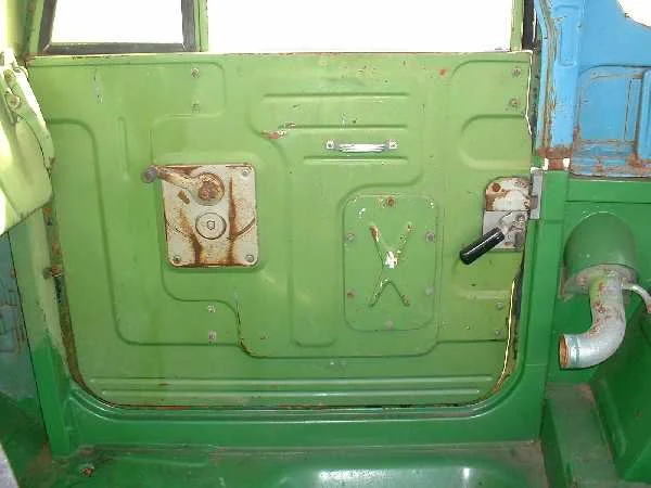

Are these door handle pulls original? I have only seen the plastic strap type. I am not familiar with the early stuff.

I’ve got the same pulls on my 69 I did not think they were original. Maybe!
You mean to tell me snot green was not an option in 63.

Same ones as the 69 my dad used to own

My 71's look like that.

I agree, handles look like a cheap add-on but pretty sure they're stock. Have em on my 73' Looking forward to following your build

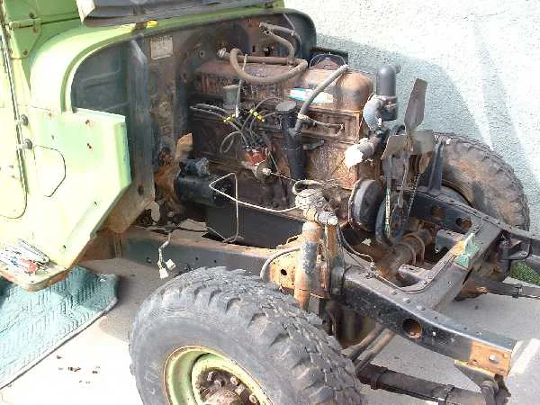

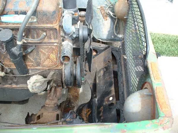

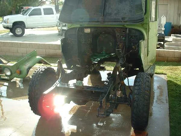

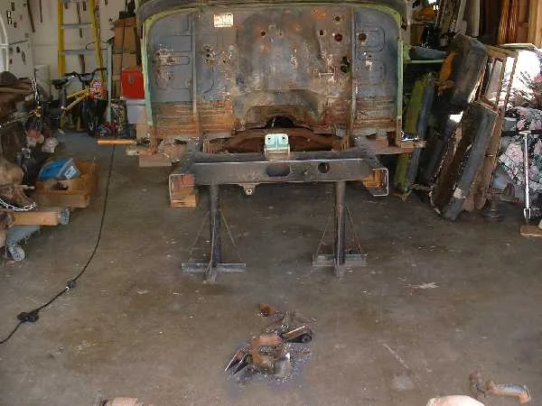

The official "deconstruction" has begun, got home from work this morning and starting removing the motor trans and t-case. They will be going to a new home this Sunday or the next. With the motor out, next I will be removing the steering mount pedestal, shock towers and front shackles and hangers. I will be able to address the frame issue (crack), box the frame and weld in my PS mounting plate I purchased from Georg about a year ago (I guess it is about time I use it ). Here are some photos from today.

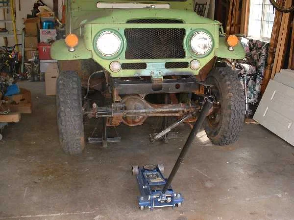

Last one...........

Those handles are stock. My '64 doors have them.

Thanks for answering the handle question, I thought they were cabinet handles.

yeah, a couple of my sets of early doors have them too, not sure what year any of them are from, so i couldn't tell you if they were stock for all early doors or not...

I have unknown vintage doors as I got them from a yard but they have the same pulls

I got a couple of hours work in this AM, I pulled the shock towers, center arm, steering column, steering pedestal mount off the frame. AAARGH!!!! I hate rivets!!!!

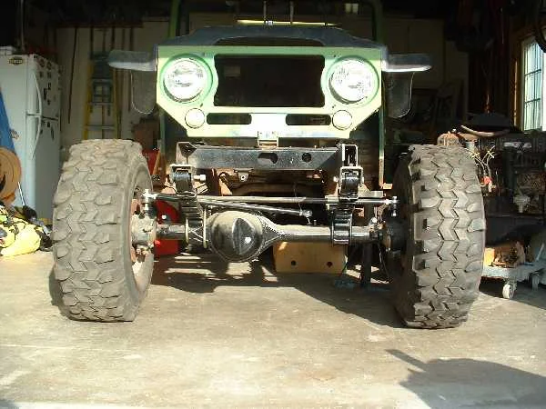

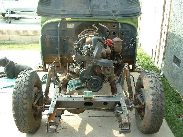

I was able to get some work on the cruiser today, Eeeyore came by and helped remove rivets and brackets. We got the motor mounts, shackles and hangers, and front axle/springs removed. I will be addressing the cracked frame next, and will hopefully have the shackle reverse and spring over done this weekend. Here are some photos from the days progress.

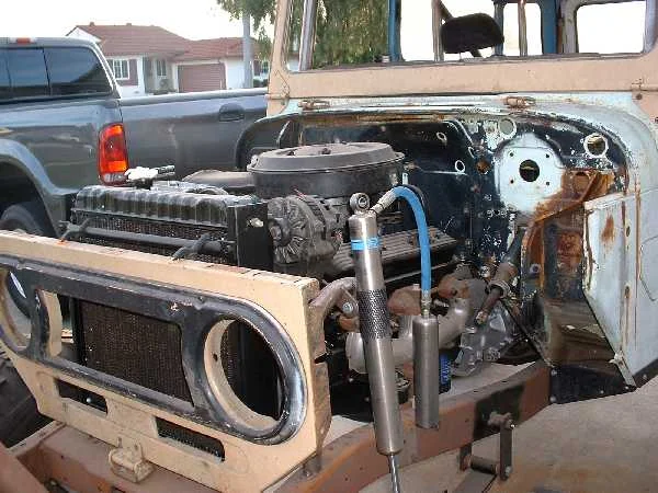

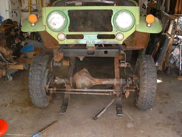

The 74 is starting give up it's parts!!!!!

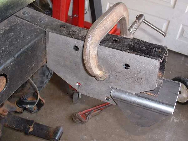

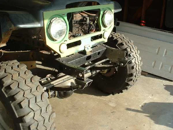

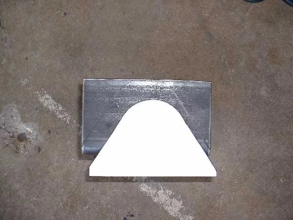

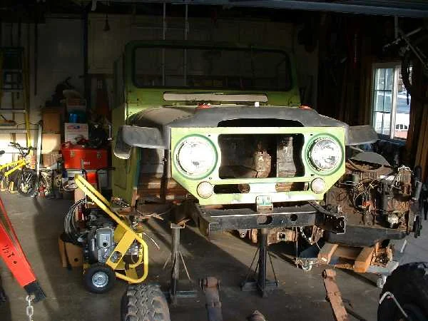

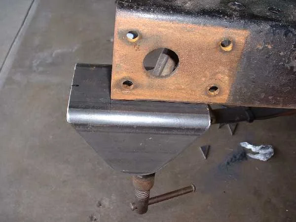

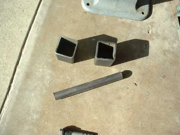

Okay, I have been boring everyone with pics of me taking Snotz apart. Well today, I finally got to start some fab work.
I used 3 1/2 x 3 1/2 x .250 square tubing for my front spring hangers and cut and fit my power steering bracket. With everything out of the way, I ground the PO's hit and miss welds on the cracked frame horn to see what the heck was actually there to work with. The frame horn needed straightening and rewelding, and worked out very well, despite welding in the wind!!! The hangers are temporarily bolted to the frame to allow for some adjustment when I do the shackle end of the project. It is going to be a busy week for me, so it will have to wait until next weekend. The frame will get boxed and the power steering mounting bracket will all be welded up next weekend as well. Anyway, the pics tell the story better than I can........

more.......

nice work in the hangers
