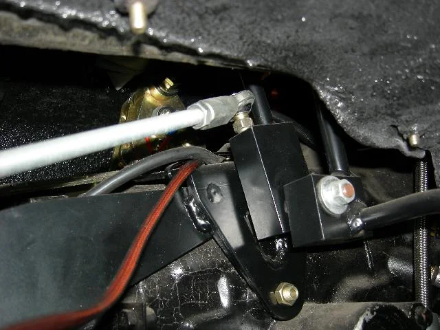

I am looking for pics of a AA twin sticks installed on a 700r4 trans (SBC of coarse. )
My concern is that the twin stick kit will be to far back on the trans and come up to far back in the trans tunnel to use a bench seat.. (Yes I do want a bench seat)
I know everyone thinks that paying for twin sticks is a little crazy but, to me it may save enough time and energy to justify the cost.
Besides my linkage pretty much sucks as it is.

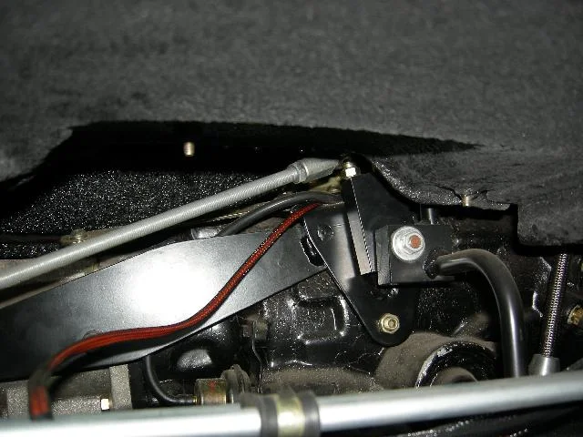

I thought that I had a couple more of them someplace...
Same project...with the correct tub on the frame:
Lokar shifter, modified support and pivot mounting plate for the AA twin stick..
The 1962 FST truck had a three speed floor shift trans and tcase in it when it came into the shop that someone had put in at one time.
The Lokar cane passes through that hole in the floor that took a stock three-speed shifter boot.
You could make something very similar and make it function with your bench seat, no problem.
I will try and get you a couple better pics tomorrow...

ATS6350C AUTO TRANS SHIFTER TH-350 12"
I think that I am going to need to install a taller cane however...I do not have everything dialed in just yet with this build...

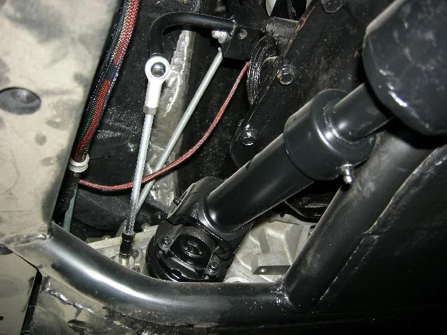

A few more pics of this twin stick set up....

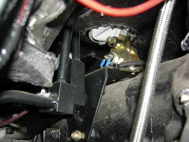

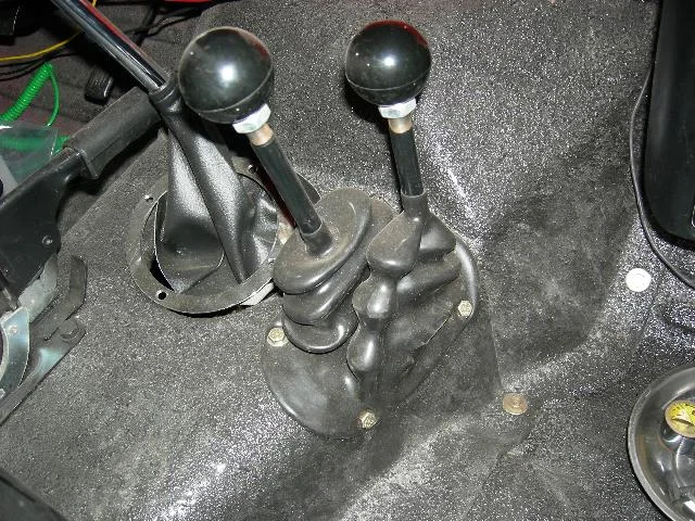

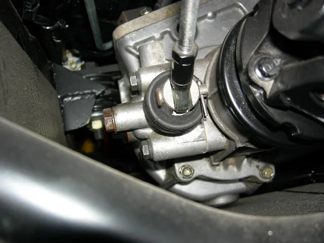

Three more...

ok, i dont get it, why would someone need twin sticks on a t-case?
does this get you 2L?

It simplifies the linkage when you need to replace the stock linkage. Like Poser changing transmissions or me when I added a Toy box (and 6") to my drive train.
The only utility I can see for 2L is for the guys that have an auto locker in the front. They tend to get bound up trying to negoiate tight switch backs. But I think this may have been discussed before.
