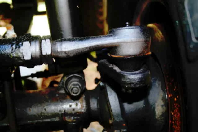

all pro highsteer, 1 ton GM tie rod ends, DOM tie rod

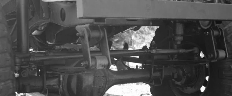

shot of entire steering - all pro off road rebuild kit for front axle, no bumpsteer at all

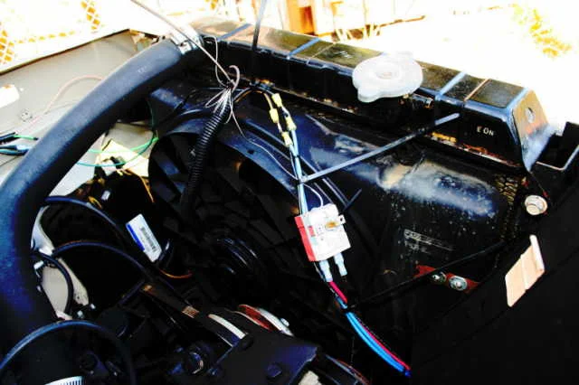

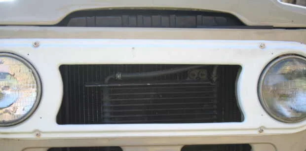

ford Taurus fan with adjustable Thermo-relay and an fj80 oil cooler mounted on my radiator to cool the engine oil.

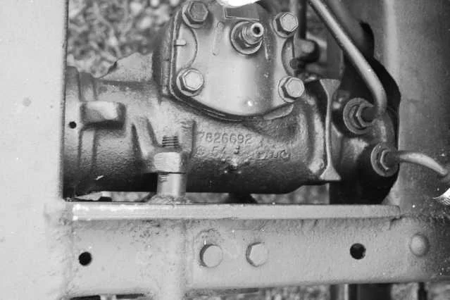

rear light style
steering box (saginaw)

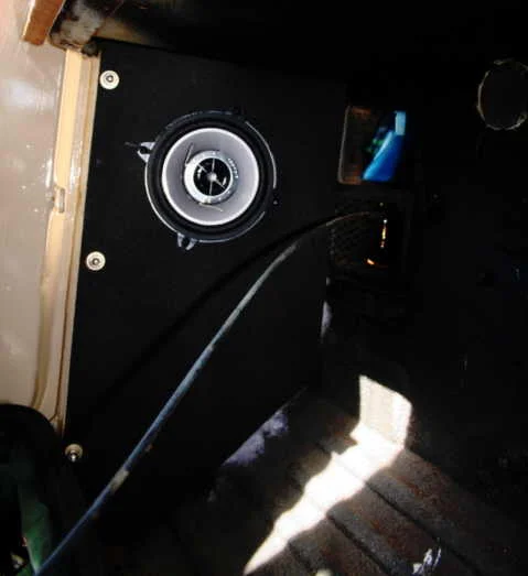

these came out cool and sound good - made a kicker panel from some kind of veneer type wood and sprayed it with truck bed liner- where the speaker mounts and near the kick vent i stuffed it with polyfill and it sounds great....
