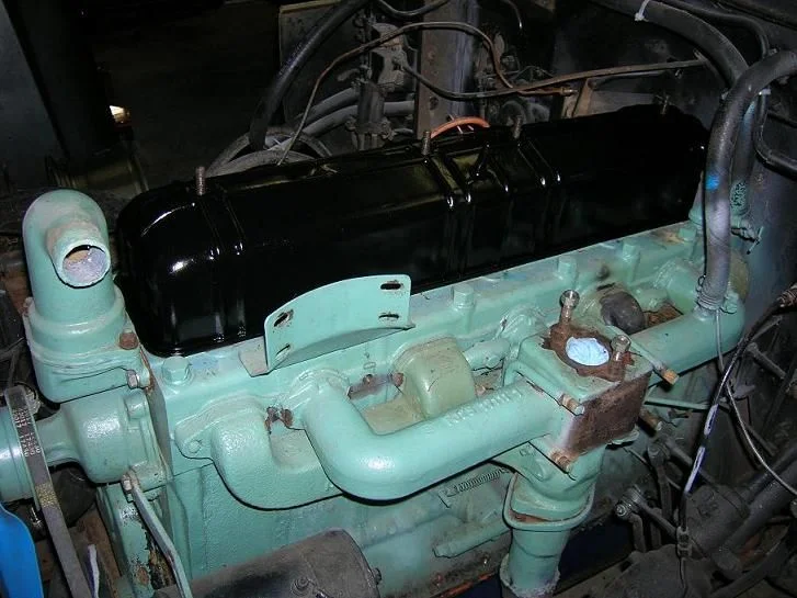

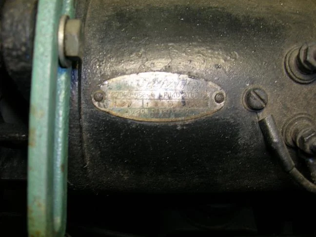

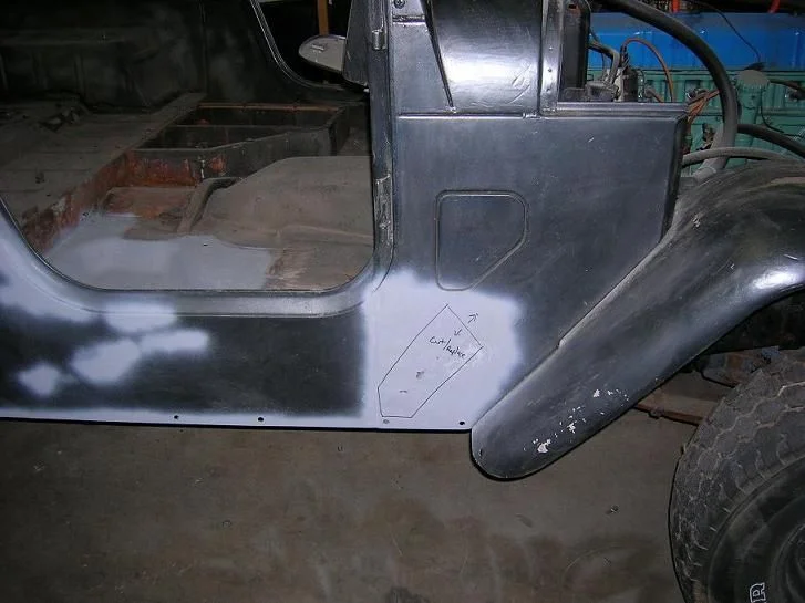

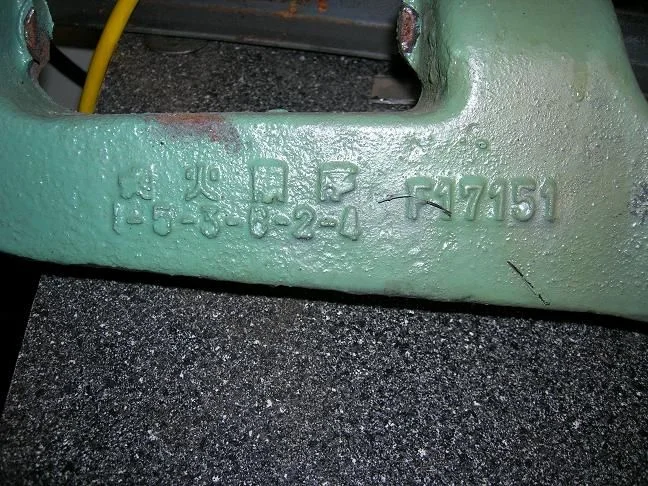

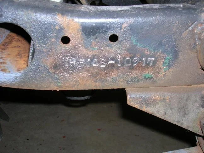

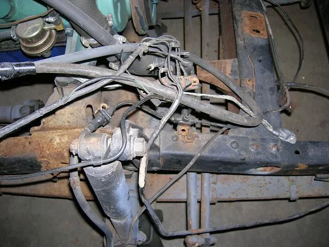

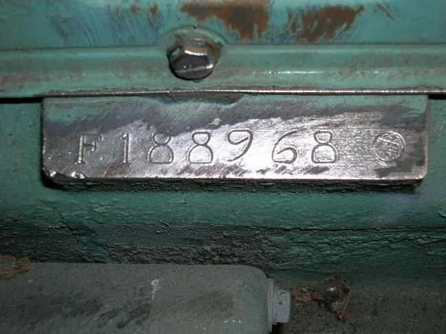

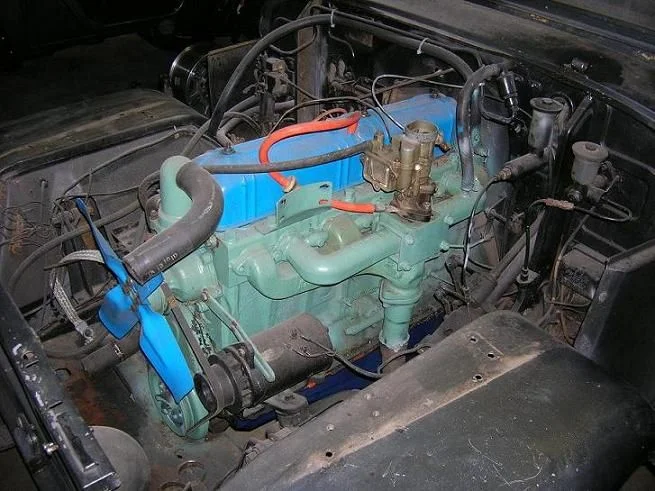

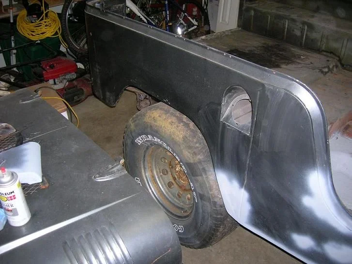

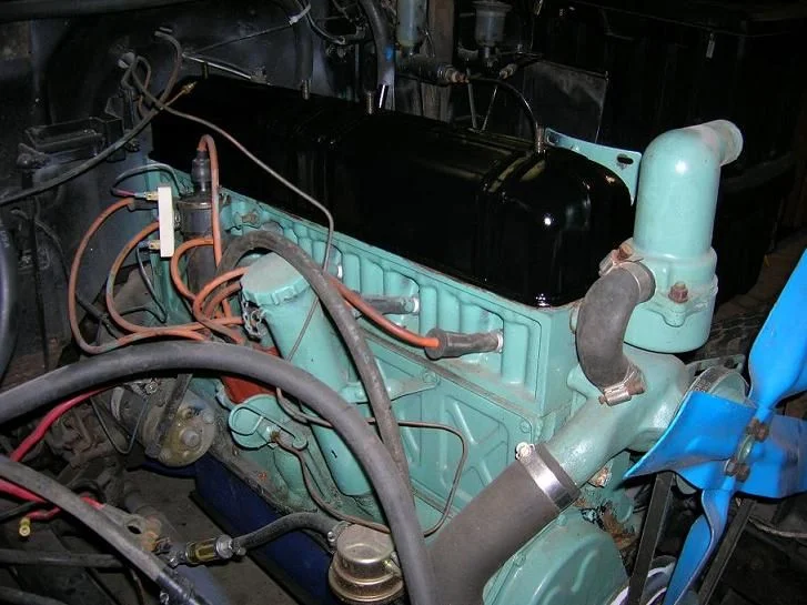

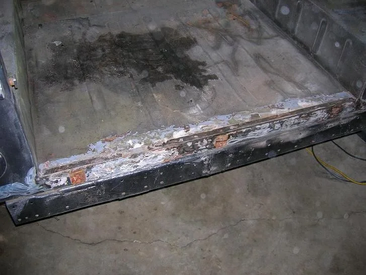

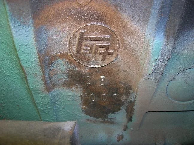

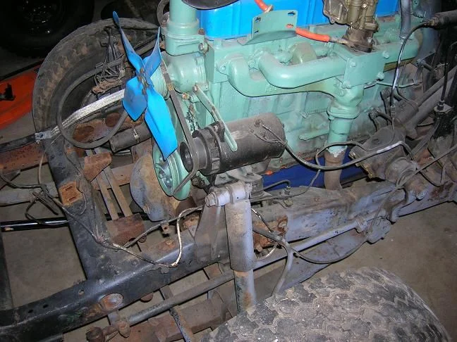

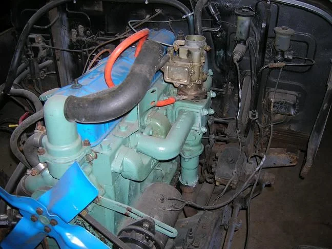

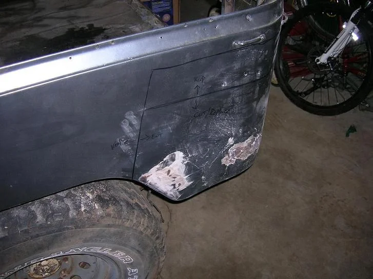

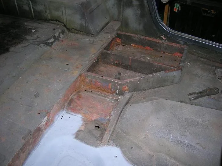

The grey primer is where I sanded down to bare metal to see how bad the damage was. The entire floor was covered in fiberglass (some can still be seen in the tool box area). I probably have to replace the floorboard under the toolbox and where the gastank sits (this is still solid metal but very pitted).
The engine photo shows all that was there when i got it. Missing radiator/mount, air cleaner assembly.
I should have a centered TC but it appears that a newer one was swapped in since the driveshaft is at an angle towards the centered rear diff.
I still have a bunch of research to do on this and I hope to save the body. Not sure if I will keep it completely stock (due to all the missing parts) or just make it a really nice driver. I will tear it all the way down to the frame, POR15, new suspension, and attempt to repair the body. Engine/trans/TC is still an option I am considering.

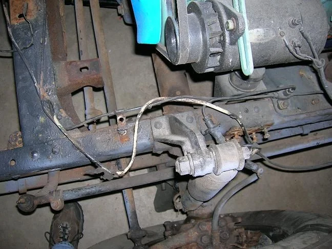

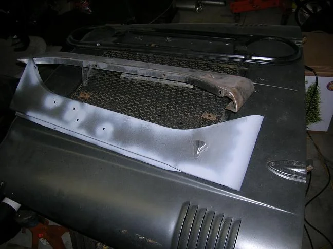

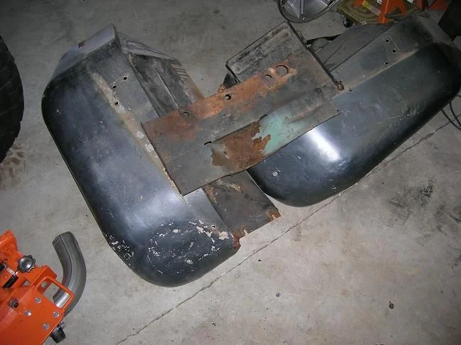

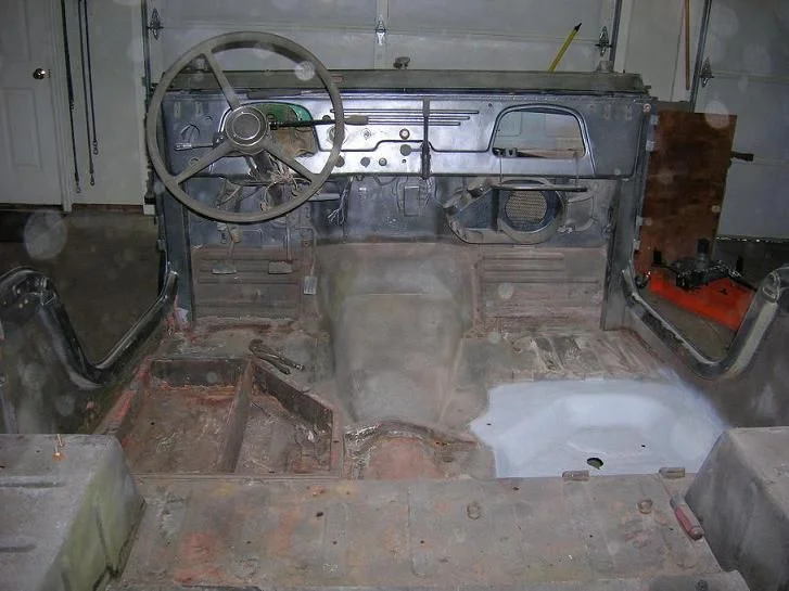

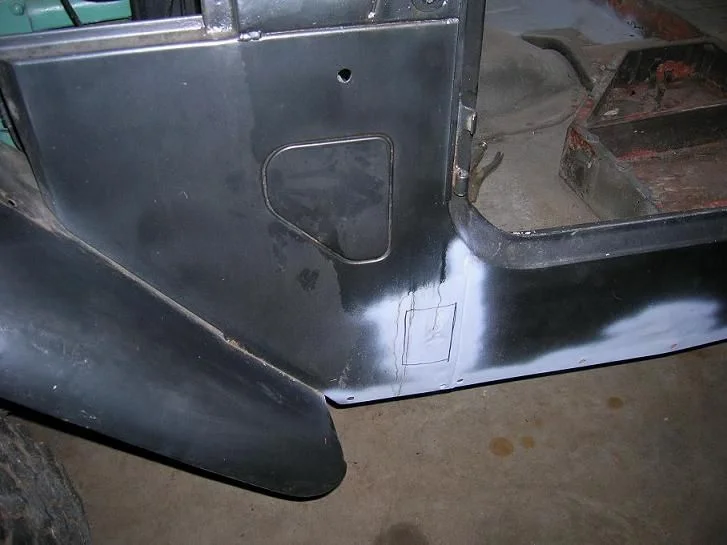

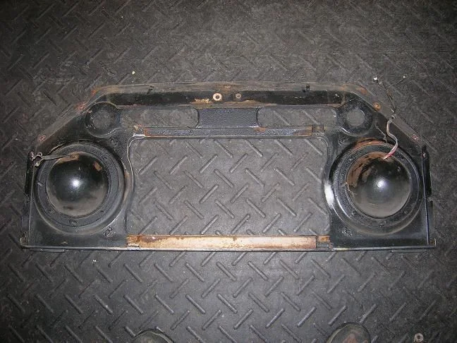

Got time to put in a little more work on the teardown/assessment. Took the rest of the front end apart. Only broke off one bolt removing the pass side fenders. Fenders look like doo doo but the bib seems to be in great shape minus the rattlecan paintjob and some surface rust. Taking a bunch of photos as I go (some to post but most as reference for when it all goes back together.

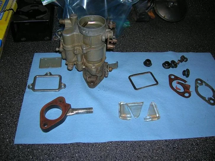

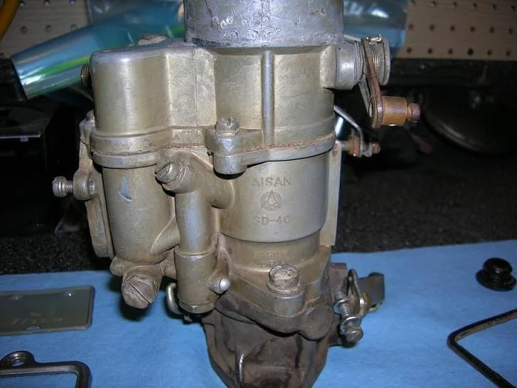

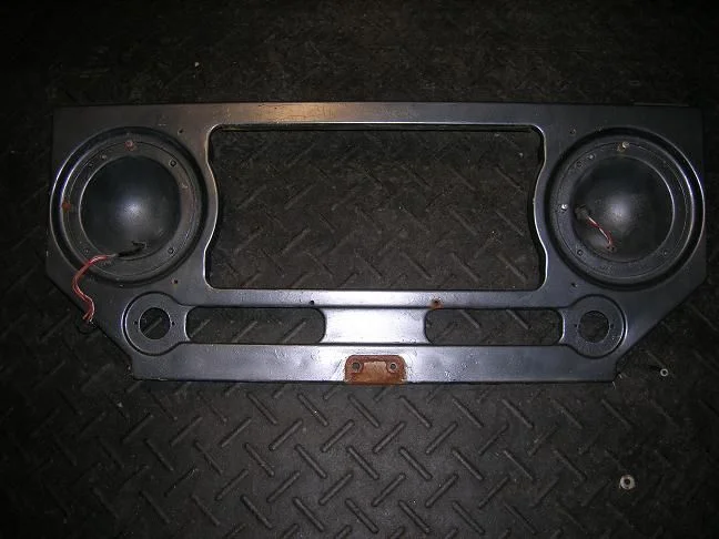

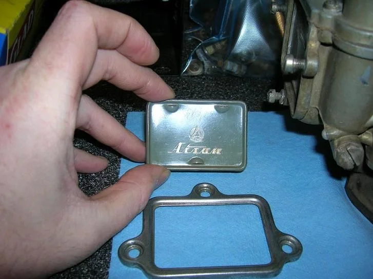

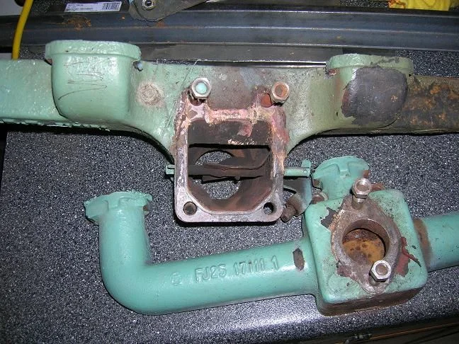

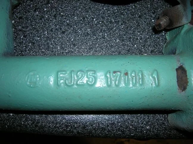

Spending most of my time attempting to get the windshield frame off the cowl. Screws were all stuck. Finally got it off and turn attention to the engine bay. Plan to remove, clean and replace as I go.
Pulled and cleaned the SD-40 carb. need new sight glass as the one on it was broken (PO said it leaked there). Rest of it looks good. I'll see if I can obtain some new gaskets and rebuild the carb.

Valve cover is now black. Going to start working on the rest today.

Started tracking down a bunch of the vehicle's numbers.
Frame VIN: 1-FJ40-10917 early 1962 or late 1961??
Engine Number - F188968 plus the Mt Fuji? logo for the F135.
Also shot a pic of the driver's side block numbers.

Also took some pics of the intake, exhaust manifold and generator markings.
Guess I got leftover FJ25 intake parts.
Exhaust manifold looks like it has an adjustable "flapper" inside. Any idea how that was used or further hooked up.
In case anyone is wondering, even though I am missing some parts, I am going to attempt to bring this back to original as best as possible since it is such an early FST. Any reason why I should not (other than hard to find parts - FJ25 guys seem to pull it off)?

Generator - alternator?

Interesting shade of green under the black on the frame VIN pic. Did early FJ40s have the frame painted the body color like the FJ25? Not sure of what the early paint colors should be since most of the sites I have found with paint codes don't go back to 1962. Of course the data plate on the cowl is missing.

Quote:
Generator
Data Plate didn't say paint codes anyway. Search. Treeroot and others have color palats here somewhere.
__________________
1964 FJ40 | 1966 M416 | 1976 FJ40 | 1985 BJ70 Volvo Power| 1997 FZJ80 | TDI commuter car
Rising Sun
; Former CLCC
You should be able to delete your own thread. Communists abound

Excellent pics! First time I have seen a lot of pics of the engine of an early FJ. Love that top thermo housing and honking huge generator.
Compared to what shape mine was that body is in excellent condition. A local sheet metal shop could make up a passable floor for the drivers side if you want to replace it with new.

Quote:
Originally Posted by wesintl View Post
Generator
Yea, yea, yea Had to throw that one out there. Was not really sure. I had restored early Mustangs where the 64.5-65 had generators vice alternators. Learn something new all the time.
