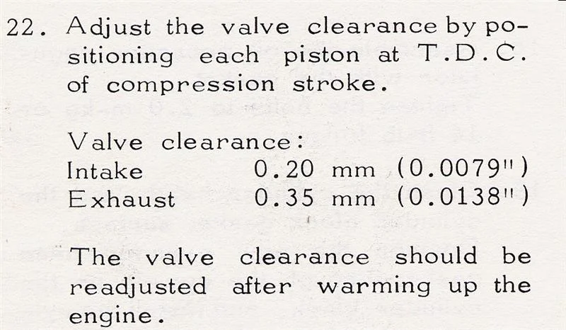

so what are the clearences?
For a cold engine?
PurpleFJ62 is offline   Reply With Quote
Old 02-08-07, 06:50 PM   #54 (permalink)
Forum Lifer
IDave's Avatar
Join Date: Jan 2003
Location: McCall, ID
TLCA# 13705
Posts: 6,678
Quote:
For a cold engine?
The same to start.
From the FSM:

Quote:
Originally Posted by IDave View Post
The same to start.
From the FSM:
Dave I can't quite make out the text - could you repost a larger pic?
__________________
1976 FJ40 - See Build Up Thread Here:
http://forum.ih8mud.com/40-55-series-tech/125665-1976-fj40-build-up-resto-thread.html
1996 LX450

Quote:
Hey, I give to the Helen Keller society...
