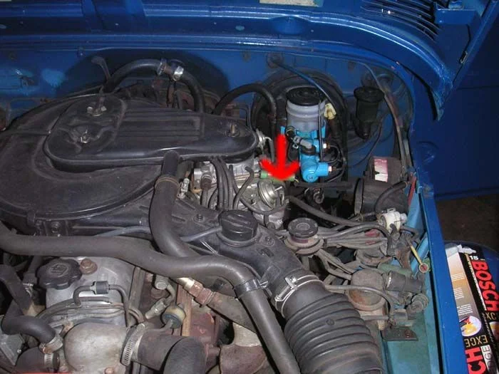

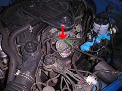

Hey Ya'll, First post here! I'm gonna start out with my most pressing issue at the moment.
Background: 1981 FJ40 that has a problem cutting out at higher RPM's
It has recently been brought to my attention that I am missing a vacuum hose on my carb. I didnt really notice it because that was how it was when I bought it. I always thought that this little nob looked out of place. I am having a problem figuring where it should connect too due to all the smog stuff.
I was hoping that someone with a little more experience and knowledge than me could help identify the other end.
-Matt

That is the A/C idle up if I remember correctly.

As strange as it sounds, the guy that pointed it out to me sucked on it which in turn revved the engine up. Dont know if that helps.

As it should, when the A/C is turned on it opens a VSV and pulls vacuum to that and raises the idle up.

umm only problem with that diagnosis is that I do not have A/C in my rig...

Then A/C was removed or the carb replaced. No matter what one it has nothing to do with a running issue that you have.

I don't know if it is relavent but my fj60 has the same carb setup I think (84). On mine that diaphram vac hose goes to a sloenoid o the side of the washer fluid reservior and then that has a vac hose that goes to side attachment on the large vac line that goes to the brake booster. Hope that makes sense. In other words that vacum comes from the intake manifold connection that goes to the brake booster and has a small L shaped side vac tube on it. Then goes to the mystery solenoid net to the waher fluid reservior then to that diaphram that has no connection to it right now. Good luck. Doug

Thanks DougM, I'm gonna take that direction and see if I can find what you are refering too. If not...then its back to the drawing board.
Is there a resource like a diagram that will show where the hoses should run?

The original diagram under the hood (if still there) or an OEM smog manual (still available and very detailed).
