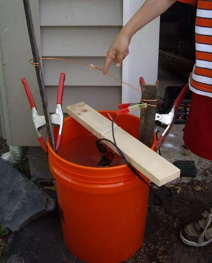

I read this thread in the winter and have been eager to try it out. My son and I had some time yesterday and gathered the parts. Honestly the most difficult thing was finding the laundry wash. We tried three stores, then went home and started phoning around. The sixth store had the product for $2.39
It works really well on a small scale as the pictures show. The bubbles give you immediate feedback that it is working. In the end, my smog pump bracket looks like it came right out of the cast mold. Anyway...I am adding some quick pictures so folks can see one type of set up. It is really easy....and a lot easier to do than setting up a makeshift sandblast cabinet...easier on the ears...clean up...etc.

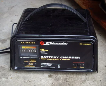

For those trying this without success: Some new electronically controlled chargers will NOT work for this application. The chargers think there is something wrong with the 'battery, IE your part' and will refuse to put out any current. To trick the charger into working hook the charger correctly to a good battery (+ to + - to -). Now connect your part to the battery using jumper cables watching your polarity. + to sacrificial part and - to good part being cleaned. The charger will now see the battery AND the part as a single circuit and try to 'charge' them both. This does reduce the amount of current to the part but it only takes milliamperes to de-rust a part. Too much current and all you are doing is creating excess gas. Like you need any help there!
Read on my site about what the gas can do if you get too curious with a flame near the tank!
