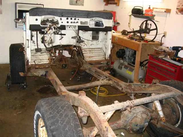

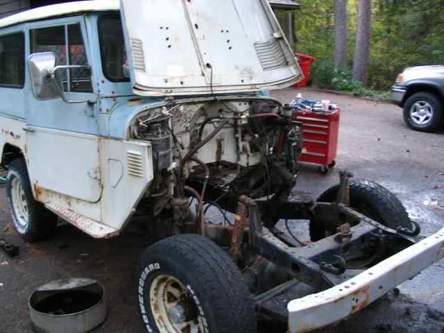

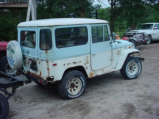

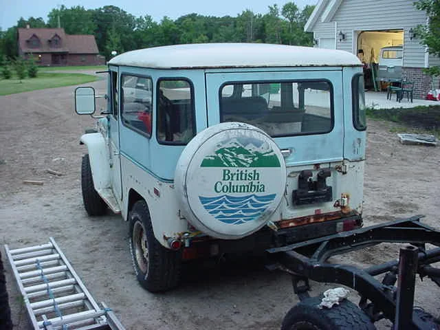

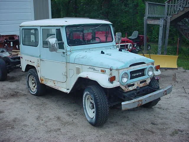

So guess I should start this thread... I have been saying I was going to for a while... I am well on my way to starting to get this thing started but did not want to start my build thread until I was into this thing for a while... I have been taking pictures and keeping a journal of what I have been doing each time I work on my truck... so I will kind of recap that for you guys and bring you up to par...
I bought the 40 from Matt see his link if you have not seen his work it is great! http://forum.ih8mud.com/fj45-owners-club/104821-3-days-3300-miles-later.html
anyhow here are a few more pics of what it looked like when I bought it... I will get the rest of my stuff ready for you and start posting more stuff in the morning...

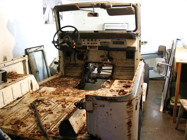

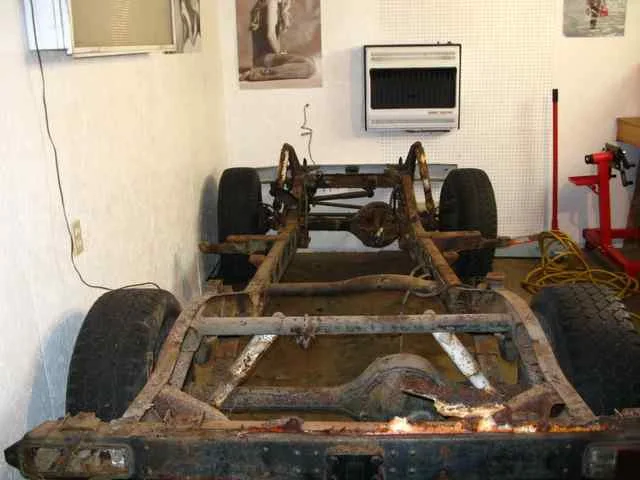

Well have to admit my whole deal with buying this 40 was not to do a frame up… I guess I have wanted one as long as I can remember and I started looking for one about fall 2005. Anyhow all I really wanted was something to go trashing through the woods with.. Now I find myself here… so here is the story on how I got there…
When I bought this 40 Matt told me the PO (who I will refer to as the PO from now on, since Matt really only had this thing for a few days) had told him he had rebuilt the engine and could not get it to get oil to the head… Don’t have any idea why I though I could fix this, but I sure tried. With a few desperate calls to Poser to ask him questions, and a lot of trial and error, fixing the fuel lines, new fuel pump and taking the head off to see if the head gasket was on wrong. I think we came to the conclusion that I would have to tear down the whole engine to see if the cam bearing were put in incorrectly… We discovered that the block had no serial number which Poser said was because it was a replacement blocks from Toyota at one time… so I decided to pull the engine… (keep in mind before I bought this thing every tool I owned was a few hand tools and a cheap ratchet set, so this was about the last thing I wanted to do..) Any how here are a few pics of the engine pull

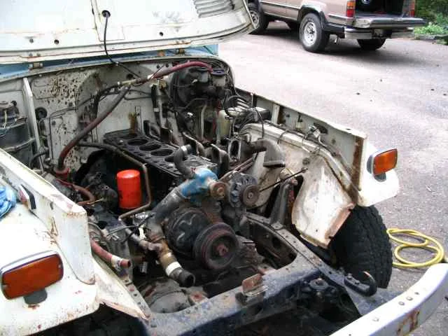

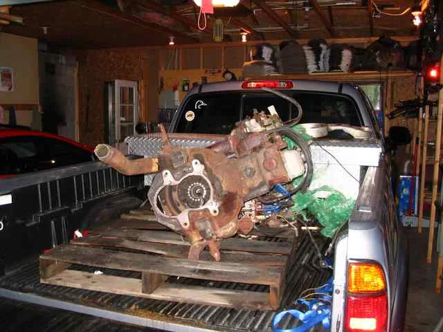

I knew I really did not want to spend the money to rebuild that F engine even though when it did run it seemed to run well, had good compression, but found a cheap 2F engine in the area and bought it and the tranny so I have a spare should I need it. I just kind of fell into this or I would have probably just rebuild the F.

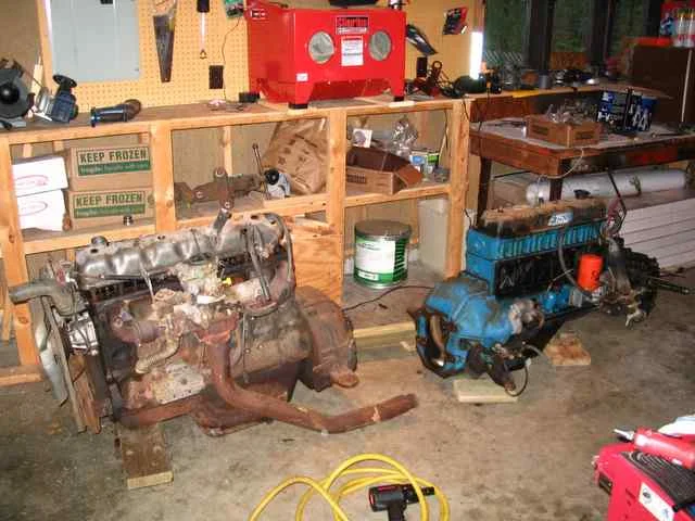

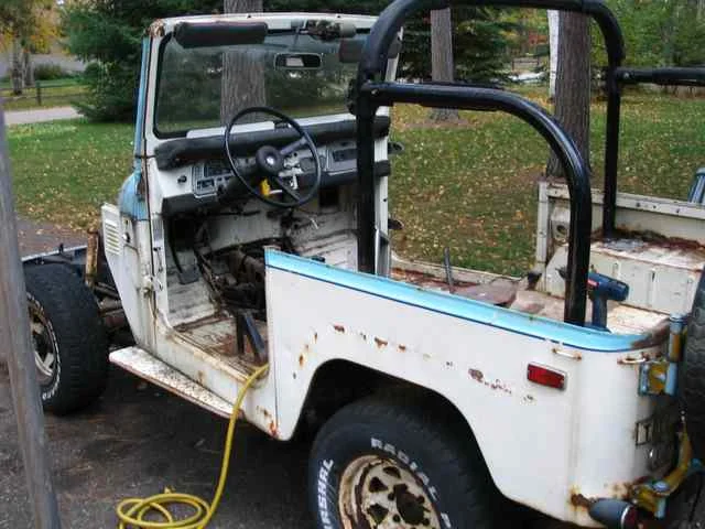

I had rebuilt the carb and everything off the F I plan to rebuild the 2f and use some the the better parts off the F to make a engine (ie, carb, intake, headers) more on that later..
Here is some pics of the taking the top and roll bars off. Guess it came off like everyone else, PITA… lots of broken rusty bolts.

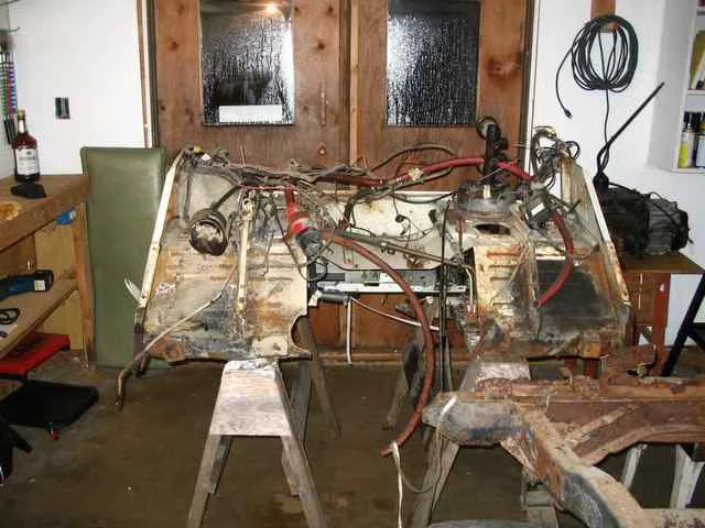

I forgot to take a pic of when I was done doing this so you will have to see when I get to the inside pics with the cruiser inside. it is small small small but I feel fortunate I have a heated dry place to work on this in the winter. It is crowded but you just have to be organized. Painted all the walls put in new lights and some insulation and a suspended ceiling.. Over all I was happy with the finished product. (thanks for the help dad!) ohh and a few girls on the wall!!

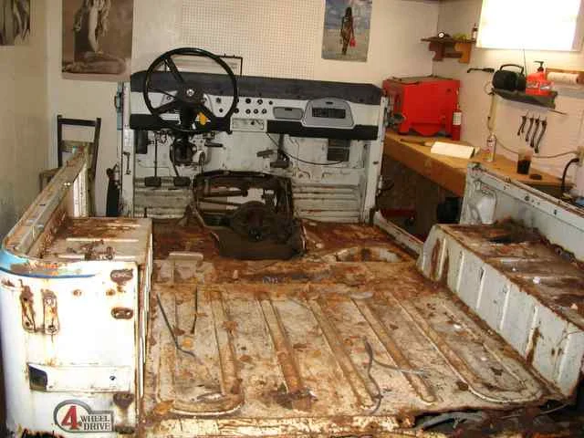

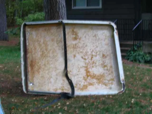

Ok got the 40 in side and started taking off the body.. I want to put an aluminum tub on and since the rear end was pretty shot as far as I was concerned and since Matt did not offer for me to leave it up there for him to fix :-), I started hacking away at it, the cowl is in really good shape so that is good.

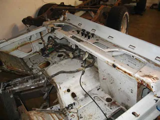

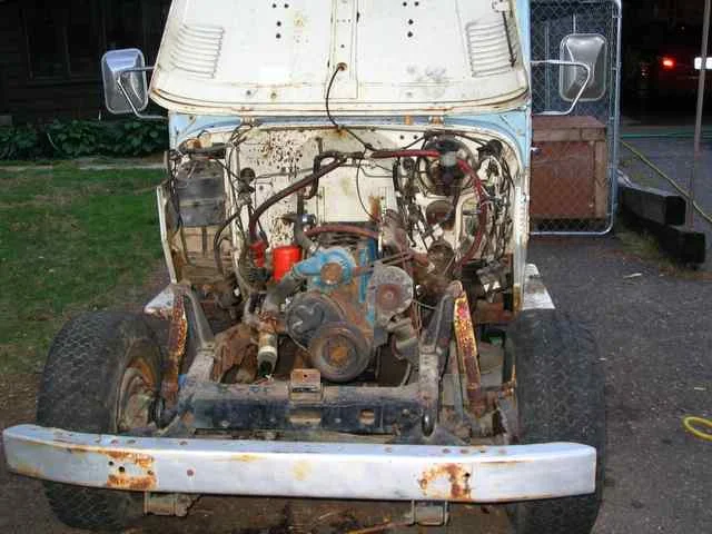

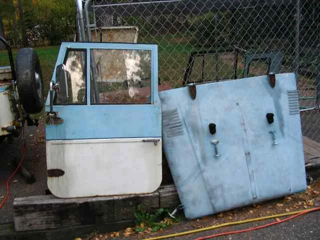

Took the Cowl off and all the wiring and everything else, you know the drill

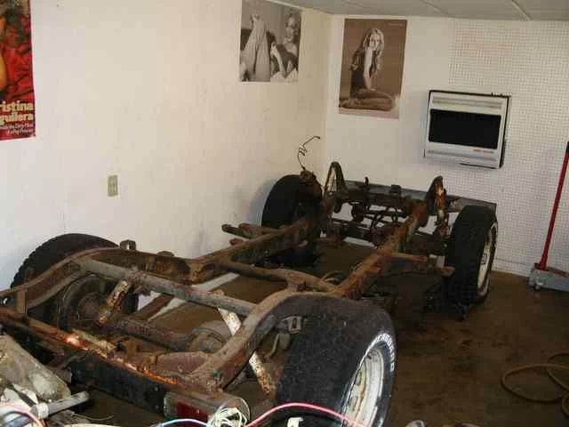

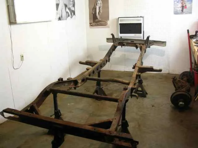

now just had to take apart everything else on the frame to get it ready for sandblasting….

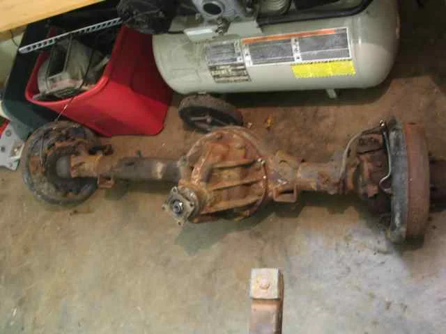

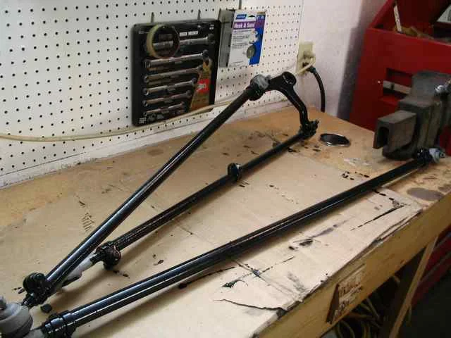

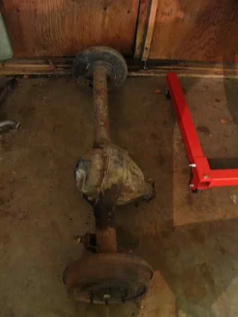

Had a hell of a time getting the old suspension off but with the help of you guys here I used the biggest BFT I could find and won or at least I felt like it.. I plan on getting all new suspension so I was not too concerned about it…. Here are a few pic of the axels before they went to blasting with everything else…

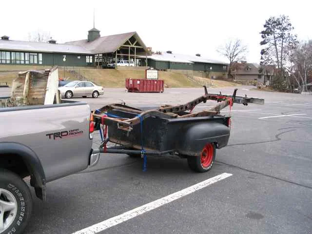

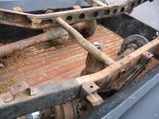

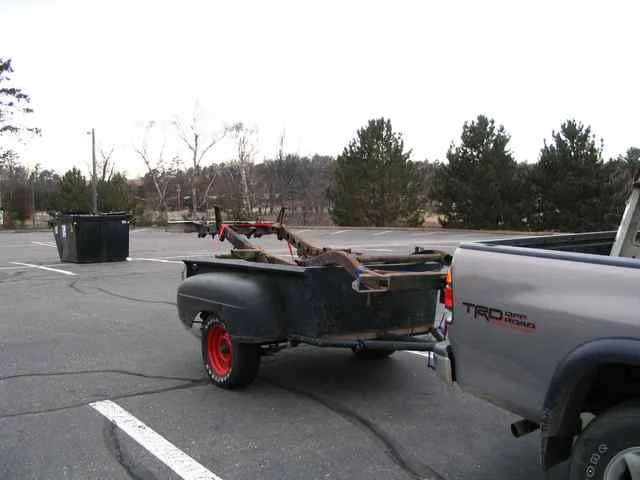

ok well got a sand blaster lined up and borrowed a trailer (a little small but it worked, thanks furball!) had a buddy come over and help me lift everything into the trailer and truck… (man those axels are heavy) took the frame, axels, steering linkage, cowl, header and valve cover.

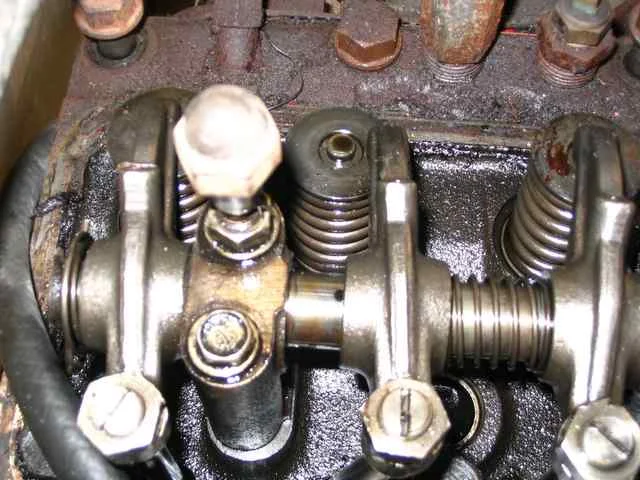

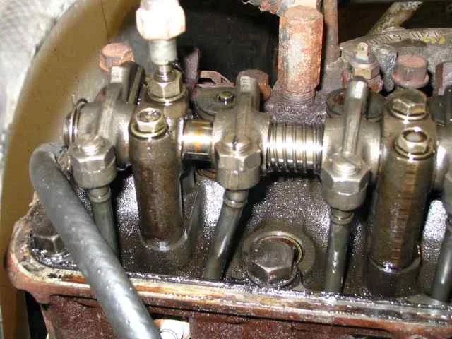

I am embarrassed that this is as far as I investigated this problem seems to be against my “do it yourself” state of mind on this project, but this should help me keep on pace…

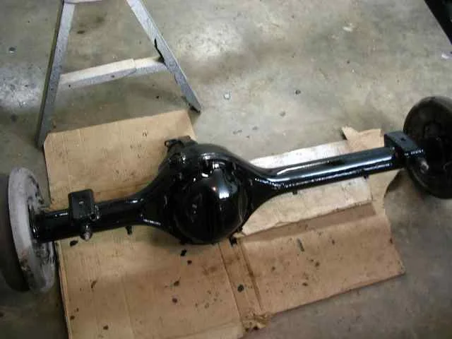

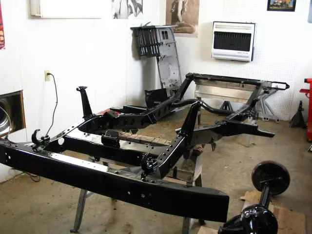

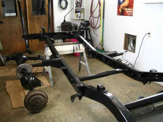

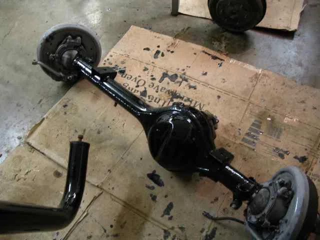

ok back to cruisers!!! Got the frame back on Dec 27th and when and bought some POR 15 got started on that, put two coats on the bottom of the frame, and 2 coats on everything else… had to wait for my dad to come up a day later to help me flip the frame then a day or so after that go the bottom all painted…

Quote:
Originally Posted by Colorado Boy-74-FJ40 View Post
Good luck, I got a November 73 (74) what vintage is yours?
it is a Nov 1974, guess you could say half 74 and half 75... seems to have lots of both in it... 4 speed, 1.5 F engine
__________________
My weekend friends love Top Gun... (Gay yes I know)
http://www.youtube.com/watch?v=xHklGtW3rwU
build thread http://forum.ih8mud.com/40-55-series...r-builder.html
apeterson is offline   Reply With Quote
Old 01-04-07, 10:43 AM   #23
IH8MUD Regular
rjcruiser's Avatar
Join Date: Feb 2006
Location: Covington GA
Posts: 316
Nice work...looks like you bit off all you can chew
As far as the paint goes, a good paint shop should be able to match/blend the colors so that it is impossible to tell. I had a '91 Porsche 944 S2 Conv that I bought after it had been in a pretty decent front-end wreck. I took 8 months finding front-end parts of all different colors and then took it to a shop to have them do the body work/paint work. The car was white, which I don't know if it helped or hurt, but they painted the front of the car and blended the color throughout the doors and didn't touch the rear of the car. The only way you could tell that it was fresh paint was that it was a bit smoother on the hood than on the trunk lid.
Also, if you use the same paint shop, they might be able to hold a can of the same paint for when you bring the tub/top in. Either that or buy a couple of cans up-front when you have them do the cowl. I'd just have them paint the top and the tub at the same time so that they don't have to try and re-paint the two if they don't match.
Sooo.....after writing all of this, I think it can be done. It might cost you more in the long run, but if they do a proper job of blending the paint colors once the doors/top/tub are on, you'll never be able to tell a shade difference between the front fender and the rear tailgate.
Good luck to you and keep up the good work.
