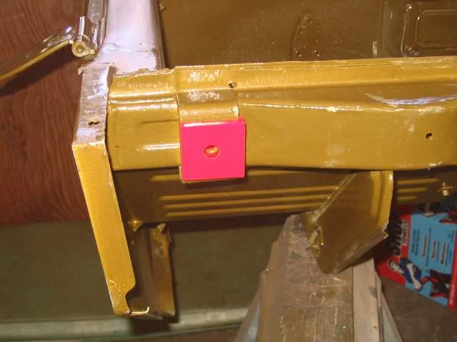

Old 01-29-07, 08:18 AM   #91
The original hater
apeterson's Avatar
Join Date: Jul 2006
Location: Brainerd, Minnesota
TLCA# 16605
Posts: 1,281
more
__________________
My weekend friends love Top Gun... (Gay yes I know)
http://www.youtube.com/watch?v=xHklGtW3rwU
build thread http://forum.ih8mud.com/40-55-series...r-builder.html
apeterson is offline   Reply With Quote

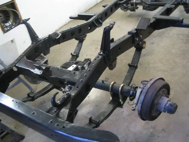

Old 01-29-07, 08:20 AM   #92
The original hater
apeterson's Avatar
Join Date: Jul 2006
TLCA# 16605
Posts: 1,281

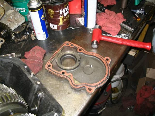

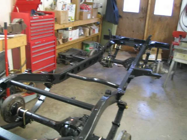

a few more
__________________

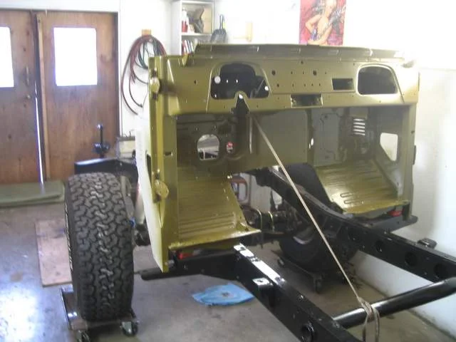

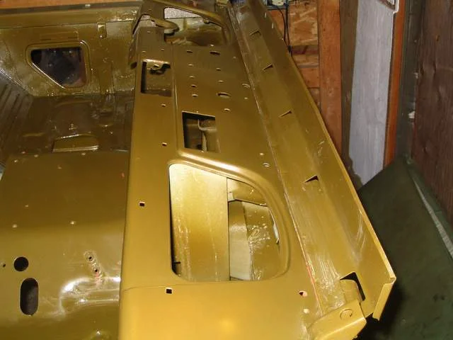

now all that is left it to get it painted up... more of that to come... I know you are all sitting on the edge of your seats!!!

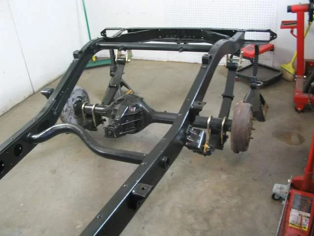

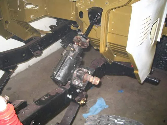

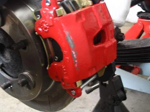

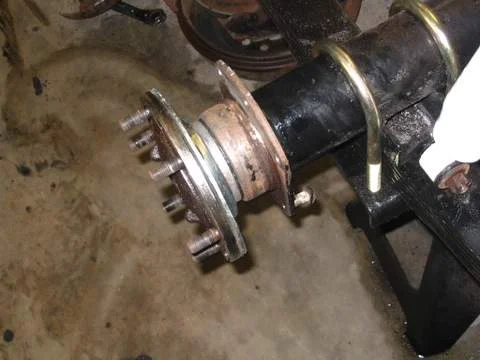

Ok well I felt like $hit when I left the cities... but got a few Power Aids in me and a McDonalds greasy burger and I was back on my feet by the time I got home about 1:30 PM sunday... I went out into the shop and hung my springs and got the axles in place just put everything finger tight for now. It went well!
Had a problem with my house furnace and it was -20 below so I ended up calling the repair guy when my house temp droped to 35 and pretty much ended up messing around with that for the remainder of the night...

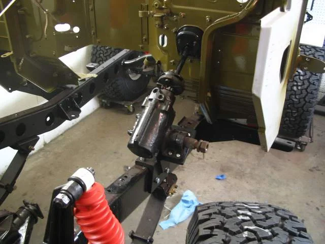

Pics of the springs....

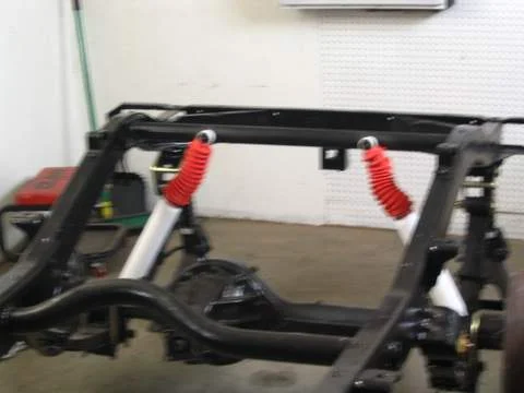

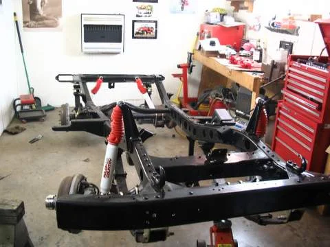

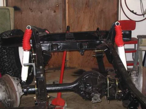

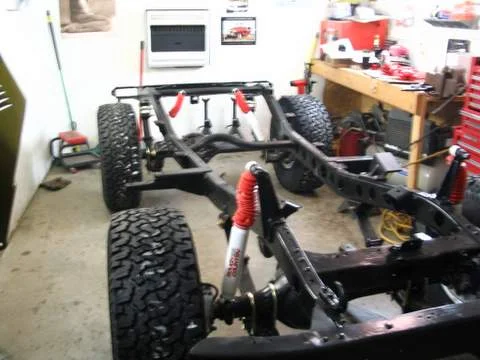

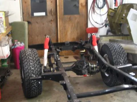

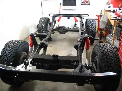

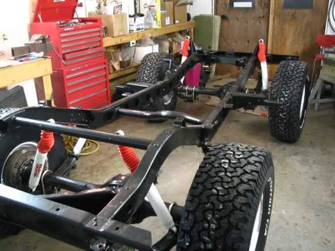

got a ton done tonight... started out by putting the shocks on..... went on pretty much as I thought it would.... not too bad..
check these out

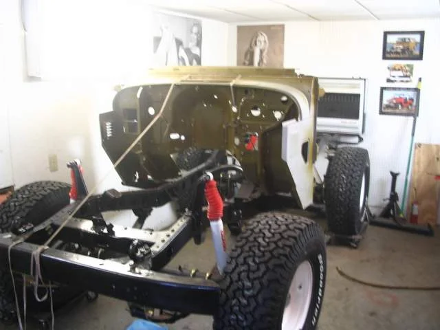

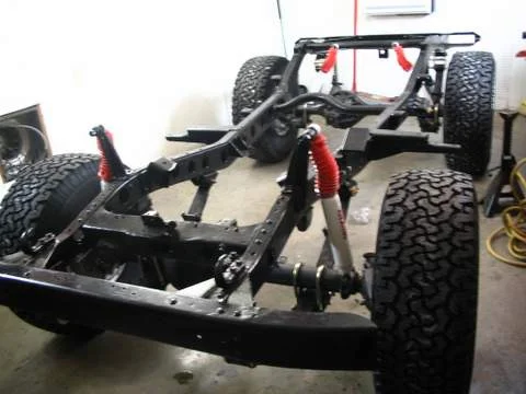

ok... well you have seen my new rims and tires... well I could not wait to get them on and see how they looked... even though I knew I would be taking them off again soon to do the brakes I put my tires on.... man do they look cool.... I am so happy with what they look like... they look so cool... My girl friend finally came into my shop to look at what I have been working on every night.... got to say she was impressed.... (but she called me a grease monkey) I call myself a grease monkey in training!!!
Check these out... but for the record they look way better in person... stop over for a

just a few more... because I am so happy with how they look...

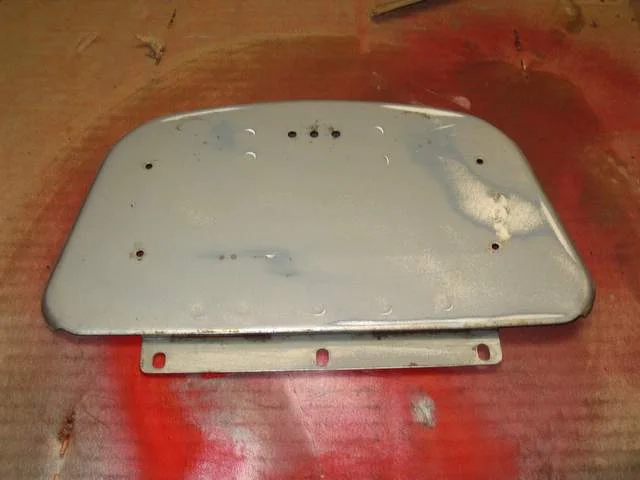

ok... well had a cocktail and hung out with my Gf for a while.... she is leaving for the weekend so we went out to dinner.... after that got a few things ready for my rear brake disc. conversion... I told you I painted my loaded calipers.. I still am not too happy with how they turned out... glad they are just calipers and not something anyone will look at often..

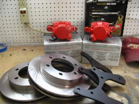

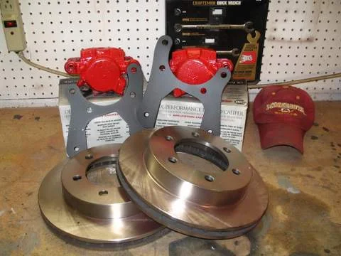

you will see my brackets I got from Poser... I did put a few coats of black paint on them, they come with all the hardware needed to install.. I got my rotors from Poser also... they are the same chevy rotors but the centers have been machined out to allow for the larger Landcruiser axel.. again Poser did this maching work for me also....

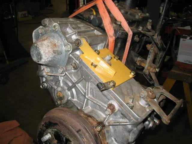

here are the parts... I want to have this mod done soon... pics will come as I do the mod...

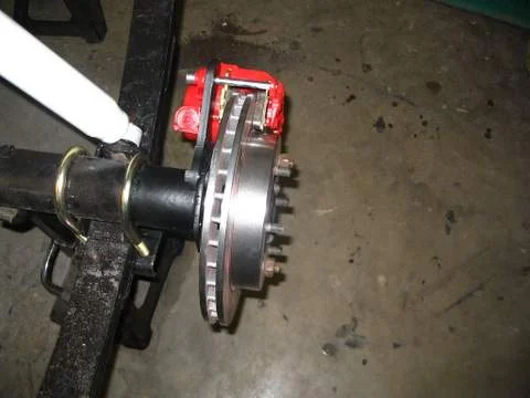

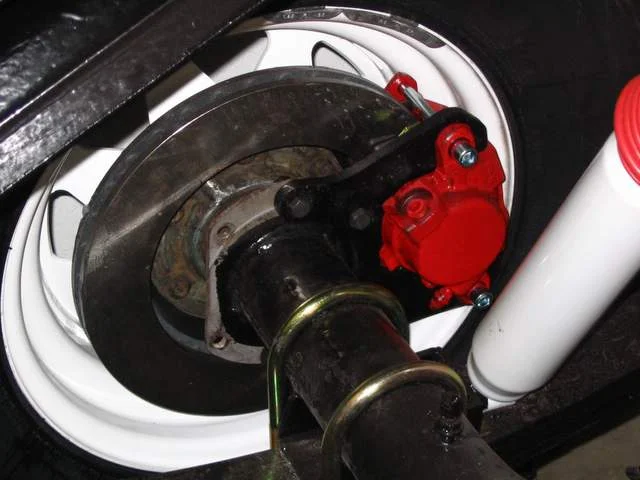

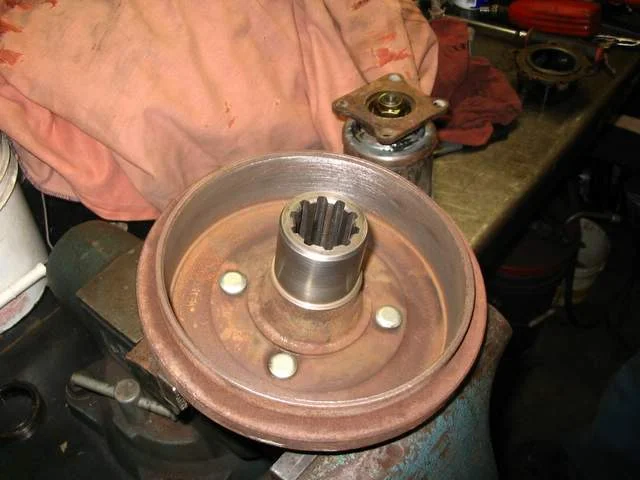

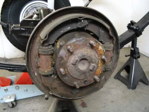

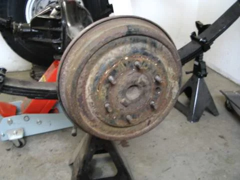

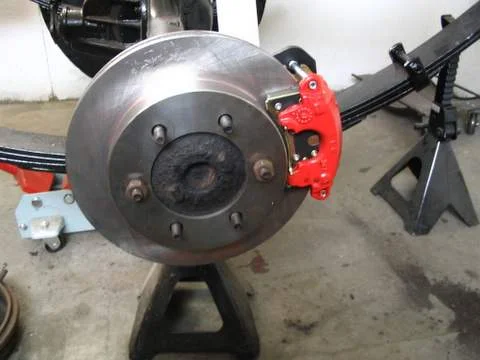

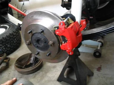

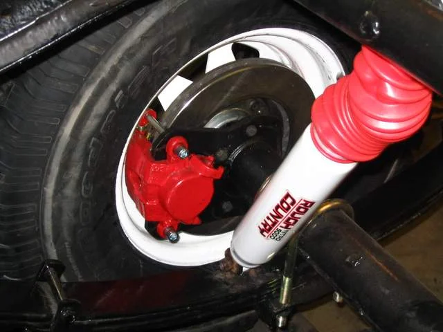

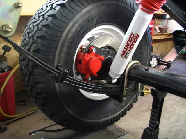

well started doing my rear brakes today... it started out going alright... It was kind of a bitch to take off the rear of the drum... ended up cutting it off with a sawzall.... anyhow got the bracket on there and then put the caliper on.. pretty straight forward... put the wheel on and this is where it started getting shitty... the wheel was hitting the caliper... ended up calling Poser (three times... thanks man!!) well he told me to put washers behind the wheel to try to figure out how much of a spacer I would need with the wheel that I have...... I ordered a wheel with 2.5" back spacing for this reason, so I would not have to deal with this... Poser said he has never seen a wheel that needs more than a 1/4 spacer to work... I am wondering if the wheel I got sent to me is not 2.5" back spacing and it is wrong all together... It is easy to see where the wheel is hitting the caliper because of the red paint...
what does everone think....
ok so I ended my day here at my girl friends house. I am watching her dog again as she is out of town on business and I was putting the pizza box in the ref. and I ended up spilling a pickle jar in her fridge (wonder who did not put the lid on tight, sure it was me, so I am not about to point fingers )...... Man I was pissed... so I have spent the last half and hour cleaning her fridge.... dont know if I got it all... if my posts stop suddenly, you know... some one please call my mom, tell her I loved her... and for god sakes finish this truck!!!!
Here are the pics

TLCA# 16605
Posts: 1,281
few more

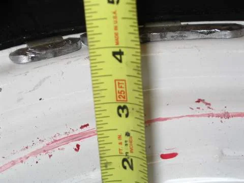

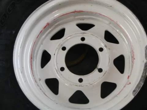

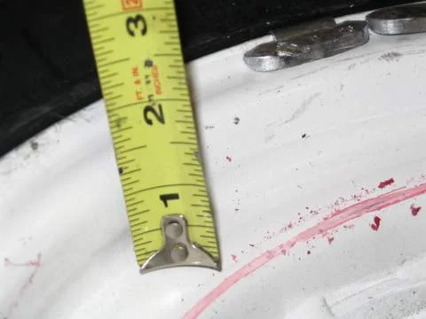

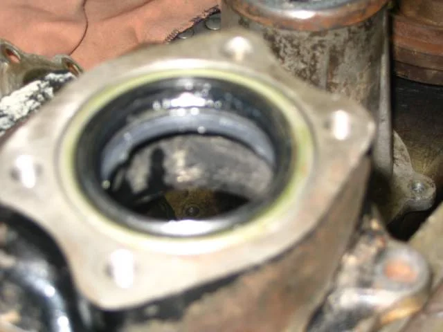

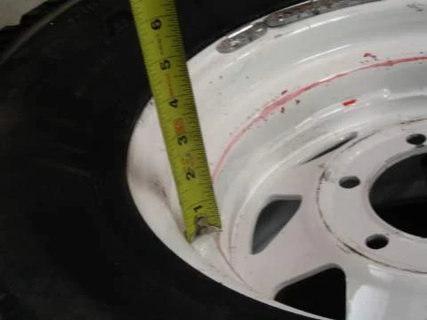

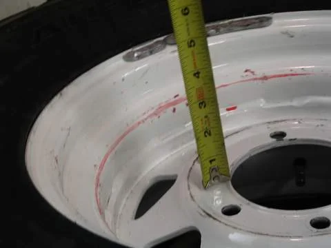

few of the wheel.... Talked again to Poser and he thinks we are going to have to for sure put longer wheel studs on there...

looks like your having the same problems with the rubbing as I had....but I only needed a 1/4 spacer ....
I like the new red pinstriping on those rims! Whered you take it to get that done?
