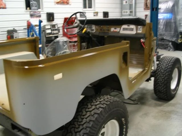

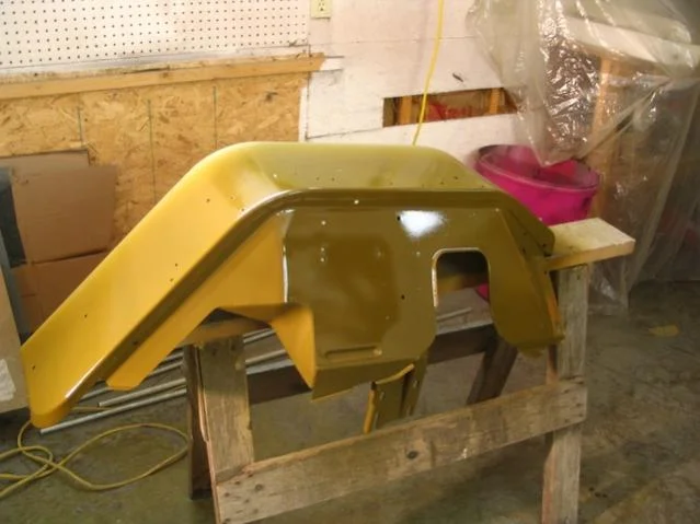

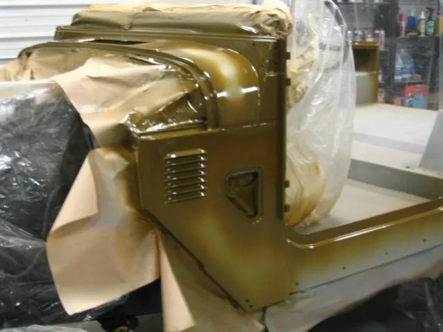

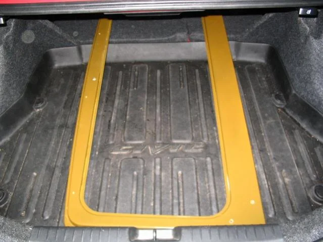

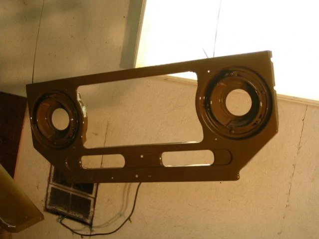

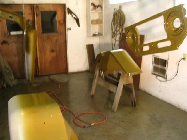

The battle continues as I spend about 4 hours each of the last few night doing more work. Got sand able primer shot on Monday. Got the windshield sanded out on Tuesday, also shot color on Tuesday night. It came out good had one run that I was able to wet sand out with 2000 grit paper… I am brining it to the glass guy today… I am almost sure I am going to put one more coat of green on there… It is just not heavy enough around the top.. but I thought I would bring it in and do it after that… who cares if I got to tape it up. I am sure some damage will get don’t there so I will be able to fix that if it does.
Got the paint booth cleaned out last night also… fenders, hood, side skirts and front clip will all get more sand able primer this evening… then I am going to start cleaning my big shop as it is such a mess I can not stand working in there any more… plus I want to start to get ready for sand able primer on that truck…
Only a few pics as they all seem the same with what I am doing… sanding, painting, sanding, paining… hehe..
Pic 1 the windshield frame in the back of the Honda… I am sorry I forgot to get a pic before I put it in there and I was not about to pull it out just for a pic… more to come when I get it back. BTW it looks like shit in this pic... really... trust me in person it is nicer... stop by for a beer and I will show you!
Pic 2 just the stuff ready for another few coats of primer… I am really happy with how they look now..

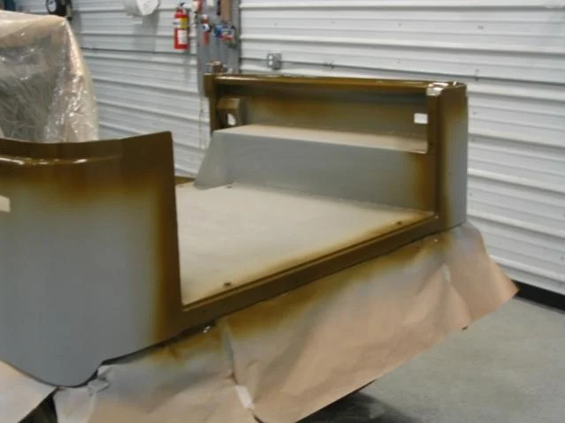

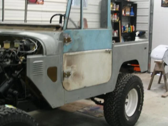

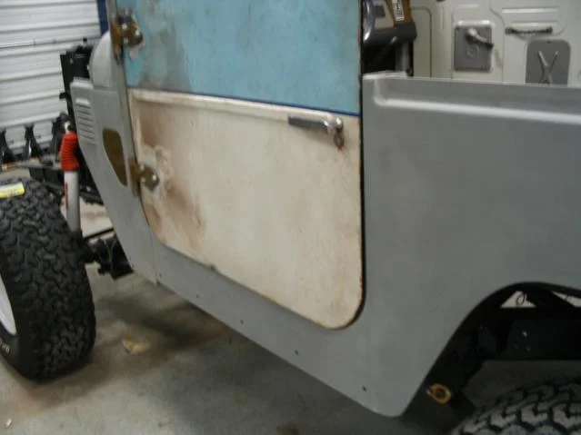

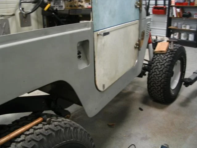

Worked a lot this weekend… work on sanding for 2-3 hours on Friday night…. Shot some more primer Friday night… got up early and sanded for another hour and a half or so on Saturday morning before I went to my grandparents. Had to run to the paint store pick up more supplies and that is all I did on Saturday.
Got a full day in on Sunday about 12-13 hours. All body stuff…. I fitted the doors on… driver side went well.. only took maybe 45 min or so to get it exactly how I wanted it… the passenger side… well………………. That took over 3 hours to get right… it still is not as nice as the driver side…. I would guess it is off by between an 1/8 and 1/16 of and inch… so it is not bad and to tell you the truth don’t think anyone will notice.. fuck them if they do… I am not spending any more time on a 1/16 of and inch on a FJ that the doors will probably be off more than on… I also think the body is out of square by at least that much anyway? I ended up having to grind a little off the body and little off the bottom of the door… but I am fairly happy with how it turned out…
here are a few of the doors

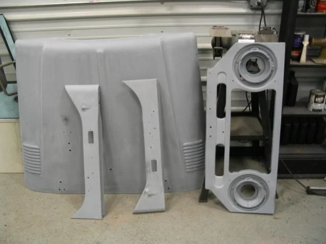

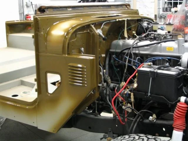

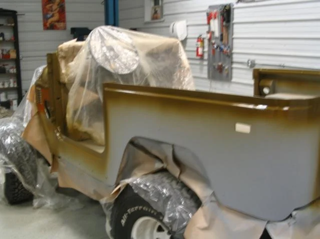

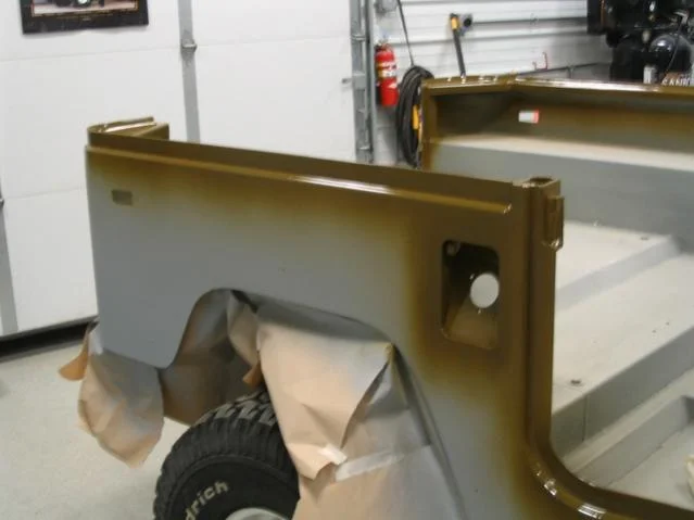

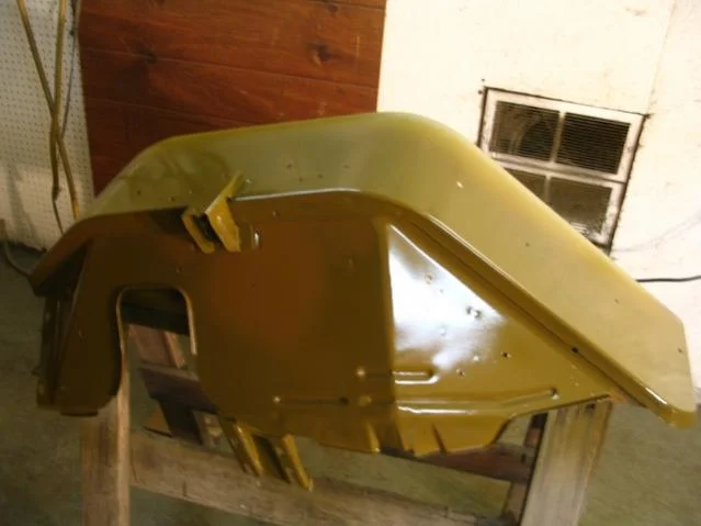

Think I finished getting everything sanded hood, fenders, side curtains, and front clip… so I cleaned them up and threw 4 coats of green on them… then I cleaned the shop up so I can get ready to spray sand able primer on the body and cowl and finish that all up so I can put all that stuff on and get this thing finished up.
That windshield should be done today and if I can pick that up I am going to spray last coat of green on there and be done with that… don’t know how much I can work tonight as I sold my boat lift so I have to help the dude load it on his trailer……

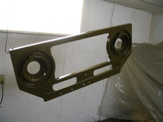

a few runs but nothing that can not be wetsanded out... I did not take pics of that.........

Quote:
Originally Posted by Coolerman View Post
Green? Looks Mustard to me...
Looking good. I'm jealous...

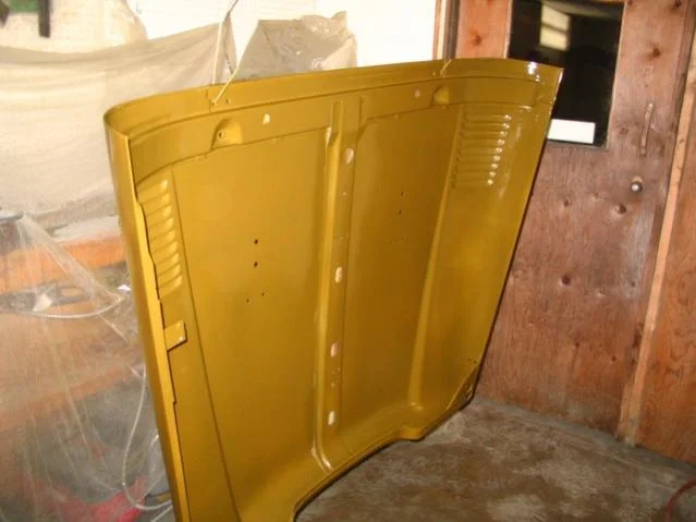

nope it is green............

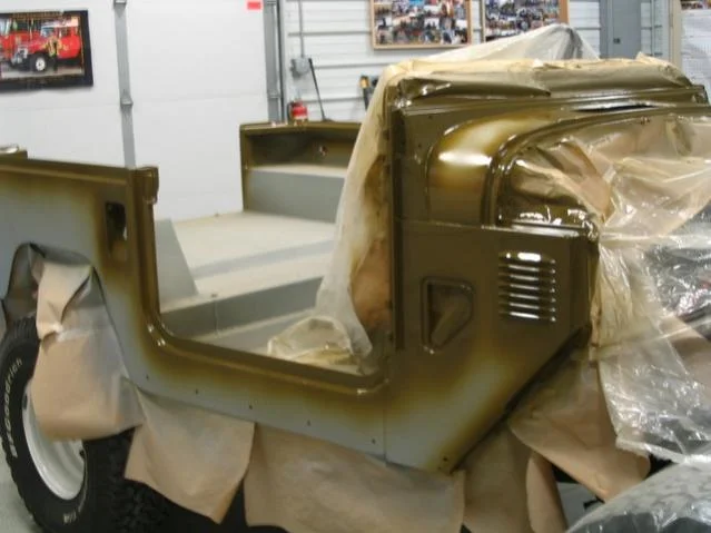

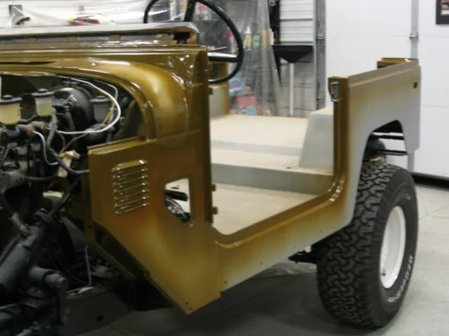

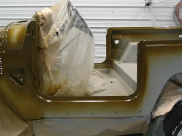

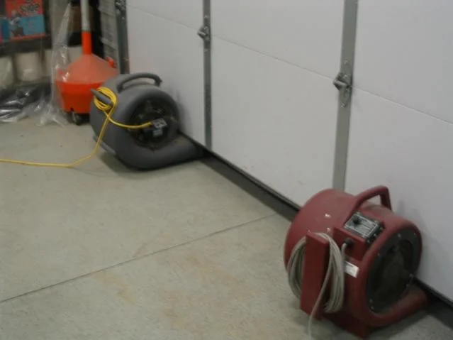

Again got a lot done last night about 5-6 hours of work and drinking …. I had to tape everything off and I sprayed 2- 3 coats of sand able primer. Let that dry and lightly sanded out the edges and what needs to be painted to put things together…. I also tried to hit a lot of areas where I know I would get runs… that way now once I get it all together I will wet sand everything down again before final paint to get rid of all the runs I caused as I knew I would… those “hard to get areas ” will not get wet sanded unless there is a run or something in them… which I don’t think there is…. Just around them… anyway I will be able to just hit those difficult areas with a simple light 3m pad as they will just get hit really light with paint anyway… that way I “figure ” I will have less chances of getting runs on my final paint….. Well since I have never done this before your guess is as good as mine….
Came out good….
Also put up plastic on everything to keep dust and over stray off everything… set up two fans blowing out…. Actually worked really well to clear out shop fairly fast… I was impressed and a little surprised to tell you the truth…

few more

Posts: 1,490
few after all paper and plastic is off...

Posts: 1,490
My fans I am real happy about...
