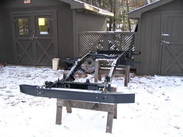

well last night I put 2 coats of POR 15 Chassis Back on the top half of the frame axels, and stearing linkage. Got to get someone to come over this weekend and help me flip the frame over so I can do the bottom... I have to say I really dont like the finished product after the chassis black..... did not dry as nice as the POR 15 not as shinny and in some places did not lay down as smooth..

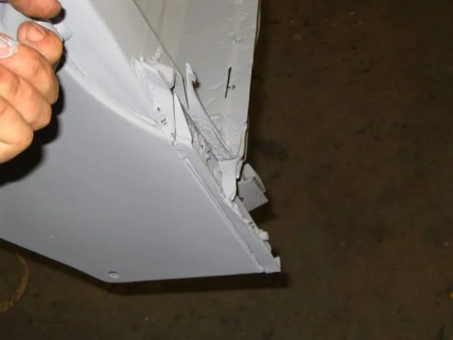

Quote:
I told ya it wasn't as smooth
But it is a good solid layer

Quote:
Yea that is the first thing I thought about this morning when I walked out to see the finished dryed product... I said "huh he was right!"
But I still think this was the right way to go... Just glad this is just a FJ40 and not some slick hot rod or somthing... that I wanted it to look perfect.

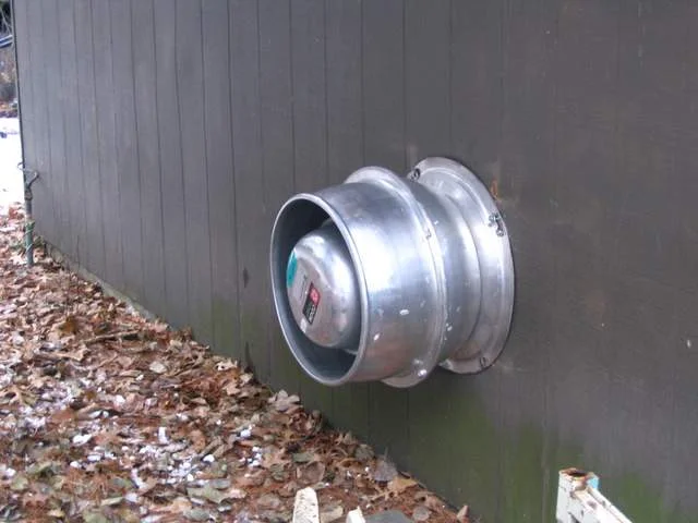

Just wanted to show you all my fan I got from my dad to exchange the air in the shop... it works good.... I got this installed about 2 weeks ago and have been using it every day as I have been painting the frame and cowl as you will see.... (thanks again Dad!)

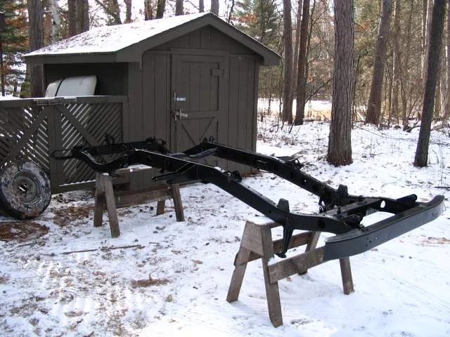

Ok so here is what I did this weekend.... got alot done... I had a buddy come over saturday morning and help me flip the frame, so I was able to get the rest of the Chassis Black put on the bottom... let it sit over night with the heat on high... ( it was cold as $hit here last few days) then my buddy came over at noon sunday and helped me move the frame outside. as I had to move it outside because I have to work on the cowl and I dont have enough space, so it will have to sit out there until I get the cowl to the body shop.

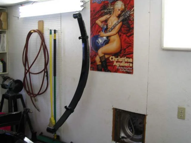

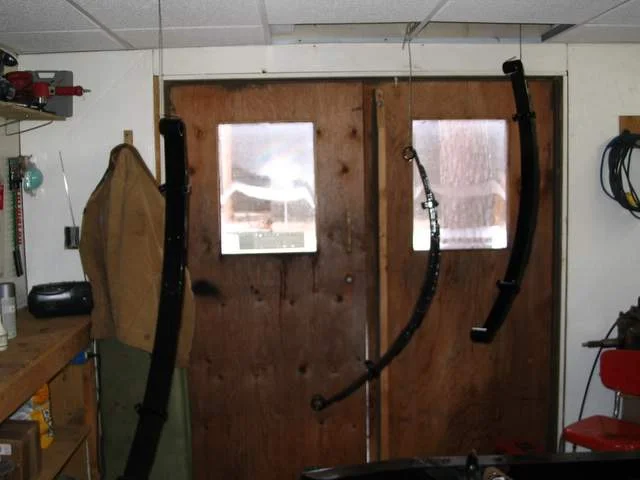

I also wanted to show you guys that I did put a coat of POR 15 on the springs and covered that in Chassis Black (did that on friday night, then CB on sat when I did the rest of the frame)... The springs do have the plastic pieces inbetween each spring... I did not take them apart and do each seperatly... I hope I am not dispointed I did not do that... I dont thing I will be.. well at least it will be better than if I did not do anything at all....
PS yea I hung that spring so you guys could get a good look at my Christina poster!

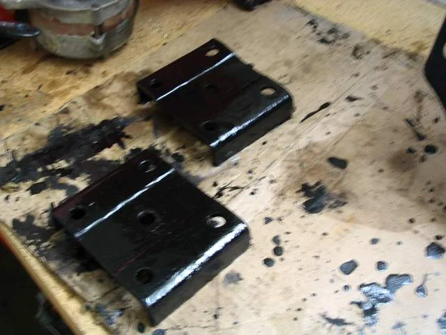

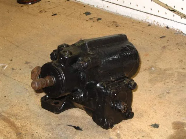

also threw a few coats on some other suspention parts and the mini steering box I got from Poser....

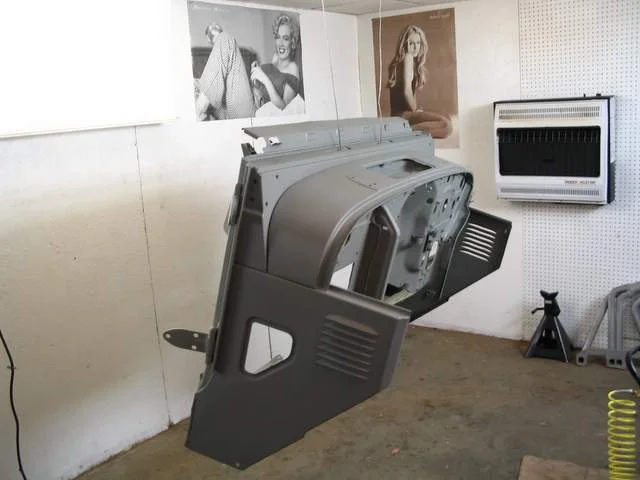

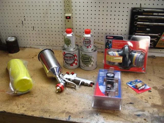

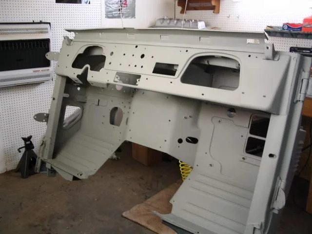

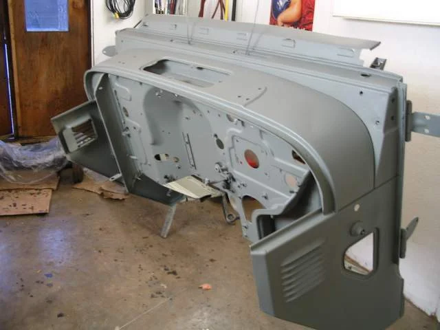

Now since the frame was outside I was able to start working on the cowl.. I want to get this thing all primed up and ready for paint... I have to bring it to the body shop to get paint on the engine bay and the dash and inside so when I get my engine back I can get it all installed and just have the ouside of this left to paint.. There are a few dents that need to be fixed. One one the outside and one ont the inside on the dash...
I have never never painted anything using a gun and real paint... so I have to admit I was very meak and moved very slowly because I did not know how it would go... yea I was shaking in my boots...
A pic of my new gun and supplys before I got started..

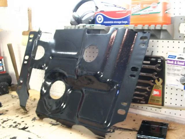

So mixed up the Exp. Primer and put a few coats on.... I was very surprised now easy it went on and how niced it looked when I was done... I have to say I was very pleased....

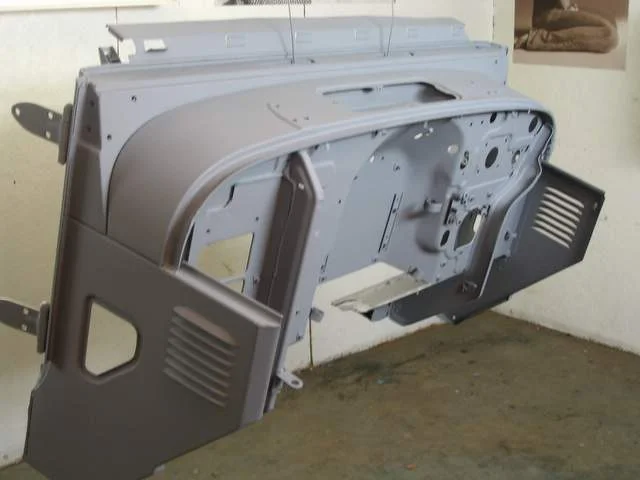

next out about 3 coats of sandable primer ( I am sure it has a different name) on... it went on about as good as the other... I did get one small run when I was trying to get in a corner... nothing I can not fix when I am doing the minor body work I mentioned before...

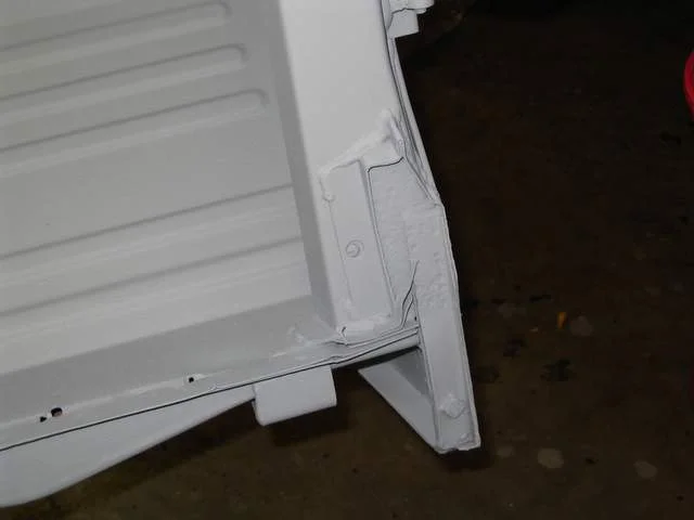

ok so here are my questions.... I guess from the alum tub video that I have to grind these joints down to the weld and it should fit up to the cowl tight or with just a small amount of body work or seam sealer... any one know for sure?

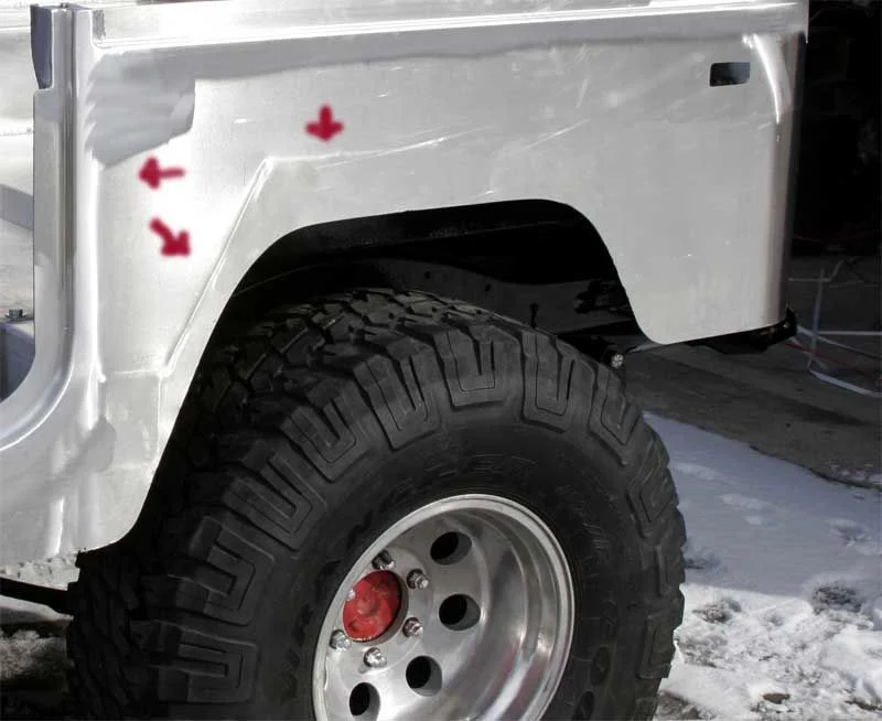

My only other question now is, I know that one of these holes is where the antenna goes... what is the other hole for... does the antenna need two holes or is the other one for something else???

Hey looks good- Yea you have to grind down through thoe welds.. essentially you want it so that you can run your finger down the door jamb and not have it bump over stuff. Be carefull when grinding to not grind too much of the very outer area, beccause it has the welds that hold the side panel on. (once you start grinding and look at it youl probably see what I mean. Also, you might want to grind it down and then primer it like you did to the rest of the cowl..since the front is steel, you dont want to grind it down and leave it bare.

Hey... I am not doing the paint myself... I am having a guy that I know shoot the paint only... I guess I am going for the in between look... I would love to get show qualitly but I dont think that is what I want in the long run as I do want to use this thing and not worry too much...
I have not seen the inside welds do you have pics to show me.... how was the outside lines? is there body work to be done there? I have only really seen the pics you posted on your build and a few others that other people have posted..
Thanks again for your help!

yea its on the outside...from the fender well welds on the inside...very noticeable and raised ...I tried to put the arrows where the main wleds are...hope this helps

yea I see those.... no I did not know they were that bad... what did you do with yours... I am about the worlds worst body guy but I try my best and I have done worst than that... so guess I will be doing it myself... maybe??
