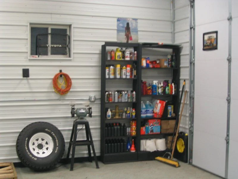

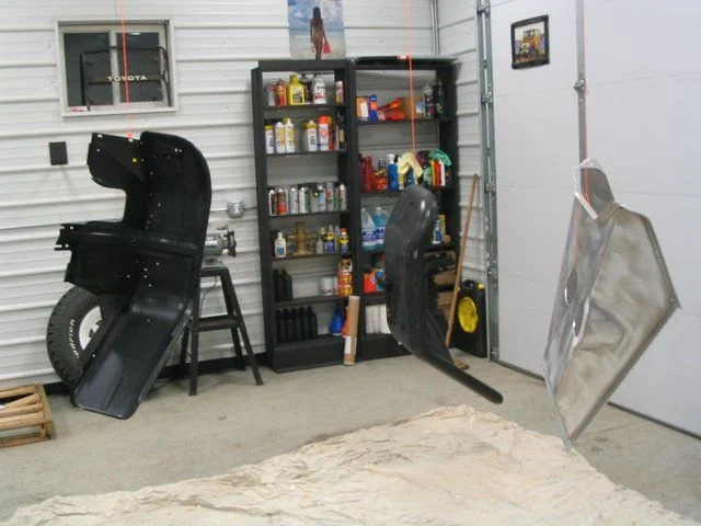

got some more stuff moved in the shop...

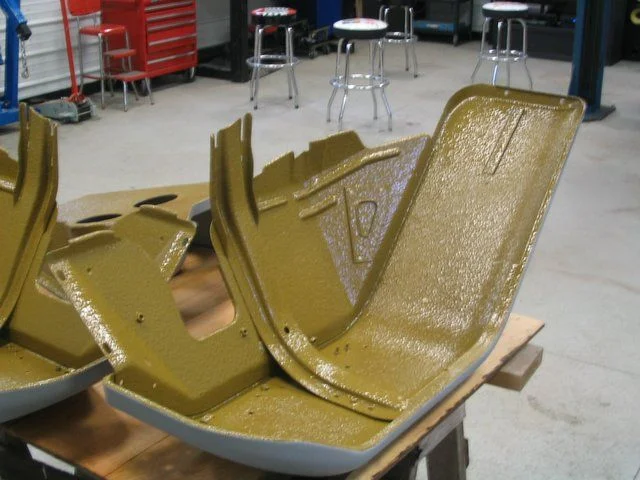

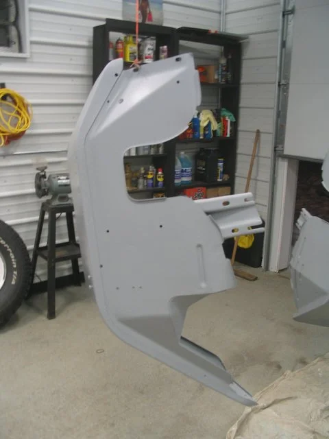

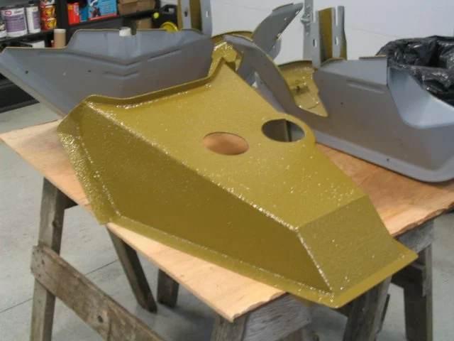

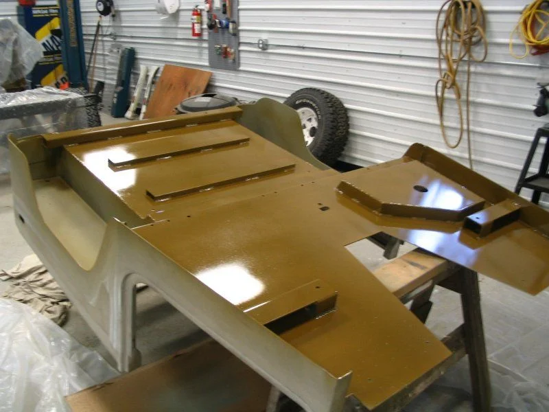

Well I guess not a ton done last week… but I am moving in the right direction.. I got my SEM on Friday. I had to go to the body shop/paint store to get a pint of color (mixed without the binder, I suggest bringing your SEM can with you as they really look at you funny when you tell them to leave out the binder )
Last week I got my fenders out and sanded all the stickers off and also scuffed everything up.. same with the tranny hump. I hung them from the ceiling and shot 3 coats of etching primer on them.. I was hoping this SEM would come before the weekend so I wanted to be ready when it did..

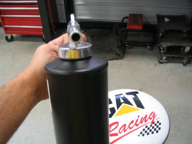

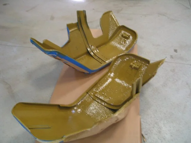

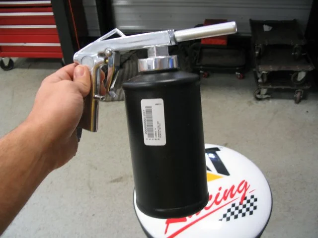

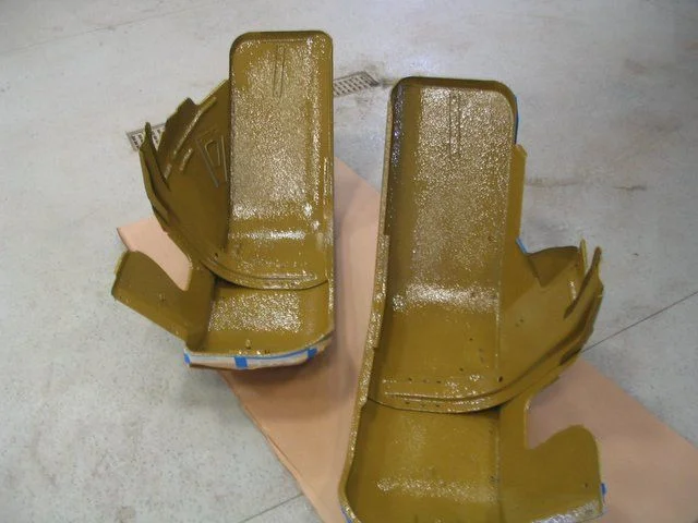

SEM cans (Matt I see you have become so popular with the SEM boys that the cans are now coming from the factory dented )
Also a few pics of the gun I used… just a under coating gun. I just took Matts advise and used that ˝” tip, I did not even try the others… It seems to shoot really well…

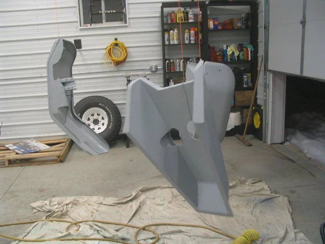

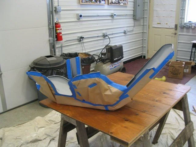

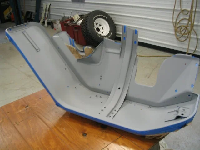

a few prep shots... took a while to tape these things up... all I did was scuff the primer lightly with 3M scuff pad.. probably would not have needed to..

Posts: 1,490

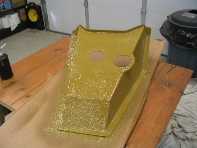

I was very very happy to say the least of how they turned out....

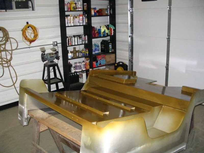

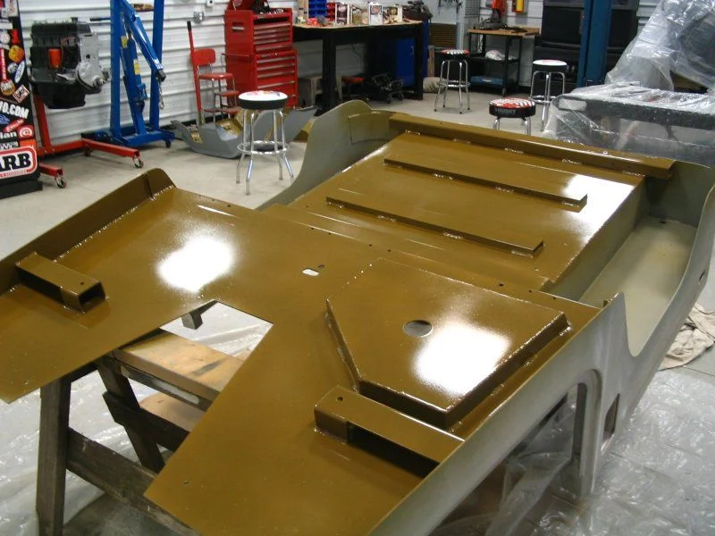

scuffed the bottom of the tub and shot primer, then shot green last night... I have to say I am not happy at all with how it turned out... I knew it would not be completly smooth because I did not sand the primer at all.. and that is fine, it is the bottom of the tub... but what I am not happy about is there are some bubbles (very small) that were in the from part of the tub?? what causes them? too much gun pressure??? dust?? I was carful to wipe this all down before but I did not wipe it down between coats or between the primer and paint?? should I have??? please post up your thoughts??? I need way more practice painting... this will never fly on the body!!!
Still have to shoot the SEM on the wheel wells... probably give it a few days to dry before I try to mask off anything with tape.. no sense fucking up my shitty paint job more..

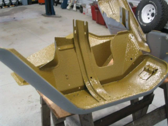

here are a few of the bubbles...

I'm way out on a limb here, but could it be outgassing of your primer? How long did you wait before shooting color after primer?
20-30 min... Which I think the can said 15-20 min, I would have to check again… it was dry to the touch. My only reason for not thinking this is the bubbles happened immediately, not after sitting for a while… after a while some of them did pop..
