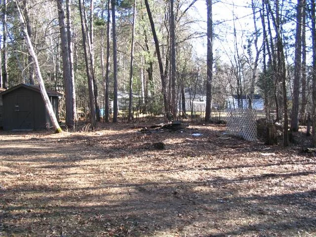

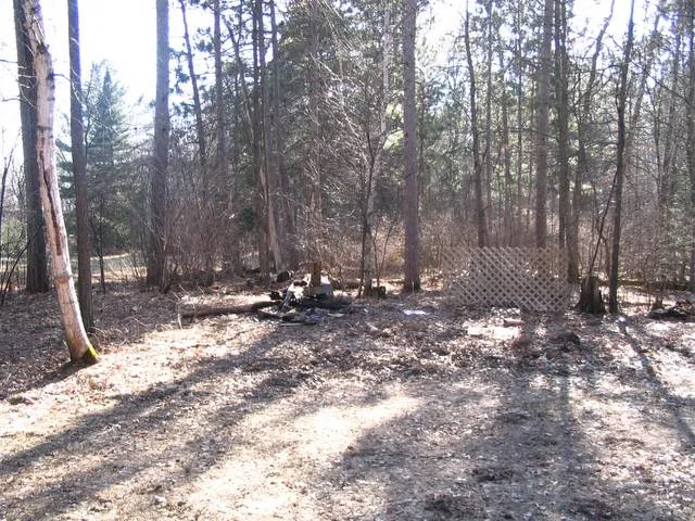

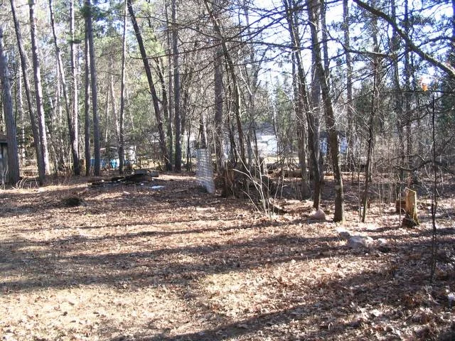

well road restrictions went off yesterday, so we poured concrete as planned... here a some pics of everything as it happend... pics pretty much say it all... going to start pounding nails soon!!!
Thanks to everyone who showed up to help!!!
first three are before we started...

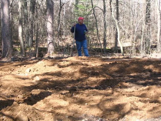

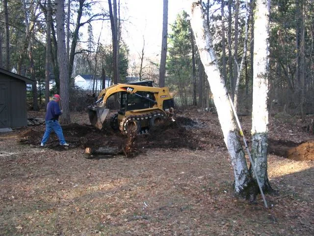

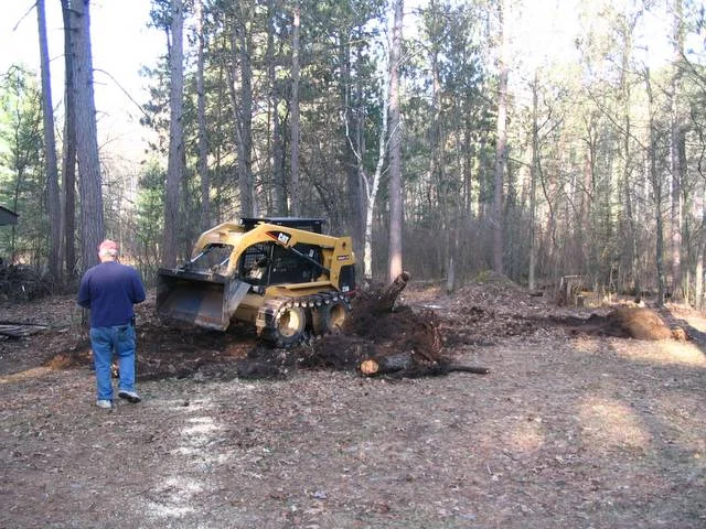

next pics are of when the bobcat was there and after the loads of fill where brought in...
hahhaha!!!! somehow my dad thinks if he holds a shovel while he is drinking beer it is still called working

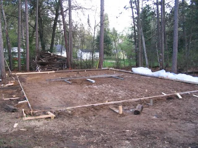

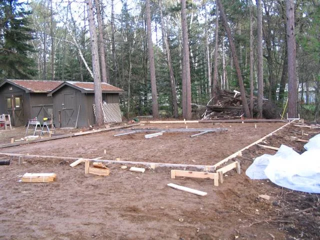

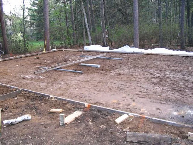

now a few of the forms before concrete... this actually took us a while... had to make sure it was square and everything was at the correct depth. It was really not much fun and and I am glad it is done... Plus it rained a few days in there so it was solid mud... even though we tried to cover it... notice the footings for the lift!!!

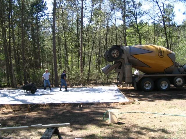

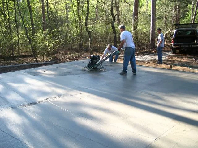

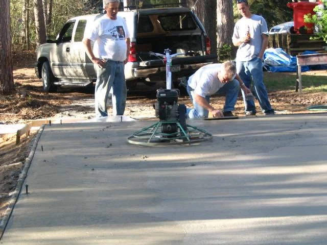

now some of the happenings yesterday at my house... Tons of firends showed up to help.. Have a beer or just see what was going on.. It was a good time..

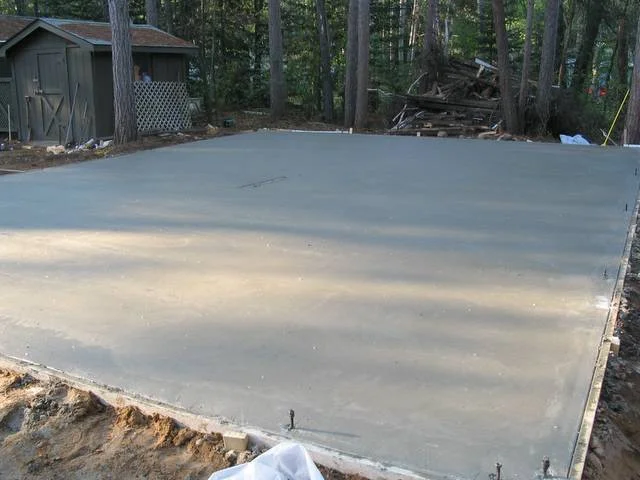

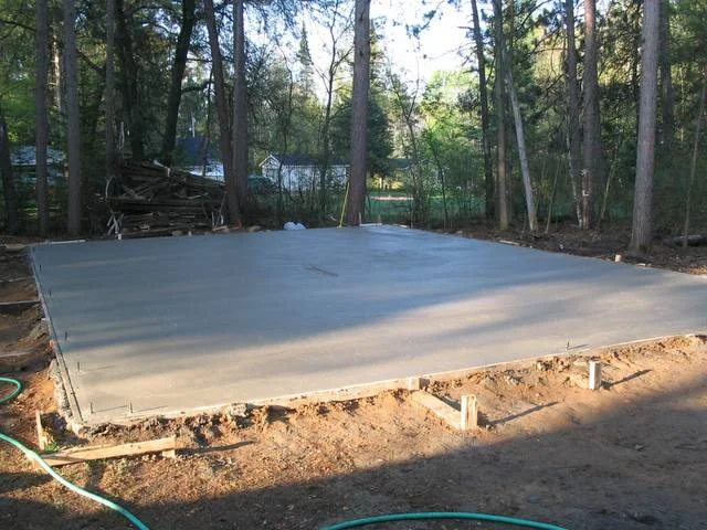

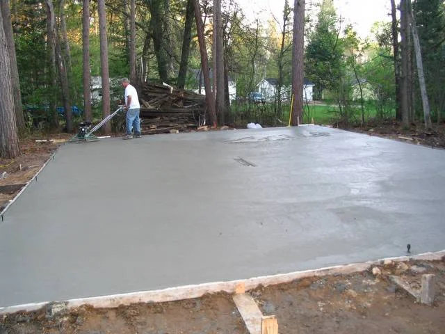

What it looks like this morning... Turned out great... Had to stay on it until about 10:30 PM or so.... took that long in the rear corner before we could get it to set up enough to finish it...

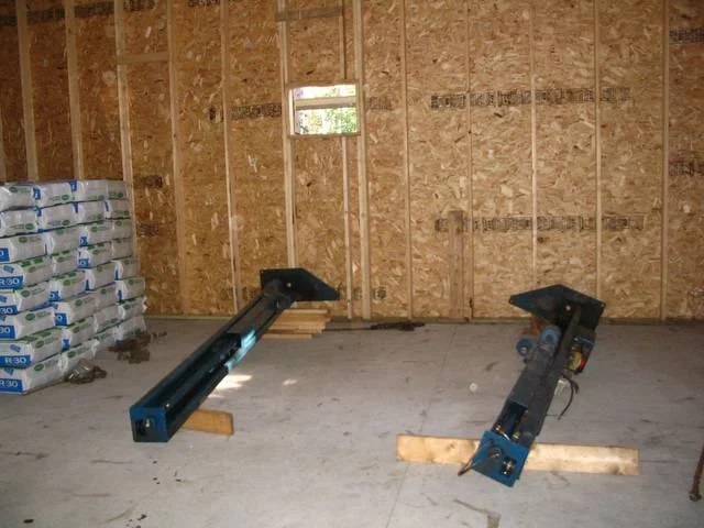

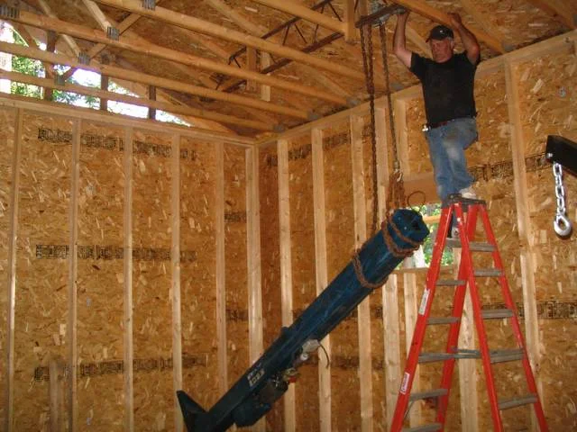

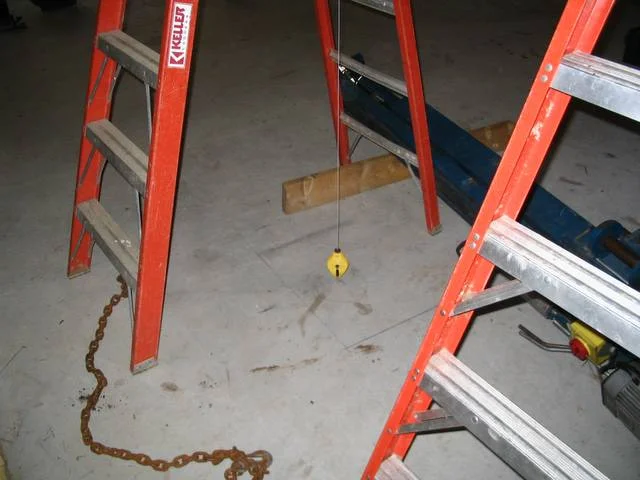

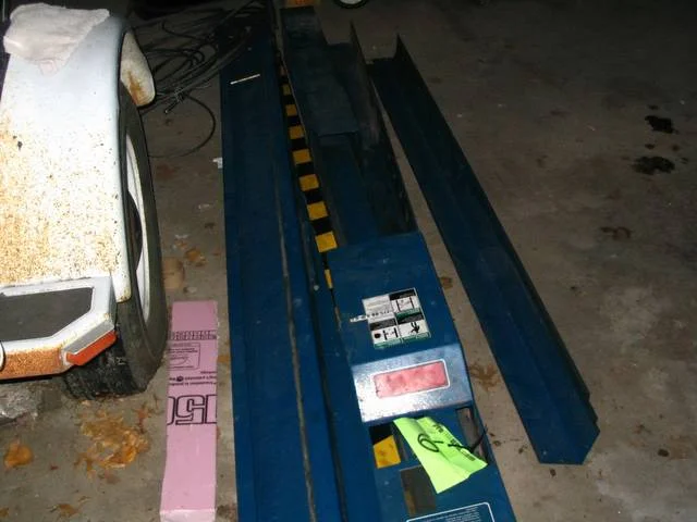

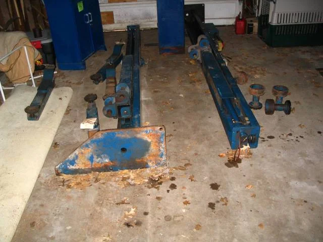

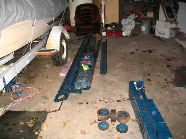

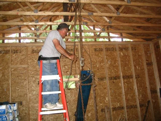

Picked up my new Lift yesterday Nussbaum SPL 8000... I just downloaded the manual online so going to get to reading that soon.. Anyone ever heard of them? Made in Germany...
I have to say it is really really really FUCKING heavy... we had 5 guys and could've used 5 more... dont know how I am going to get this thing stood up and in my building... Currently it is stored in a friends garage until I get walls and a roof....
Pics as always...

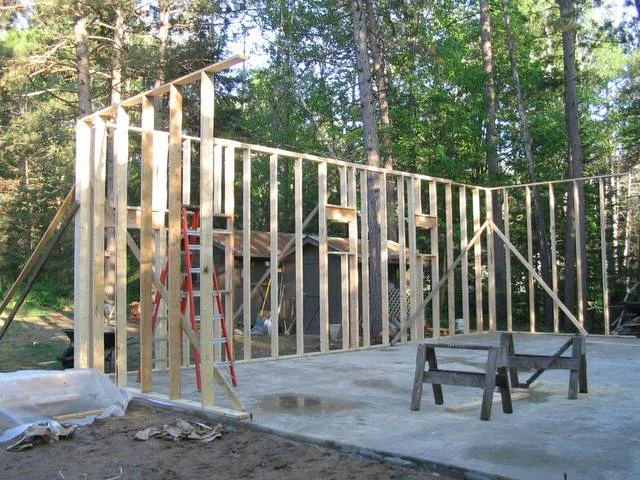

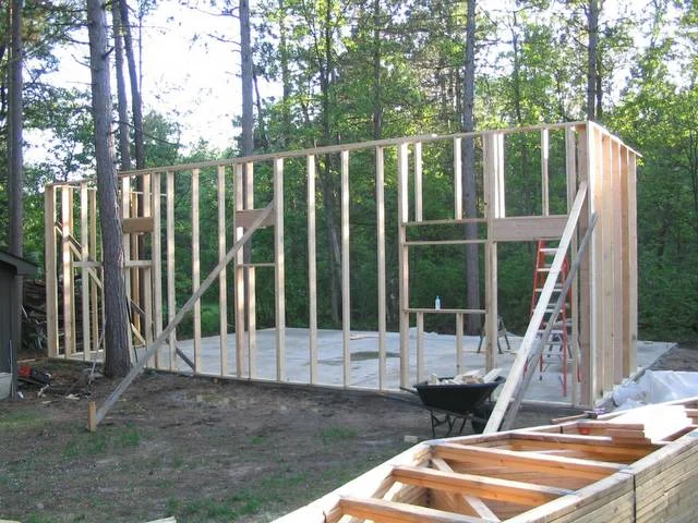

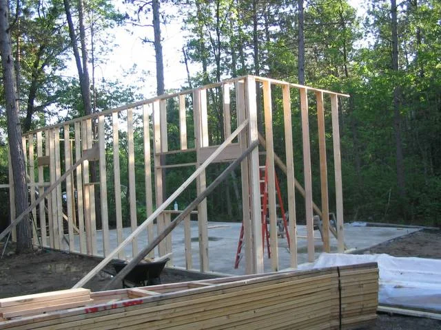

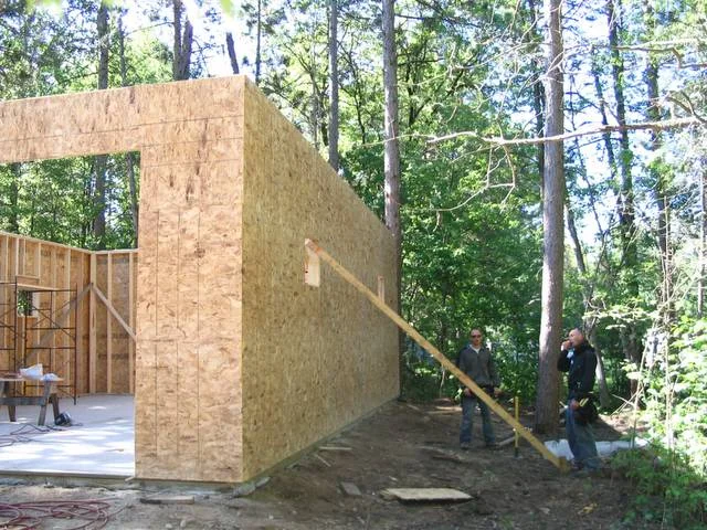

Got about half the walls up yesterday... We have been working around the rain here for the last week.. so seems we dont get much time to get anything done.. also rented a saw to cut relief cuts in the concrete on Tue.
My dad did not have to work yesterday so he was able to build most of the walls while I was at work... It was a huge help.. I also wanted to point out that we snapped our lines we were with in 1/8" on square our first try !!! so needless to say we did not bother moving our lines for 1/16 of and inch.
Ted stopped up yesterday to show me his new Volkswagen Cabriolet.... I know what you are all thinking and no Ted is not a chick... soooo... Guess that really only leaves one other question... hummm... If I dont ask maybe he will not tell me...
anyway... Here are a few pics... Proabably no more until there is a roof on this thing... going to be working everyday, as long as the rain holds out!

good idea for the elevator

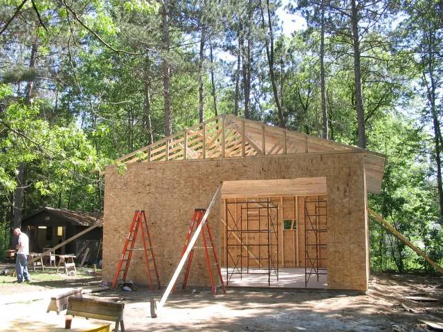

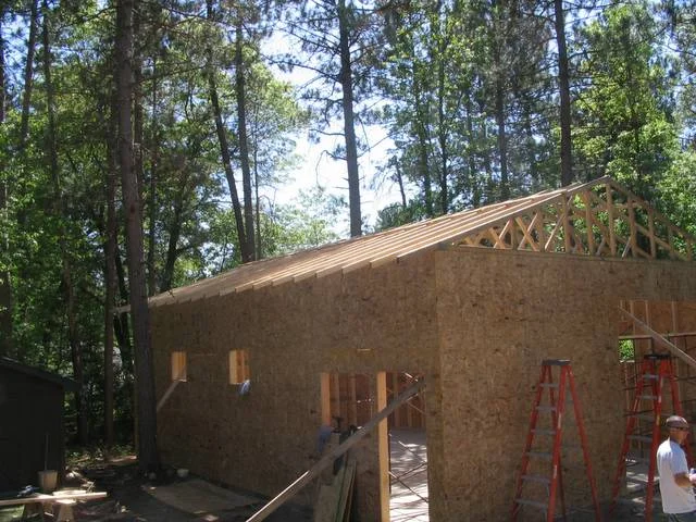

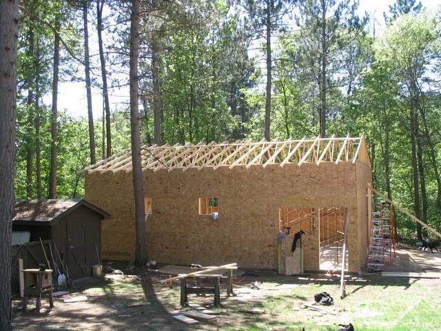

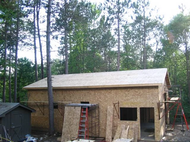

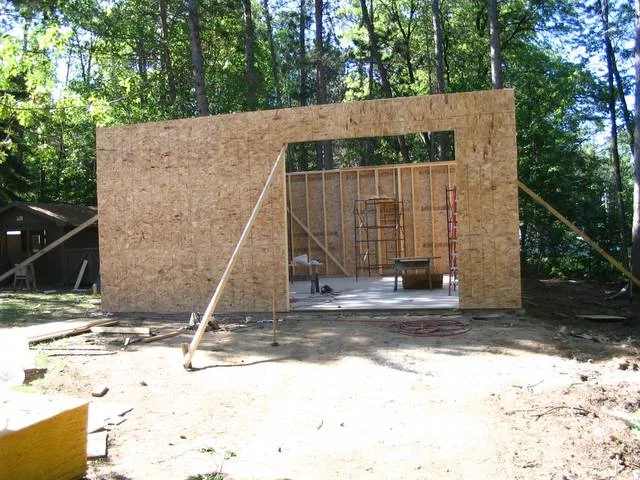

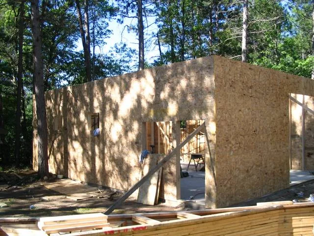

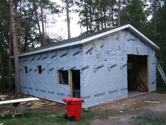

Got a ton done this weekend… thanks to help from a lot of people.. My friends Wheels and Miller were there both days helping.. My 2 Uncles and Old Man helped on Saturday morning…
We got all the rest of the walls up and sheeted on Saturday…. I worked from 7Am until 10Pm so it was a long ass day… but see the pics…

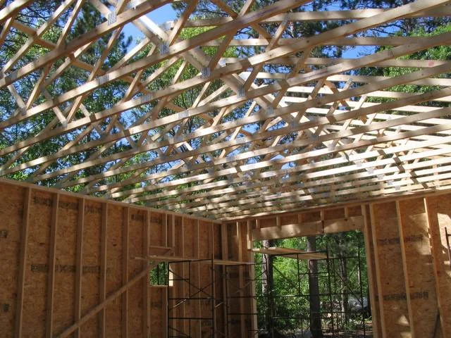

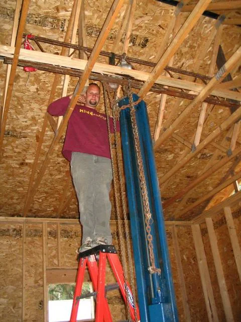

Sunday Wheeler and Miller can back up and we worked most of the day… Went to the Bar for the rest of it… Probably got a good 6-8 hours into putting up these Trusses, but that included all the layout and all the bracing and squaring up of all the walls… I went better than I thought but still lots of work and I am really glad it is done…
Thanks again for all your help guys!!!!!!!!!!!!!!!

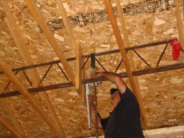

just one more of the inside..

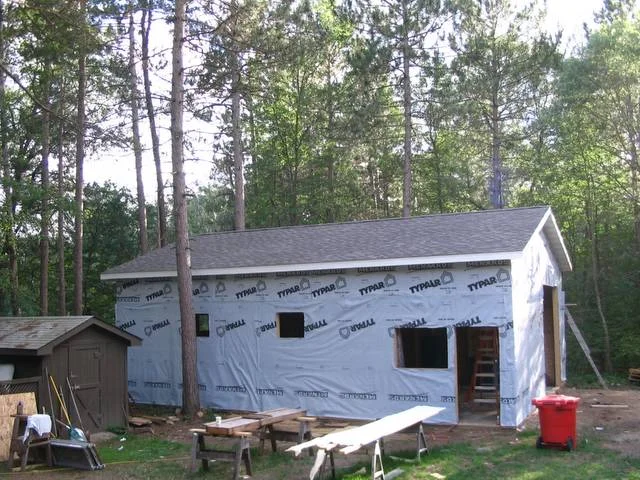

Looks Great more Pics.

nice build up
and..
nice looking garage, hope you laid some some steel mesh before pouring though...

Quote:
Originally Posted by kiwi-fj40 View Post
nice build up
and..
nope just got the new kind of concrete that has fiber already in it... no need to lay wire when having a slab this size.. good up to 1700 PSI.

ask and you shall receive.......
here is one with the sheeting on the roof....

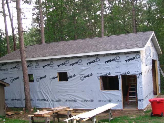

Last Thursday we moved my lift to the shop.. (thanks Furball, Wheels, Phil, and Charps) it is not up yet, I am hoping to get that standing this week... I got the bolts I need to do that yesterday so I am set there....
we up the shingles 2 weeks ago... working on sofits... got most of them done.. Got most of the Tyvac on also....

Ok we will talk Lift Tech today... took 2 evenings but my dad and I got my lift in the air and got it all set up... here is a little write up of how we put this thing up...
pic #1 moved both lifts to the edge of the wall...
Pic #2 you can see what we used as a beam to run along the rafters... This is from an old roll in Dock my dad had laying around at his house... dont really know what it was before that... I am sure someone used it to make the dock... well that is 10' long and we used 2x4's to brace it up so it would not tip from side to side...
Pic #3 We measured out everything and layed out exactly where the lift needed to be... remember I have a 15" footing of concrete under them... pic #3 is actually of a chalk line that we used as a Plumbob (spelling???) anyway.. never knew you could use a chalk line for that.... We figured out where to hook the come along to the beam by doing this

Pic #4 this is my dad using the come along to get the lift in postition... we actually lifted them up as you see and then they would slow swing into position... we then slow let them down...
Pic#5 Dad on the other side... Pretty much the same..
Pic #6 I had to get up to finish the second side... see we have two come alongs on there... I ran the main one and my dad would run the second one... we just used that one to make damn sure if somthing happend to the first one that this thing was not going anywhere.
