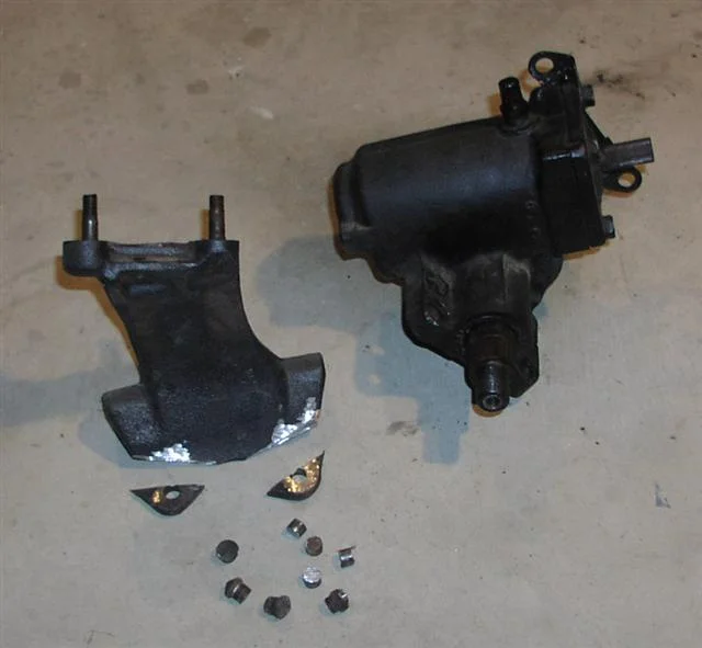

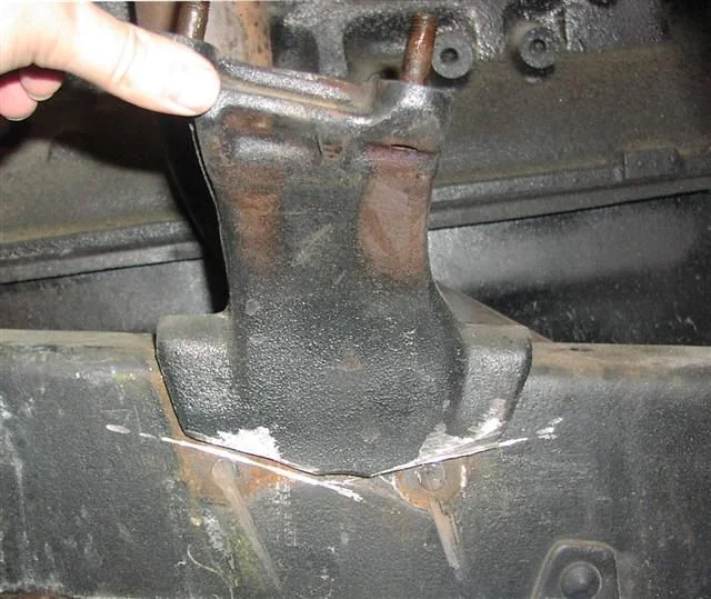

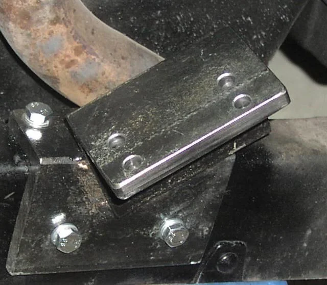

I had power steering on my short list of mods to do. Gathered the parts together and went at it.
I found it easiest to cut out the old manual gear box mount - this made getting the rivets out that much easier. Had to drill through the rivets before they would let go but it came off in the end.

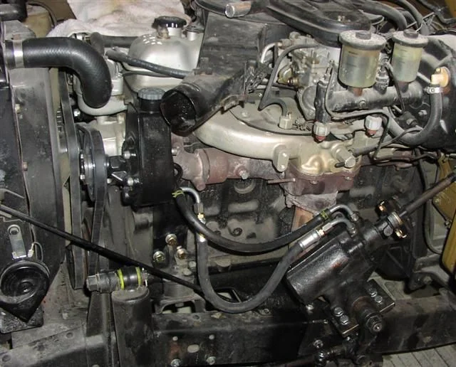

Had a new high pressure hose made locally. One end is metric for the Toyota gear box and the other is standard to match the outlet of the Saginaw pump. I'm pretty happy with the way it turned out as the center section of the hose is easily replaceable. Test fit the gear box and drilled the holes in the gearbox mount.
Installed the remaining pieces of the puzzle and tested it for pressure - works like a champ. Now back to the body work. I'm getting closer.

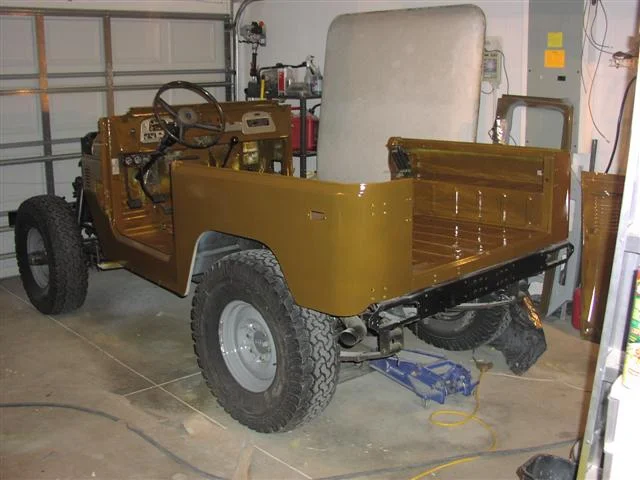

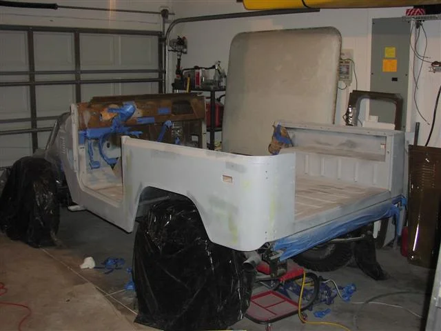

Primed, blocked and began painting. I still have some odds and ends to take care of but I am beginning to see the light at the end of the tunnel.

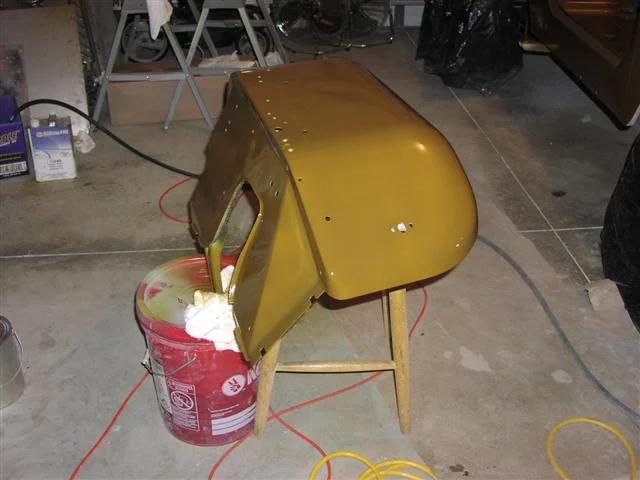

A few more:

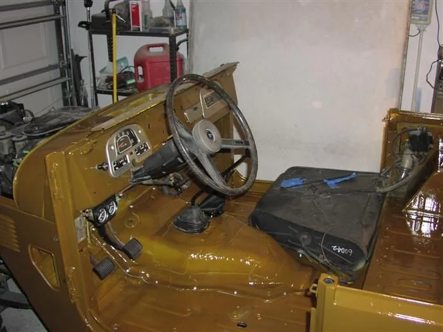

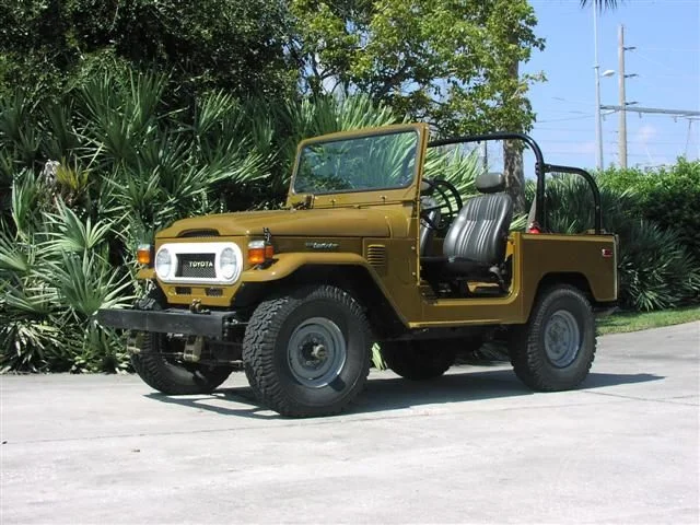

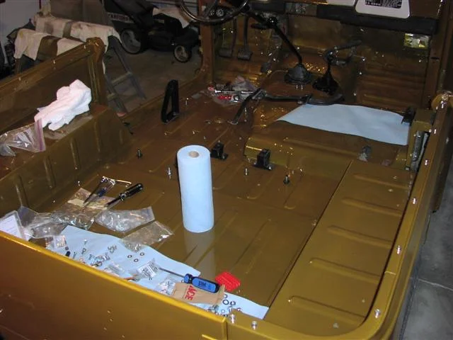

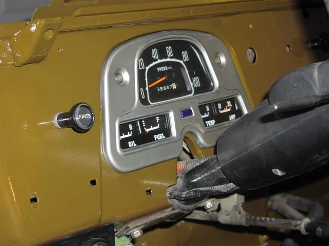

Just finished putting it all back together - I must have made 5 or 6 trips to the hardware store just to pick up nuts and bolts alone:
__________________
1976 FJ40 - See Build Up Thread Here:
http://forum.ih8mud.com/showthread.php?t=125665
1996 Lexus LX450
2006 Mustang GT V8 Manual Trans
Nomis is offline   Reply With Quote
Old 10-03-08, 11:38 AM   #105
IH8MUD Addict
Nomis's Avatar
Join Date: Feb 2004
Location: Tampa
Posts: 864

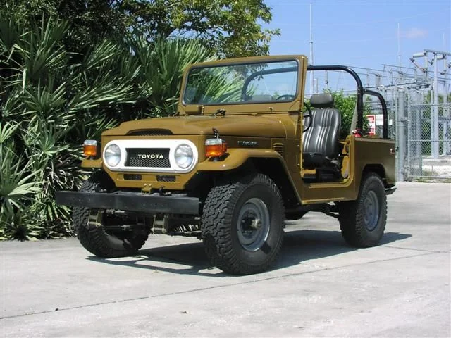

Finally!!
I'm pleased with the way it turned out. Just got back from a test drive and it ran and handled great. It sure feels good to get it back on the road. I still have a few odds and ends to take care of but at least its road worthy at this point. It took me a while to get to this point - I'm not going to know what to do with all the extra free time I'm going to have.
I'd also like to extend my thanks to those of you that helped me along the way, I'll try to return the favor whenever I can.
__________________
1996 Lexus LX450

Here's a few more shots:
