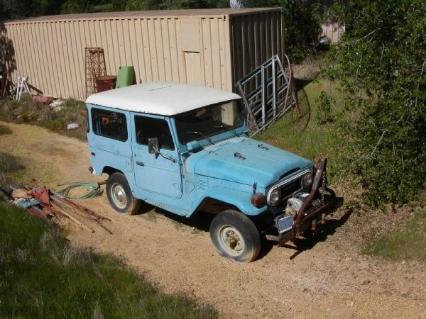

The way it looked when I bought it.
This is the way it looked when I bought it.

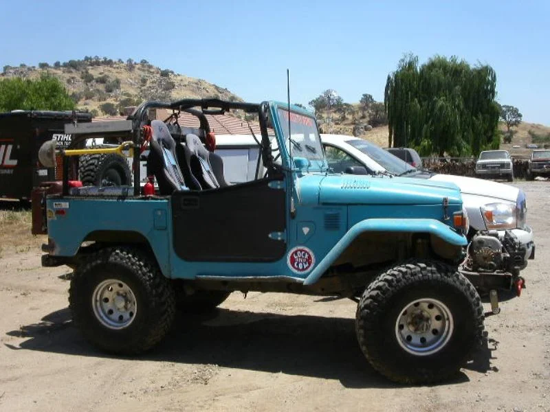

I'm still new to ih8mud so please forgive some of my picture postings. My rig is sitting in front of a 2006 Dodge pickup for measurement. The closest mountains in the background is were I go wheeeling.
Yes, it's across the road and it's 36 acres of pretty much what you all the type of terraine you see in the background.

Nice truck. You got any action pics?

How much rubbing if any do you get in the rear?

I get rubbing two different ways. On the almost finished photo, if you look closely at the right rear fender corner right behind the wheel you can see were the paint is worn. This is actually caused by body roll while driving on windy mountain roads. It does not touch at all on the left side. I have never made contact with this area while wheeling.
The other type of rubbing I get is inside the wheel well. This is generally from extreme articulation while rock crawling or driving out of mirror lake. I get more rubbing in the front. I could easily prevent this with the right size bump stops. I am delaying making bumb stops until I feel my springs are broke in. Right now it has about 650 miles on it after most of the the modifications were done. About 500 of those miles are highway and 150 or so are off road.

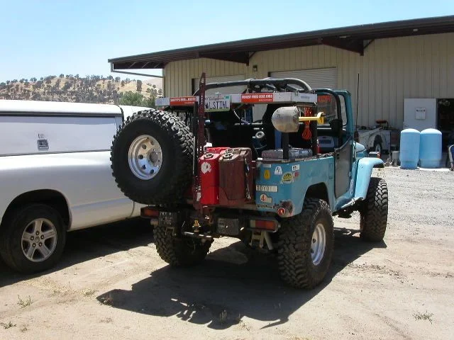

My Today version disappeared so i posted it again.

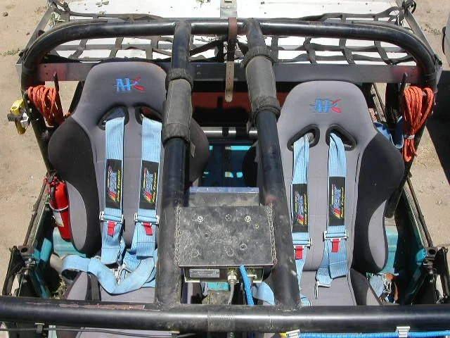

Interior
Here is a picture of the inside. Imagine standing on the hood looking in.

Here is a better pic of the rear. I have a tool box mounted to the top of the inside fender well. A shovel is mounted to the roll bar with the fist grips.

The rack is one of those cargo haulers that slide in your receiver hitch. I found an aluminum one that was the same width as the roll bar. I mounted it using some U-bolts. I strap the gear down using a mini truck tailgate net. It works very good. It sits low enough that the wind doesn't bother the gear when going down the freeway.
I mostly do rock crawling and trail rides. I try to do the Rubicon once a year as well as the Dusey Irsham trail. I generally go wheeling east of Fresno outside of Shaver Lake. There are a ton of trails. The hills/mountains you see in the background of some of the pics is were I go wheeling every day that I'm home. It may sound funny but I will actually load my rig and then hit my personal 36acre rock park to see how it wheels. I adjust the load as needed.
