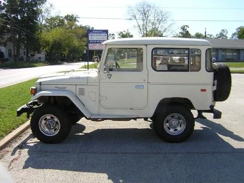

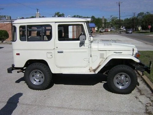

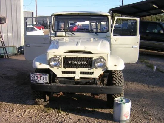

Thought I would share the process of my build for those who are interested. I am starting out with a pretty solid 79 FJ40 that has 28,000 original on it according to the title. This rig has very little apparent rust showing at this point. I am having all of the glass and panels taken apart and sprayed separately prior to assembly. Stainless hardwear will be used in the assembly. The underside will get a fresh coat of POR 15. The interior will be lined with a tinted to 031 liner.

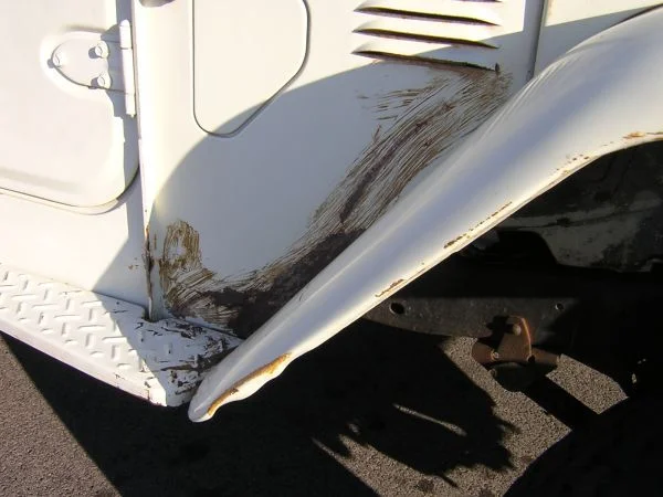

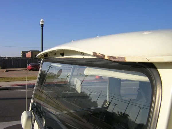

You can see that the front of the rain gutter is bent upwards. The right fender has been coated with some kind of funk and the hood has a pretty good ding in it. But no complaints out of me.

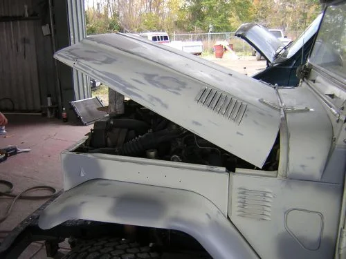

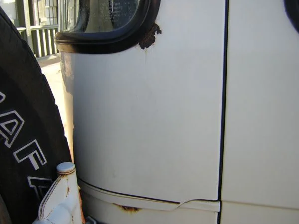

Here are some detailed pictures of the trouble spots.

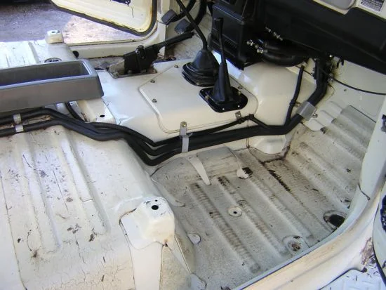

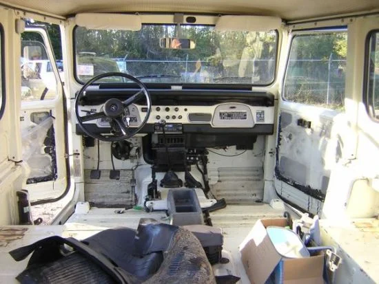

Here ar esome of the progress photos of the disassembly. You can see that the interior floor pans are in pretty good shape considering the rigs age. Some attention will have to be given to the tailgate / rear door area though.

One question has come up. How do you get the factory sound deadening off of the floor pan in the front? The stuff is as tough as nails. Seems to be an asphalt based product? Any ideas while I search the archives?

Use a propane torch and a few putty knives. Open air environment also for fumes....When you get it hot it comes off easy with a 1 inch wide metal putty knife. Then you can really heat up the small remaining spots and get them to come off with a piece of heavy steel wool. that is what I did on my 1979. Easy

Just curious, why are you taking it off? It looks like its in good condition.
I removed mine but it was pretty damaged and ugly. Even then, after I removed it, I noticed a difference in the interior sound. It does help to dampen road noise and floor pan vibrations.

There is some damage on the drivers side at the edge of the mastic. The other reason is that after repairing the interior I am going to line the entire interior pan. Partly for sound, partly for toughness. And I know there are those out there who would say this lowers the resale. I say so what. As far as I am concerned right now there is no resale value as it won't be sold. I was struck with two possible names for this rig 1. Blanco Burro 2. Coffin - I'll be buried in it.

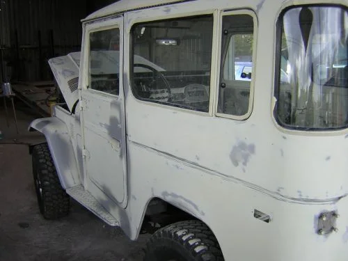

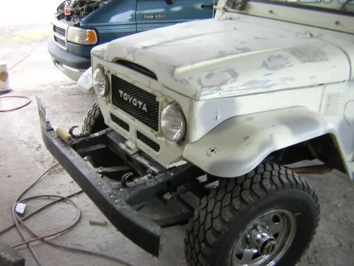

Well time for update photos. Right now the dings and dents have been worked out and a light coat of filler to flatten things out. Today the top is coming off, the windows are coming out and the interior gets started on sanding. Gaskets have arrived and are sitting in a corner along with the POR 15.
