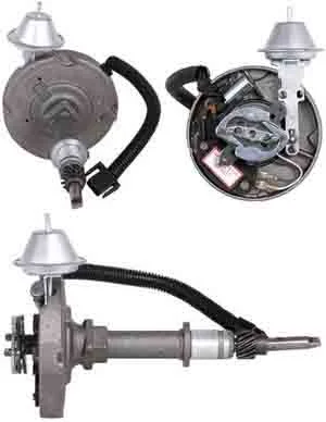

Or you can use the distributor of a Chevrolet Camaro 6 cylinders, look the picture!!!
I have one like this in my FJ40 (2F engine) and it runs great!!!!
