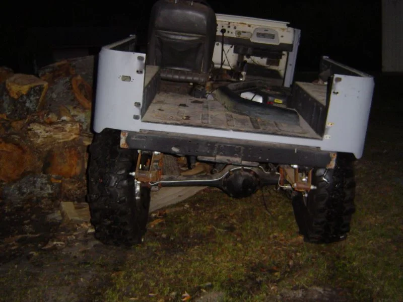

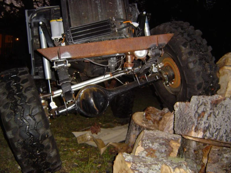

Just started replacing all the fuel lines with the ones I got from Fasteddy. I had to remove the thermostat housing in order to get them on. I have not connected everything up yet, but it looks like they will work out o.k.. I removed the fuel pump so I could switch some of the fittings around, and I am now waiting on some parts. I ordered a new fuel pump gasket, thermostat outlet gasket, all new cooling hoses and new clamps from my Toyota dealer. Hopefully everything is still available, he is going to call me tomorrow and let me know. I am going to flush the system and refill with long life Toyota coolant before I put it back together.
Would a 70/30 mixture work for the south or should I use 80/20? It can get up to 110 in the middle of summer sitting on the blacktop in traffic, or am I just getting picky?

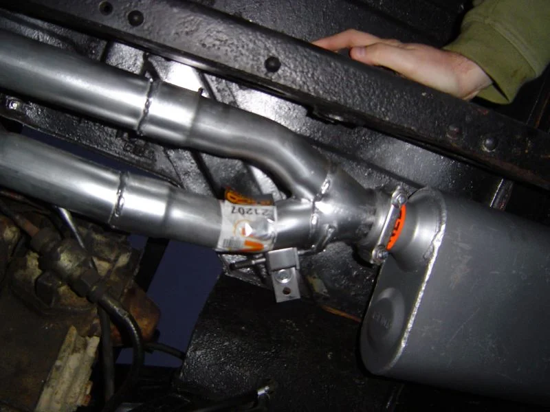

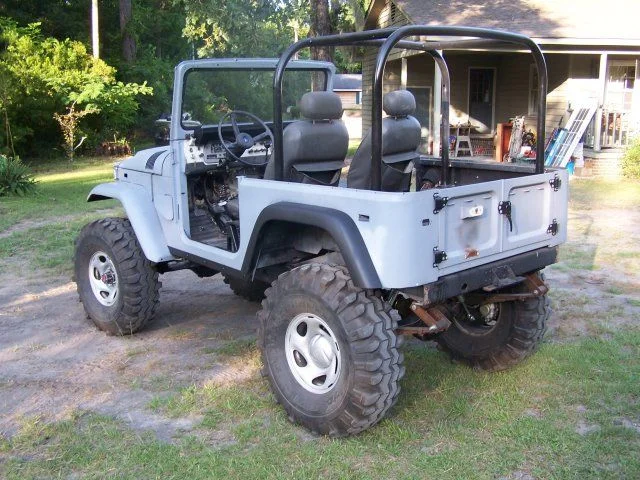

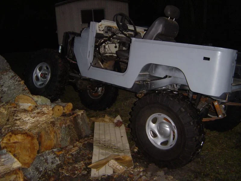

Alright, finally got my cooling system done and got my new exhaust system on. Changed the stock alternator to a Delco 12Si 94 amp unit, and got my new fuel lines plumbed to the tank.
At post #21 Too Tall said to quite posting pics in the garage and get it in the woods, so I quit posting pics in the garage until I had some action shots. O.K., not in the woods, but how about on some wood.

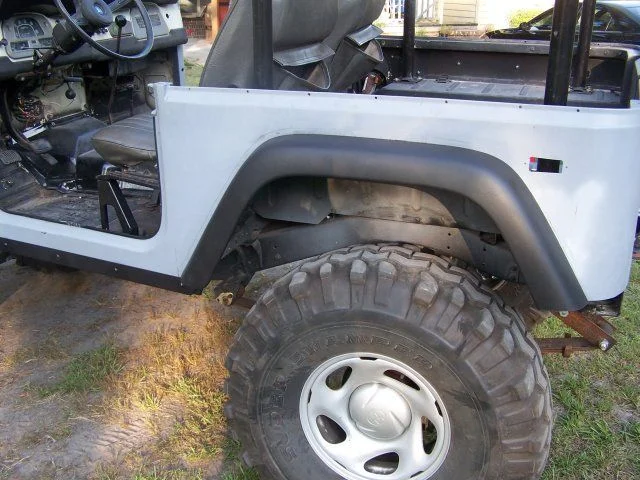

Some more...

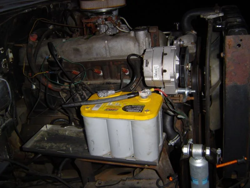

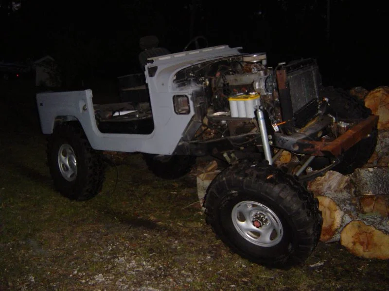

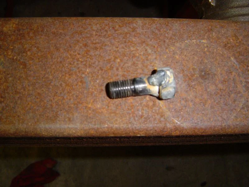

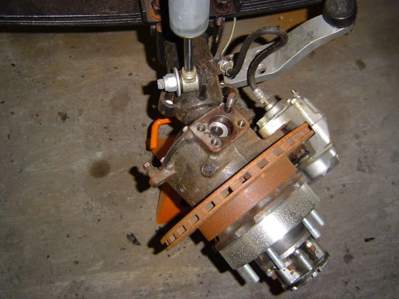

A pic of the new alt. and battery set up. After I got done one of the knuckle studs looked loose, so I started torqueing them to 120 lbs. After a couple got tightened one snapped. These are FROR arp studs. So I called to order another one and they are replacing it at no charge, said that wasn't supposed to happen. So in order to get it off, had to weld a nut to the top of it. I have the fenders on now I just haven't snapped a pic yet. Once I get the knuckles back together I'll have some action shots in full sheet metal.

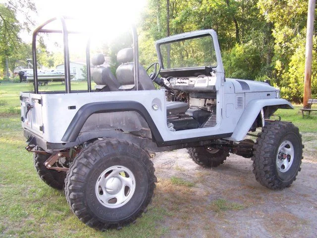

Finally took her out today and tested her out. Really put her through her paces. Everything held up great. Took some getting used to how she handles, but the engine and axles were awesome. The SOA was a little high, but I am hoping the springs will still flatten out some. They all still have a good bit of arch in them. If they never flatten out, I may swap the springs out, or go to an extreme sua set up. May just run it like it is until something breaks and then link it though.
How do you guys handle the tip over effect from the rear with SOA rigs when going down hill. I had zero weight in the back. Will it handle a lot different with about 800 pounds in the back? How long does it take to break in stock springs with a SOA set up?
Never aired down below 20 psi and we took some pretty serious sand dune hills. Got airbourne a couple of times, came down on the front end pretty hard and all is good. I was most impressed at the engine and tranny. It just kept going and going. Also I am a true believer in a well tuned aisen carb. Never had a problem getting any fuel, even on some almost verticle runs.
Still got to get a front glass and finish my rear wheel wells, but I am pretty much done for a while. Gonna get her tagged and insured and enjoy her a little bit. Sorry no pictures of the sand running, but I will have pics of her complete and enjoying life soon.

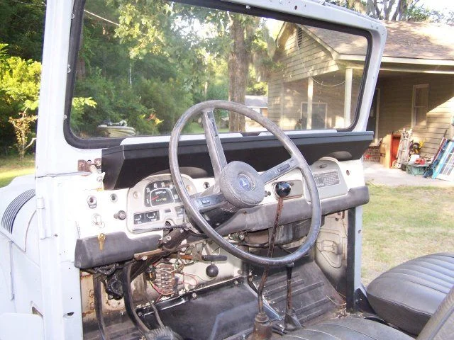

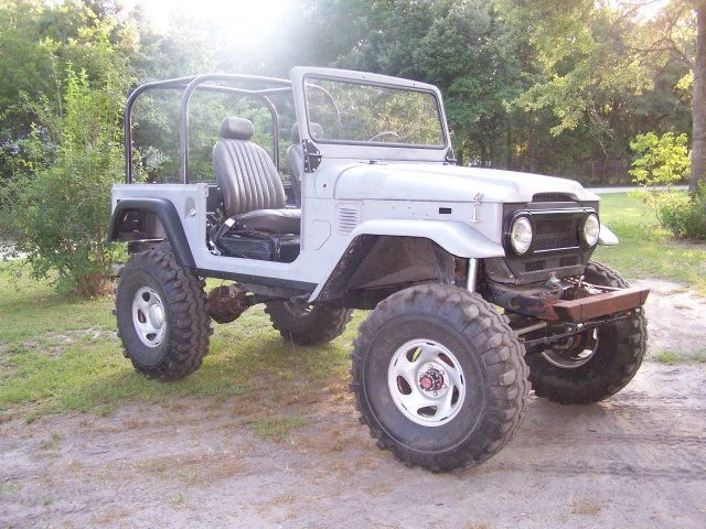

The "final", yeh right, product!

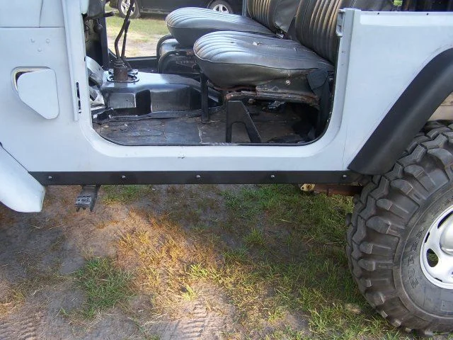

Set 2!

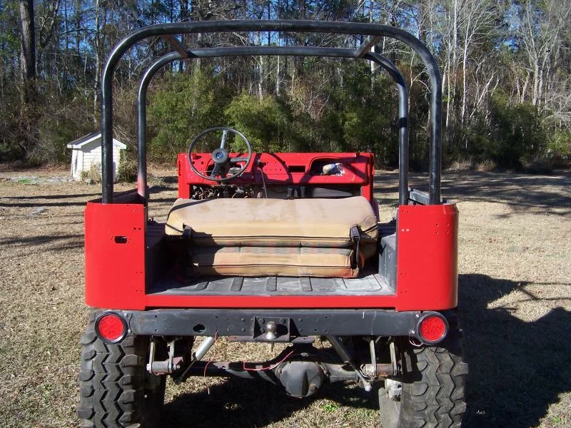

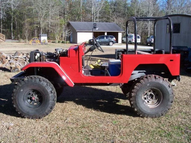

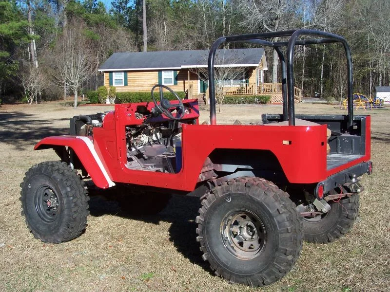

Another update on the build. Finally got her painted, just need to make time to put her back together.
Specs:
Dupont Nason Freeborn Red
Dupont Nason Clear Coat
Sprayed in a garage

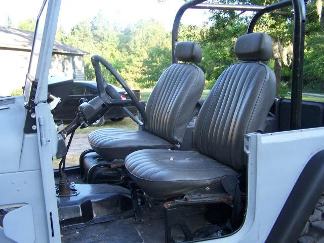

yours is very different than mine but nice
I'm getting ready to do the scout steering on mine --wish me luck!
Are those seat mounts original--getting ready to do seats as well!

I posted in your seat thread, but they are stock. Just not to a 71'. They are stock mounts from a 78' that had bucket seats. I am going to be installing some leather Volvo S60 seats in it soon.

Back again for another look. Any pics of the alternator mounting. I am going with ps on my 71 soon and need to remount the alt to the other side. Mine is now a 2f/4spd also
I usually only like the stock wheels but yours look pretty good even if they do modern it up a bit they seem to be "right" looking. I like the tires a lot too
