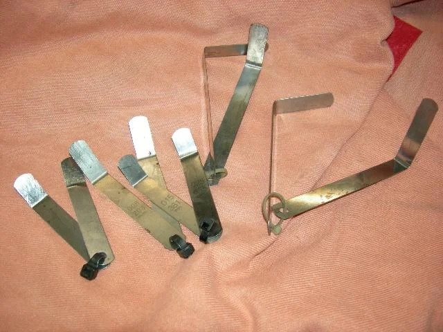

Get this, I just ordered the blue (.20mm) and the light green (.35mm) from Wurth and they said the .35 was discontinued due to lack of sales. No .35mm in stock anywhere.

Location: Great Falls Virginia
TLCA# 3521
Posts: 876
Well, that sucks!
I guess the ones I gave my buddy are worth more than weight in gold then...
James Asti gave me mine, maybe he has more? 4x4connection.com
Also, I found these:
http://www.techsavvy.com/industry/fi...&base_region=*
Also, this one rocks:
http://www.lsmproducts.com/
scroll down to the FL200
-Stumbaugh

Wow...
Guess I am the cheap guy...

Good Feeler set:
http://cgi.ebay.com/ebaymotors/Mark-...temZ4642949314
-Stumbaugh
