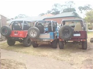

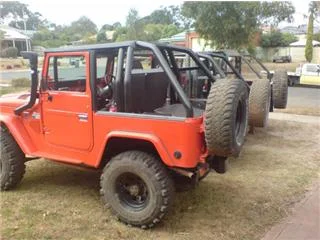

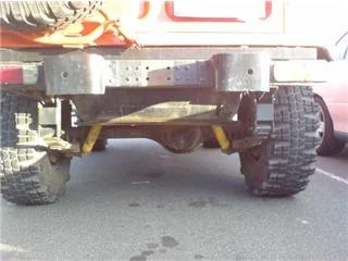

G'day, The Blue & the Orange FJ40's both run duel fuel with tanks under slung at rear (quite common here).
The Blue one has no bash plate and does make occasional contact with the terrain but so far there hasn't been any huge explosions! The Orange one (mine) has a bash plate and had the tank lifted when a 2" body lift was fitted and thus far hasn't hit anything solid. So underneath is fine but better if you have a body lift.
My local Mechanic obtained & fitted the Fuel gauge to the tank - all I have to do is read the little lights - lots of green = you're go to go, Red = you're walking home. I know of a couple of 80 series running Duel fuel and they use the same gauge for both types.
One other thing if you go underneath, make sure the tank is heat shielded if the exhaust runs near it.

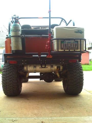

I can answer your question for I have the same setup.
Mine is a 43# cylinder. I have to remove it to refuel.
Kind of a PITA but I think it is worth it.
If I didn't have my kids always with me I would put a larger one in the tub.

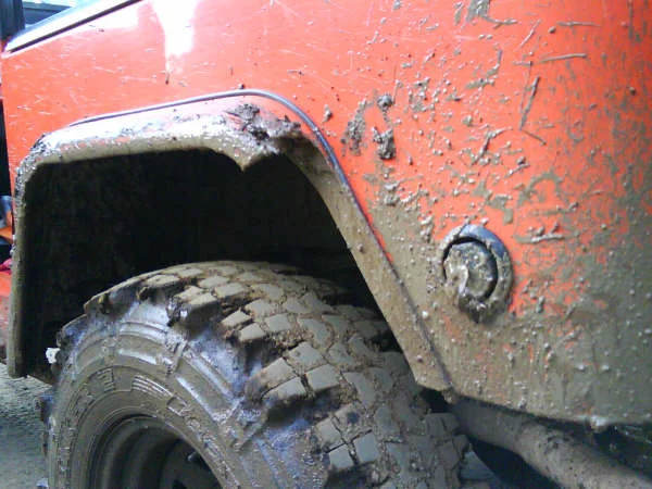

It has a filler point in the rear quarter panel - no need to drop the tank. Best to recess the filler point so it doesn't get hit when wheeling & use a flexible hose between the filler point and the tank.
