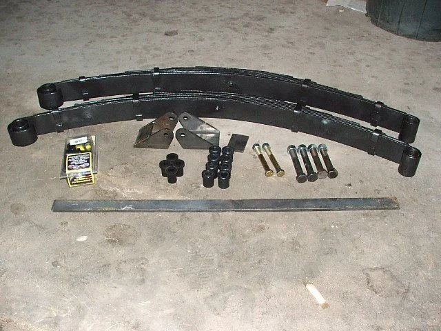

Here's a parts pic for those who want more.
FJ55 Springs
Pack of ES bushings (for the front)
RuffStuff Spring hangers
4 FJ40 Poly bushings
8 FJ55 Rubber bushings
2 FJ40 sized shackle bolts
4 FJ55 sized shackle bolts/spring pin bolt
35" of 1.5"x3/8" steel for shackles

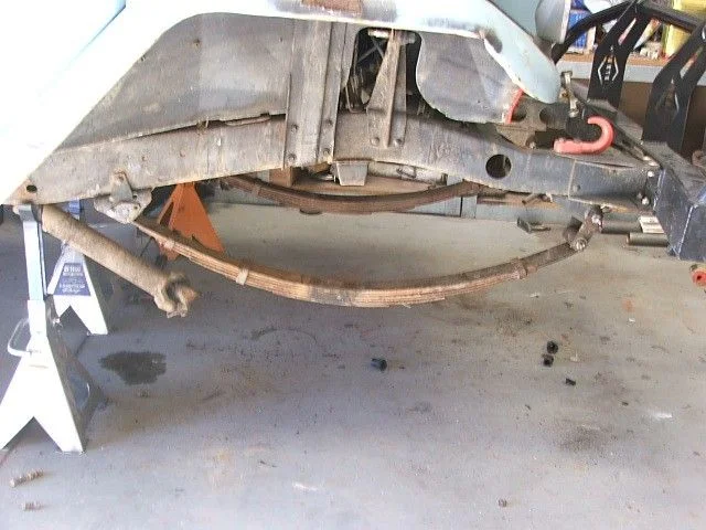

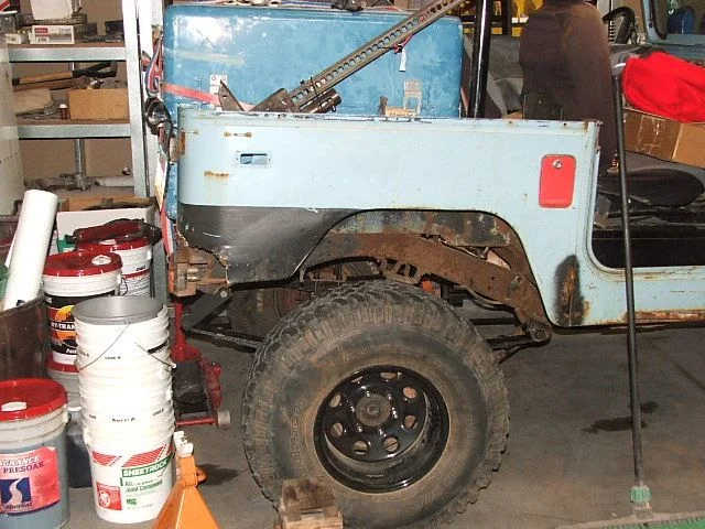

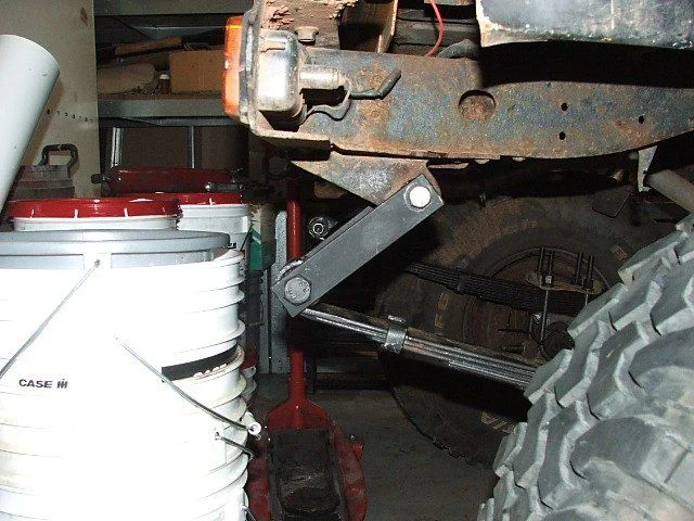

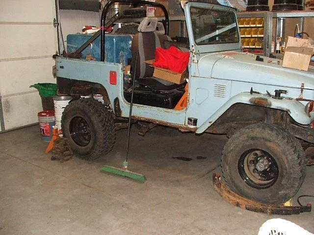

Ok so since enjoii had some exhaust work to do and I was pretty lazy today I didn't get much accomplished. Here's some pics.
1. Passenger fender (rear)
2. How it sat before I started to tear into it today
3. Rear shackle angle (i think I may be rebuilding these)

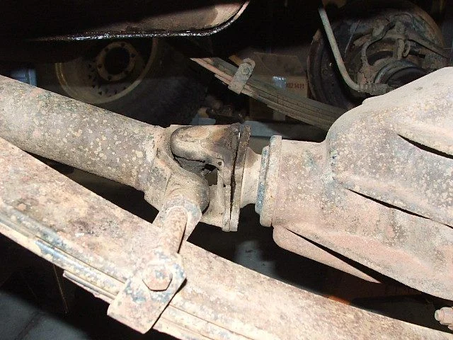

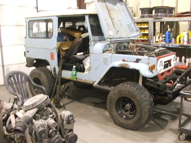

More pics
1. Front end, sits now
2. Description to follow
3. Continues with #2

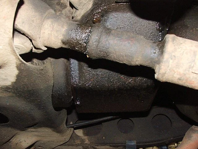

Ok so for some odd reason my DS will not compress any further and so there it is stuck to the pinion flange. Makes me wonder how I managed to articulate and not kill it! Any ideas to remedy that? I am not upgrading DS's yet if I don't absolutely need to so that I can finish the S/R in the front first.

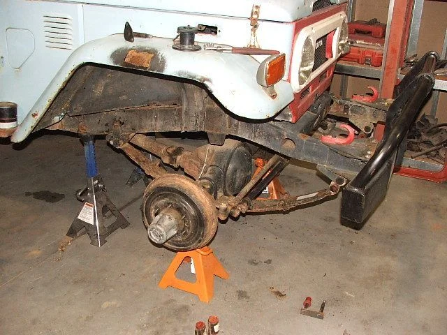

Here's about what we accomplished today
Pic 1. Don't ask
Pic 2. Front axle out. New front springs hung
