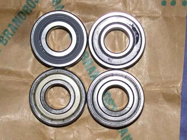

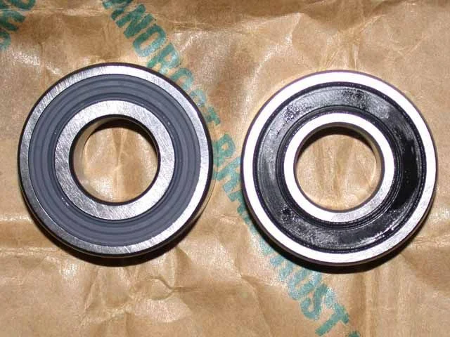

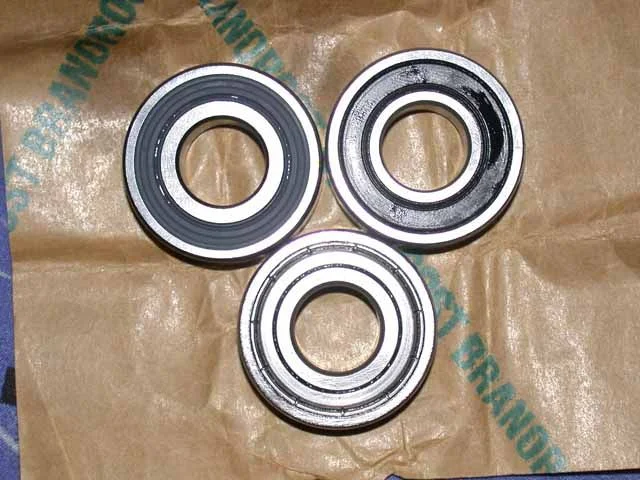

For visual comparison, the first photo shows the high temp 6202 ABEC-5 on the left and a 6202 ABEC-1 250 degree F sealed bearing on the right (available from McMaster Carr). The second photo adds a shielded ABEC-1 bearing (also available from McMaster Carr). The last photo shows the factory bearing on the lower left.
