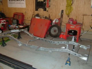

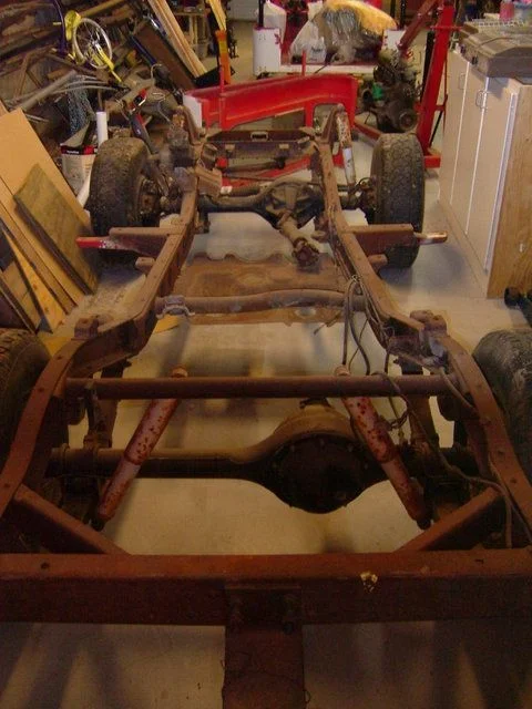

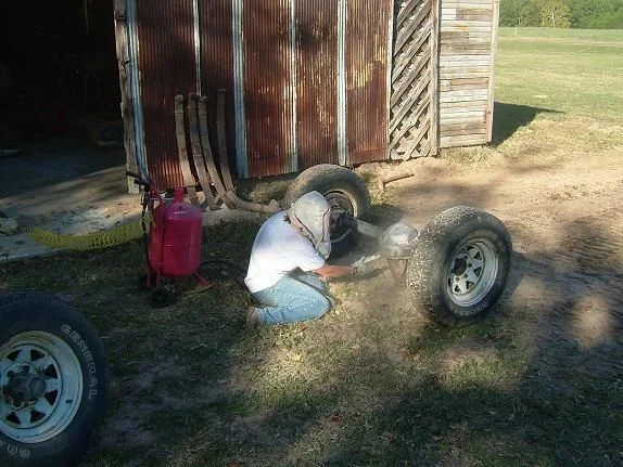

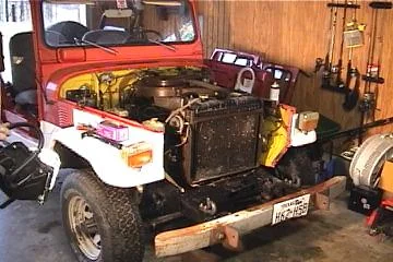

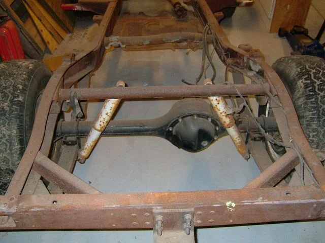

Last night, I finally finished the breakdown of my 75 FJ40 for a frame off restoration. I thought I might celebrate with a few pics. Next step is to sandblast the frame vs acid dip with galvanization.

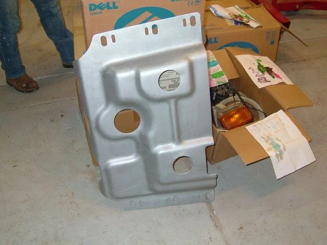

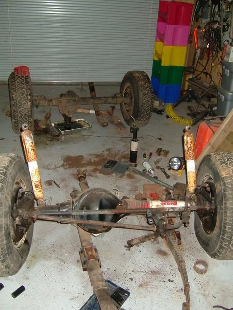

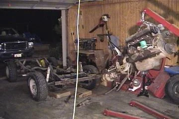

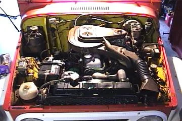

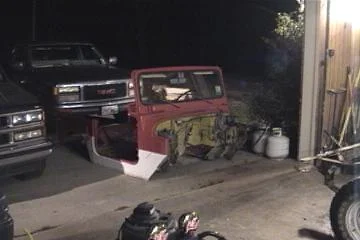

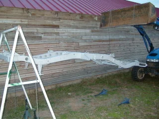

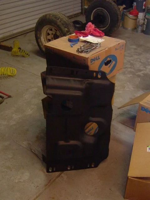

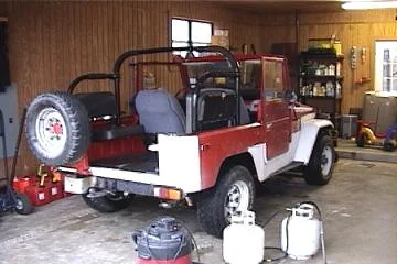

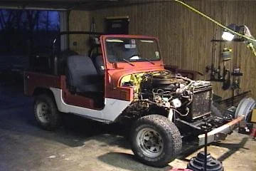

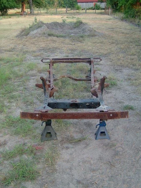

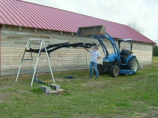

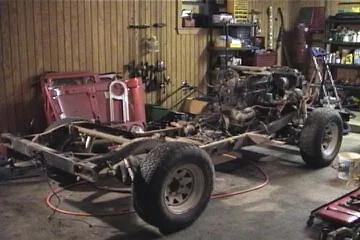

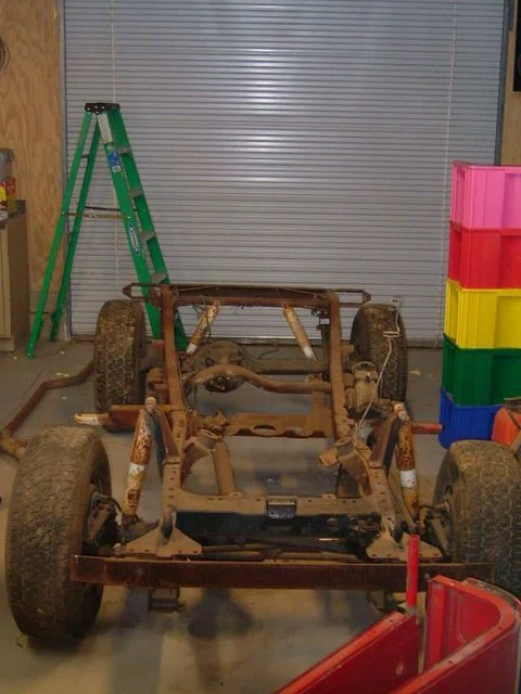

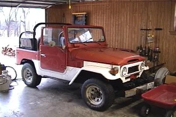

Here's a few more. Now I guess the real work begins...

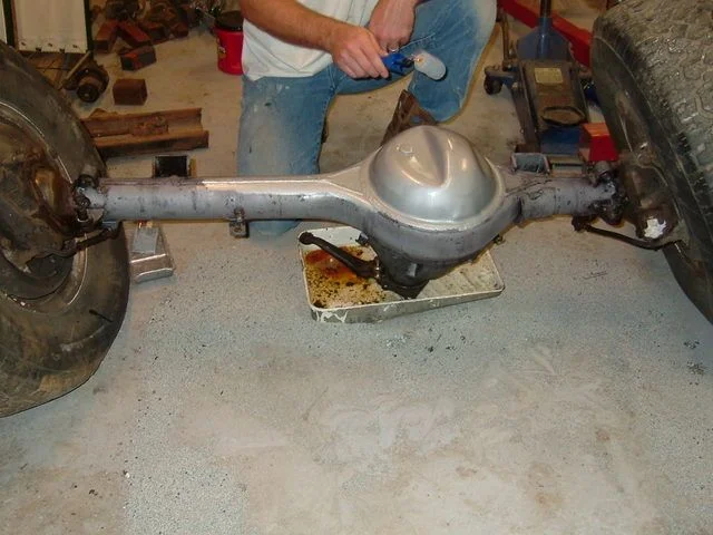

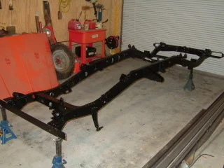

one more pic to make my kids happy

My frame has been galvanized, but has not arrived yet. Pics soon.
I finally got around to sandblasting the axles. Here are some pics of my wife helping me out. She kicks ass!
Next step is to put Rust Encapsulator on the axles and then paint them.

A few more pics. Parts were sandblasted then Jasco was used and Eastwood Rust Encapulator was used to prep the axles.

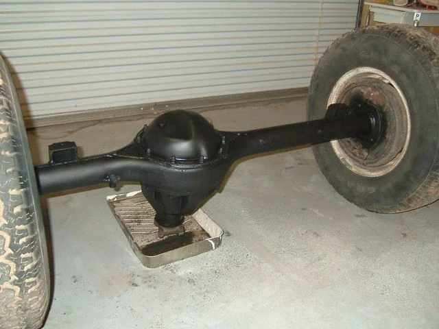

Axles and skid plate were painted with Rustoleum Satin Black Enamel.

The frame was acid dipped and then galvanized. See pics above for pre dipped condition.
Primed with Rustoleum 2 part epoxy primer.
Props to Waorani for giving me the part numbers to order from.
The frame was then painted with Eastwood Chassis Black. I am not sure I would use this again, as it really gummed up in the gun quickly, even with adequate thinning with Xylene. I had to clean the gun 3 times just while spraying the topcoat.
