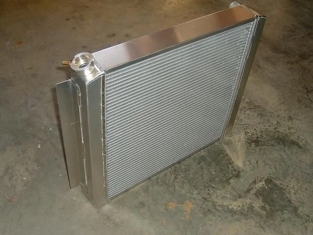

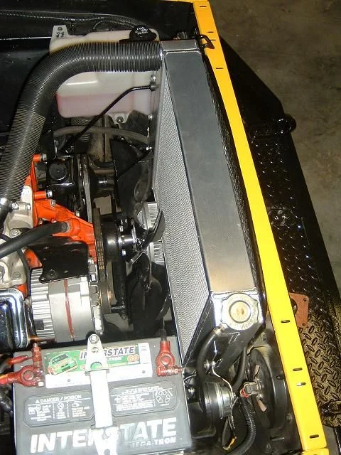

Cooling any water-cooled vehicle is a combination of four things: airflow (fan/shroud), water flow (waterpump/thermostat) and fluid at pressure to raise the boiling point. Proper cooling of a Chevota has been debated before and surely will be again. I cannot understand how anyone living where the ambient temperature is over 70-75F can cool a SBC in a 40 with the stock radiator, whether it's 3, 4 or 50 cores deep. I guess it's how one defines "cool". Some go by the needle position on the stock gauge, others with a high-quality aftermarket gauge. To some, anything over 180 is too hot, others may define hot at 230F.
Up to a few weeks ago I tried everything short of a larger, non OE-type radiator: 4-core HD radiator, high flow WP/TS, water wetter, solid fans, flex fans, elctric fans, shrouds, diffferent bumpers, no bumper, remove the winch, snake oil and prayer. Somethings made no difference, while others helped some. The final solution for me was to go larger, aluminum radiator. I do not know why I waited so long. See
http://forum.ih8mud.com/40-55-series-tech/92199-best-price-drop-aluminum-fj40-radiator.html
It really wasn't that hard. Just more $$.

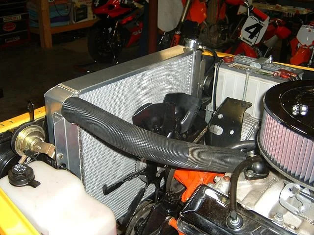

I am using an aluminum 29" radiator from Summit Racing along with a Black Magix Extreme electric fan I have never gone over 205 degrees, even on a 100 degree day. Most of the time I run around 190 degrees with a 180 degree thermostat. See pics below.
Radiator cost = $179, electric fan = $250, new thermostat & hoses = $45 ...having a properly cooled V8 in a landcruiser, PRICELESS!

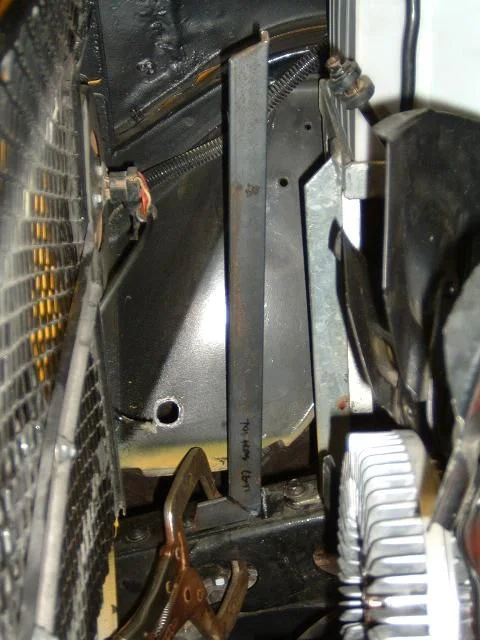

Posts: 3,319

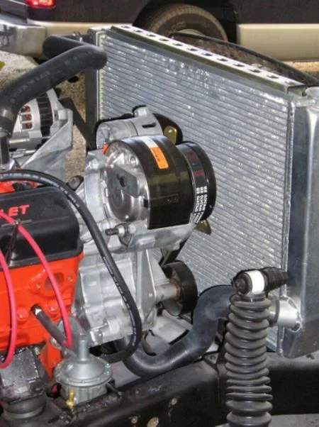

...gotta a star...more pics

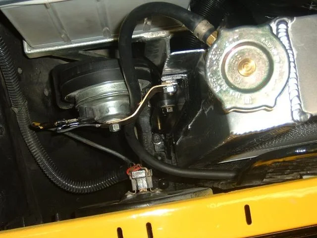

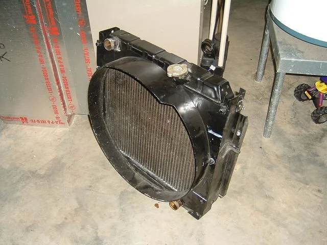

more

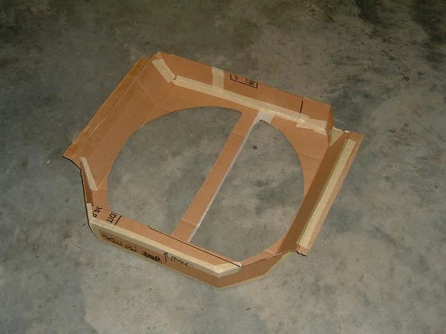

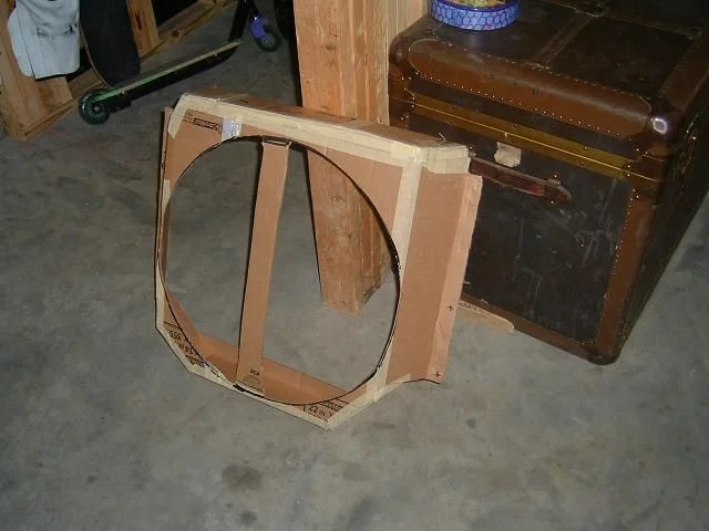

Posts: 3,319

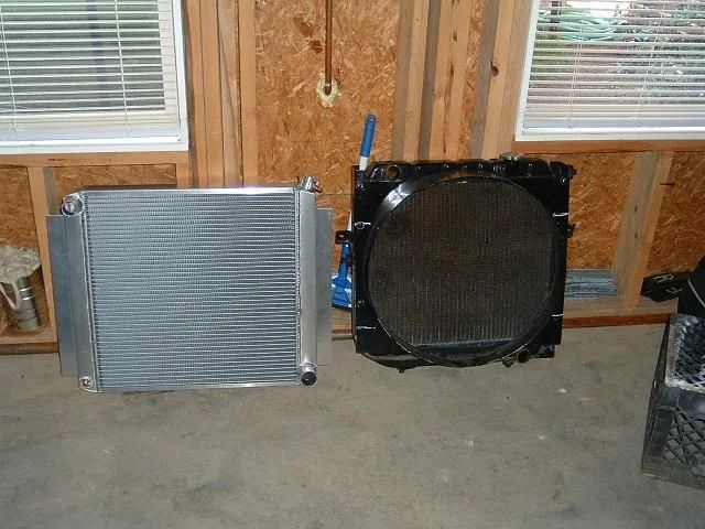

...and my planned shroud. Can anyone recommend someone that could make this from say 0.060" aluminum for less than my first born?

A sheetmetal shop could probably make on easy, I called up a couple big roofing comps. and they said they could fabricate mine also..
I put a 31" x 19" in mine, cheap from Summit.
Why do you need to have it made out of aluminum? Just spray paint that thing black and call it good Just don't spill water on it.

It's a real close fit, but it fits without any clearance problems..
I bolted up the fenders and bib and measured to see how it would clear the hood and everything checked out good, except it's real close on the hood..
It works great, I got the chassis parked in a 100 degree shop and it keep my 406 at 190 degrees with no shroud and a 16 flex fan, but a shroud it soon to come and that should bring it down more and wind from the vehicle actually moving ofcourse..
Here's a pic, it's the Griffin brand radiator
There's more pics in the link in my sig it you want to see them and my ingenius mounting system..
you could always fiberglass it and paint it

Regarding the fit.....nothing on an obsolete 35 year old vehicle with a bastard engine bolts right in. I have a bud that has a 350 SBC in a 84 CJ7. I liked how his radiator mounted so I took some measurements, pulled it out and made a cardboard template. I put his radiator back in and used the mock-up when I could get around to playing with mine. It fit really well but I ended up having it made 24" wide so I could fab vertical angle iron mounts directly up from the FJ frame rails. The core is something like 22" wide X 20" tall. The CJ-style mounting system made it easy to mount. I have approx 1/2" clearance on the Saginaw spud shaft and 1" from the radiator cap to the inside of the hood. It fit well but I had to move my custom galvanized battery box back to allow room for the extra width of the radiator. Like I said, nothing bolts right in and previous mods had to be redone to allow extra room not even considered necessary before. My other option was a direct-fit OE-style aluminum radiator like a BeCool but the $400 I saved bought allot of creativity and most said they were inadequate anyway. Regarding the shroud, I was thinking aluminum to match the cool-factor of the new radiator.
It has worked awesome....lowering my operating temps by 25-30F. It now runs 180-195F in 100F ambient temps at any speed/load...and that's with a new clutch fan and no shroud (yet).
