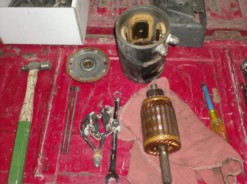

#1 before pic of the motor. I can't powder coat the motor housing without fully disassembling it and risking wrecking it. So I will spray bomb it black after blasting it. To blast it I stuffed it with rags and avoided blasting directly inside it. The end cap I covered the bushing to keep the glass bead out.

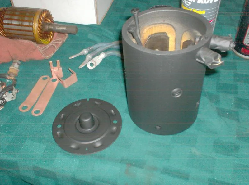

#2 after. I only had a flat black here at the house so after several coats of flat I will add some gloss black later. I masked off the two terminals and the name plate.
