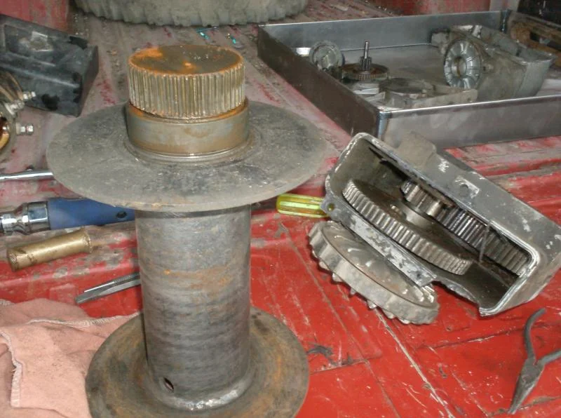

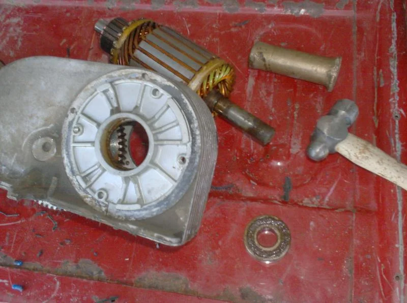

#1 I removed the motor shaft bearing and the upper case gears because I am going to get a friend of mine to try and weld up this case - it's a long shot but it might work.

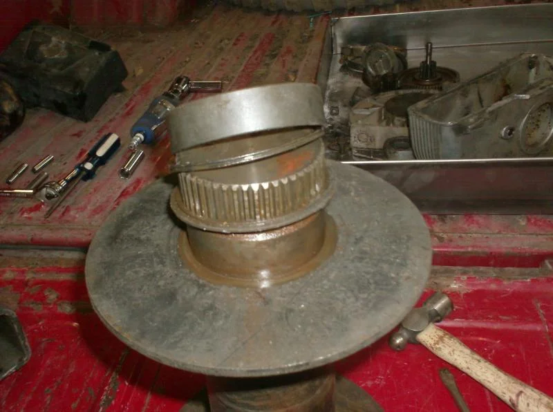

#2 Moving on to the lower case - I removed the drum by lifting the locking plate and simply pulling the drum out.
#3 Then removed the bushing, seal and thrust washer from the drum.
