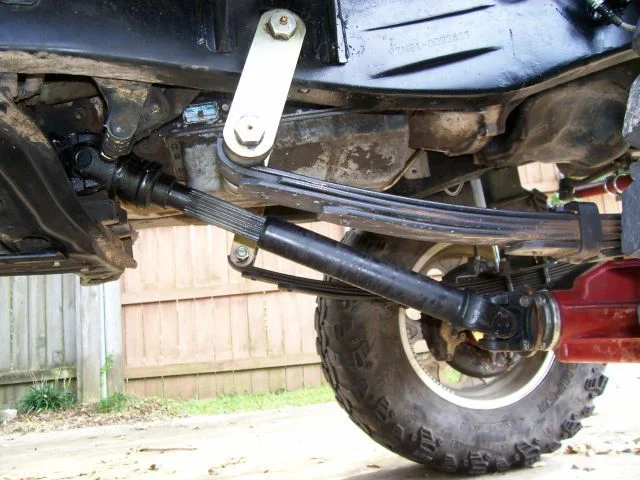

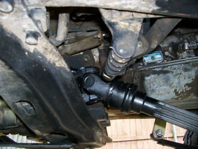

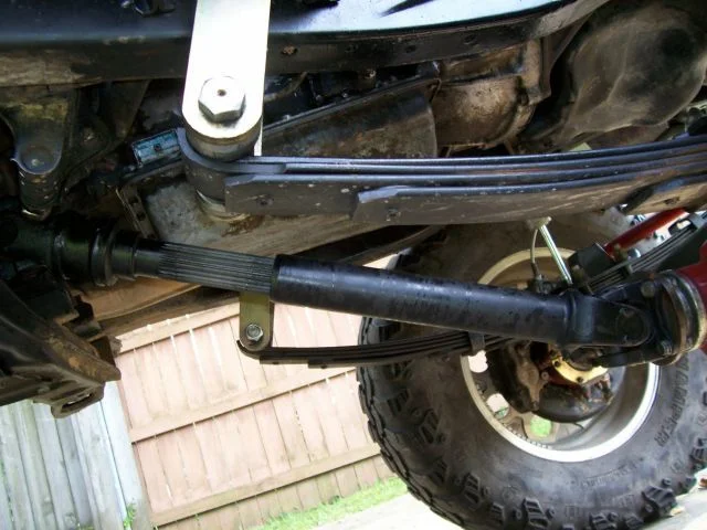

The 4runner is 4wd again. Installed the right transfer case flange and had a single u-joint welded on to the front drive shaft. Drove it on the street a little bit and the front locker does not unlock to well making it hard to steer, but that's an auto locker for you. With the auto trans I can just shift into 2wd when needed.
