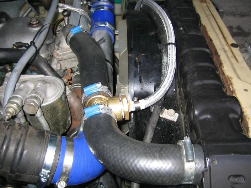

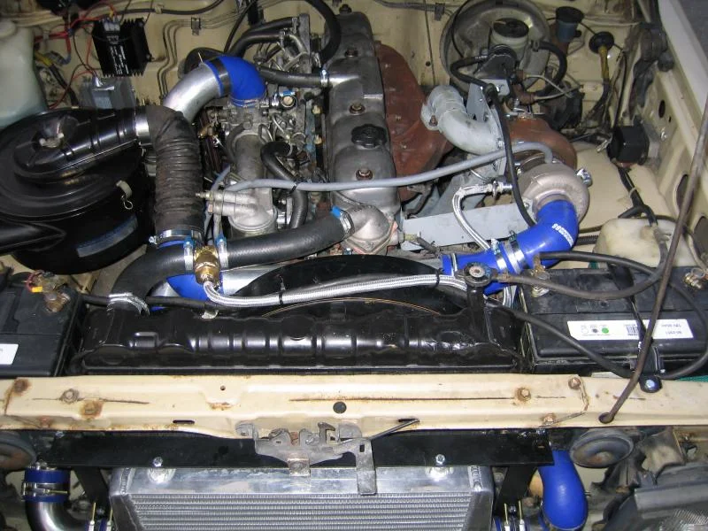

Install is almost finished...
But it's not working proparly.. boost is only 0,25kg/cm2 (3,5psi)
It seems like the fuel is "held back" or sucked through a very thin straw as soon as the boost starts to come..
I have tried adjusting the stop on the edic-arm for more fuel and it seemed to work below 1500rpm... over that and the engine feels strangled more than forcefed over 2000 rpm it's actually a lot slower than before...despite the 3,5 psi..
Something is not right..
