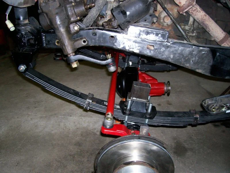

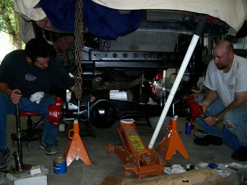

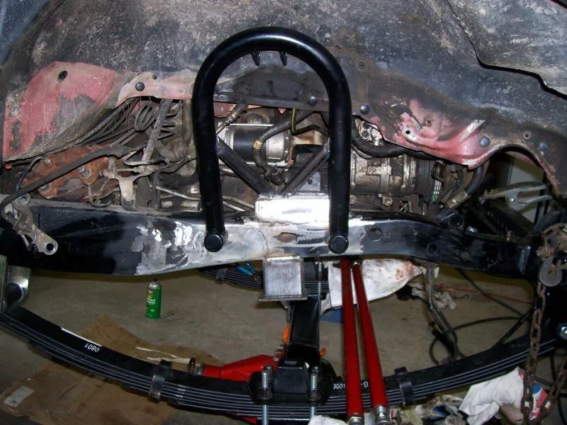

Now with the hanger and springs in place we started rebuilding the axle equipped with high steer kit from trail gear. They do not tell you on their web site that you will have to move your steering box, so the experienced team leader saved us some down time there.Thanks to Albert's research the problem with steering box was solved with the IFS steering box bracket kit from trail gear,ordered ahead of time. The shock hoops were also welded up after test fitting the shocks and position check.
