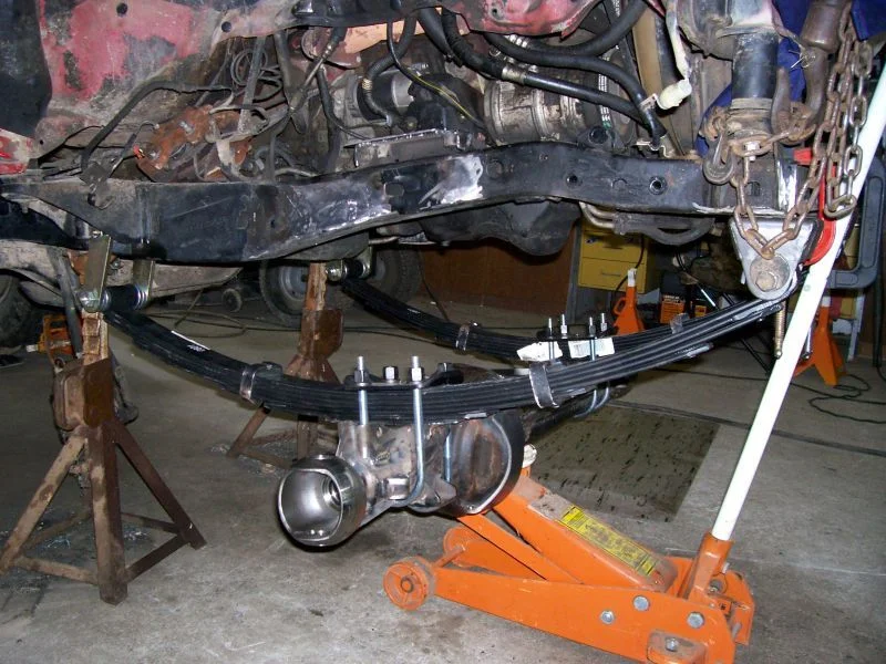

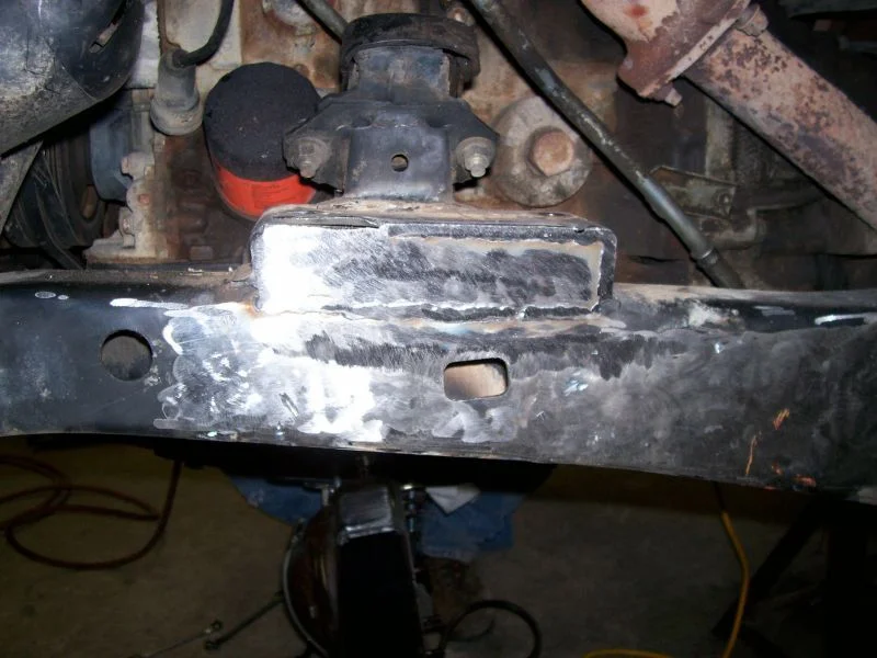

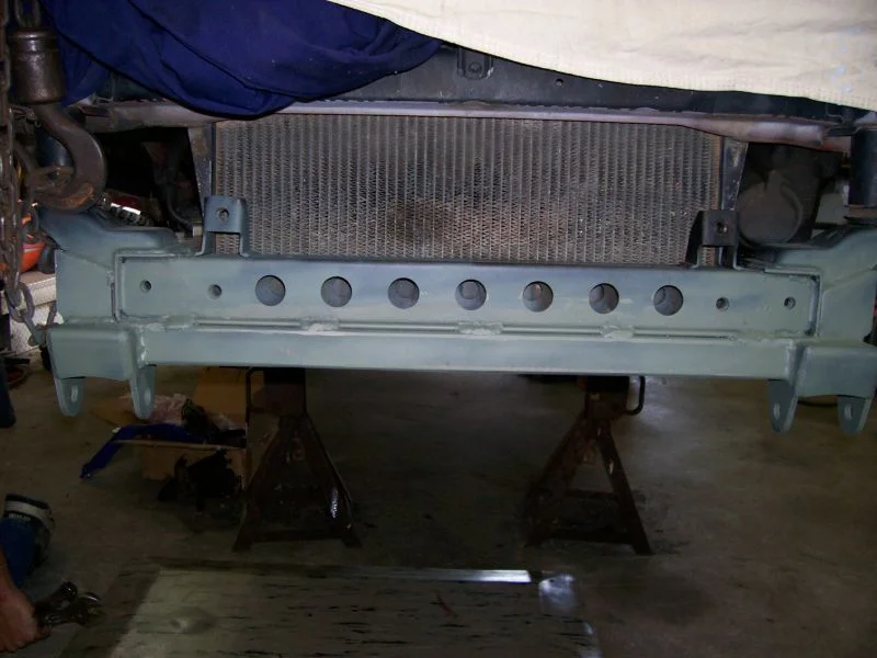

We then started installing the front hanger. Bolted the axle housing up and checked the shackle angles at different measurements according to hanger position. Decided on installing the hanger a half a inch forward compared to the existing cross brace. We filled in the gap between the hanger and brace with a piece of metal rod and Albert welded the two together. While working on the front end the motor mount covers were welded in also.
