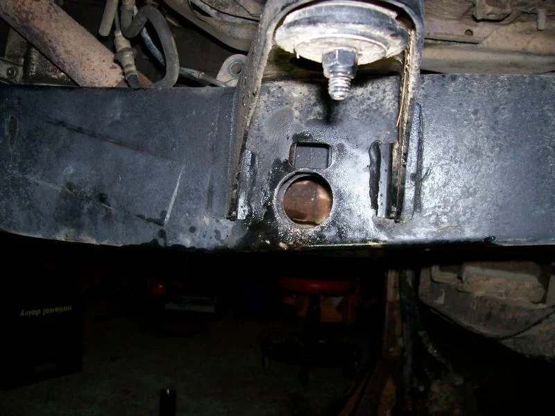

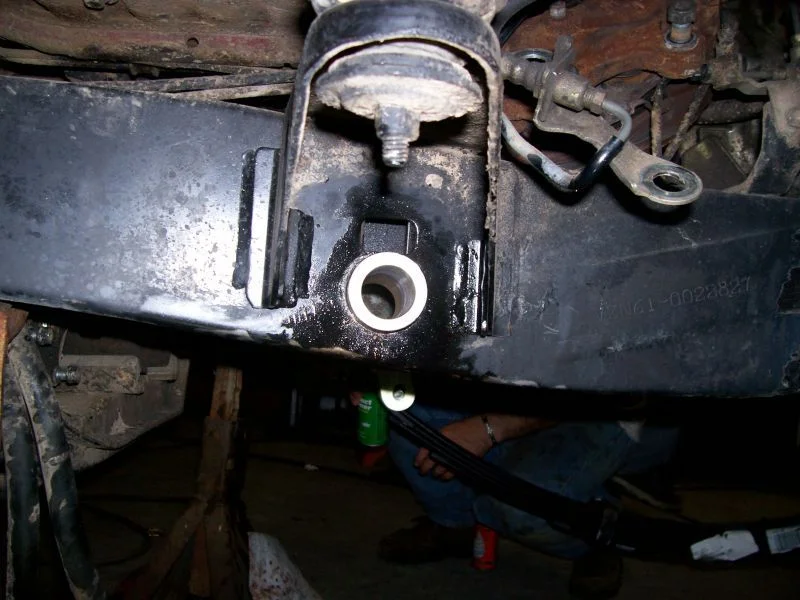

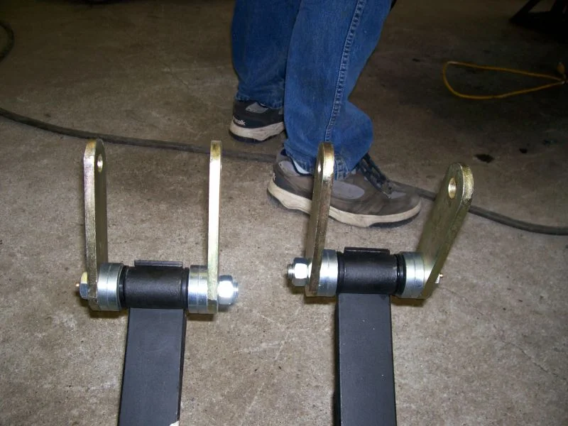

We used a few hole saws to cut the bushing hole in the frame for the front shackles. There was also something in the frame rail that we cut out with torch and removed with some pliers. Once the holes were cut we installed the provided bushings the way the instructions suggested.
