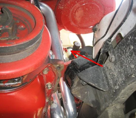

I offer this picture to highlight a Landcruiser feature. While laying under my Cruiser bleeding my brakes I can see the master cylinder. Cardinal sin to let your master cylinder go dry while you are bleeding your brakes. You have set yourself up for a difficult situation. It is actually more difficult now than starting from dry because pouring more brake fluid on top of a system partially evacuated will trap air betwen the old fluid and the new.
