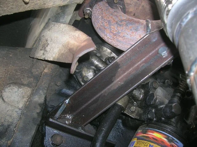

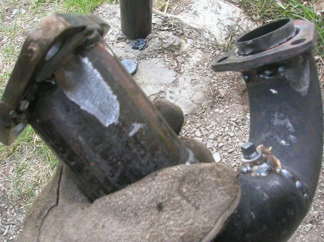

Here you go Martin, I didn't have a pic of the brace, but yesturday when I finally got around to changing the stock elbow into the intake that I had to jim shim since it had split I took a picture of it. Bacically it bolts onto the block down low and then I welded a tab onto the U-manifold part to bolt up to the brace also. (would have just welded it, but this way it was easier to put on and take off)
