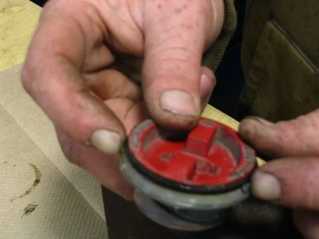

Pic 4- just showing the stopping points

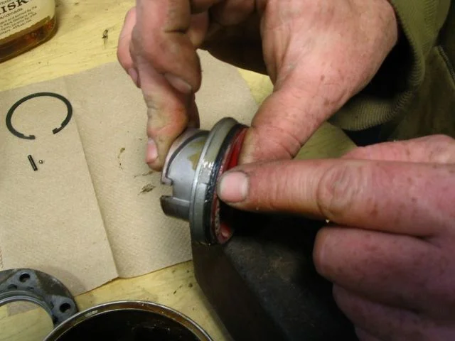

Pic 5- grease up this rubber seal well... make sure not to crush it when you are putting it back in the housing... I had to turn it back and forth to make sure it was in there and together correctly.
now just put back together.... I always put them in the "free" postion that way you can put the spring back on there all the way tight.. just seems easier I guess for me
