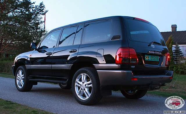

I can post the picture her too, of the 2001 100 series with 20" 200 series wheels!
The 200 series have 60 mm offset, the same as the 100 series. The 20" wheels are 8,5" wide, the 18" wheels 8" wide. Backspacing of the 18" 200 wheels should bes the same as on the 100 series, a little bit different with the 20" wheels because they are wider.
