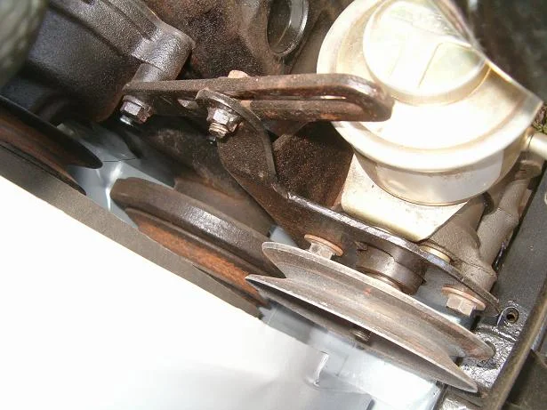

I moved my alt to the passenger side on my 74 with a 78 alt mount and made a pump mount to fit the bracket under the air filter.
I used a Toyota pump but a GM pump should work.
Kevin
