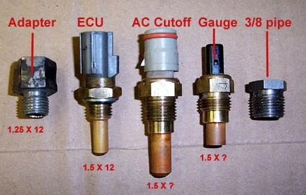

It should be a 19mm deep well. There is a “tab” that sticks down so to socket has to clear this to go on, but it should be no problem. A 6 point socket would be best.
Old picture.
Bill
