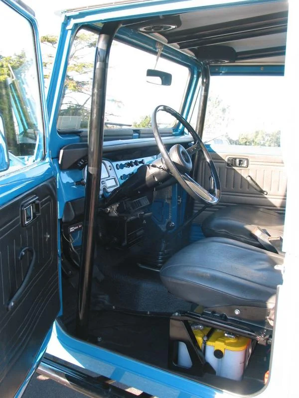

I used the oddesy batteries in the race truck and they are nice! small, light and plenty of cranking amps. When I did the dual batteries under the seat on my old FJ40, I used two yellow tops, a bluesea systems battery switch, no isolator and wired them under the seat. I made a roughly 2" deep tray I made ot hold the batteries out of 14 gauge sheetmetal, with re-inforcement.
Heres the best pic I have.
