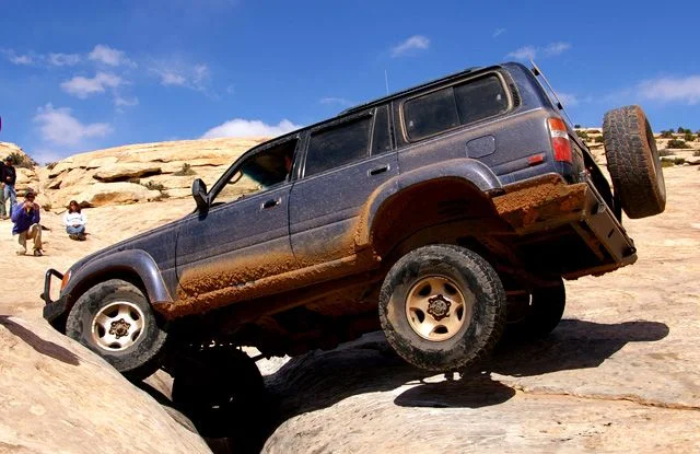

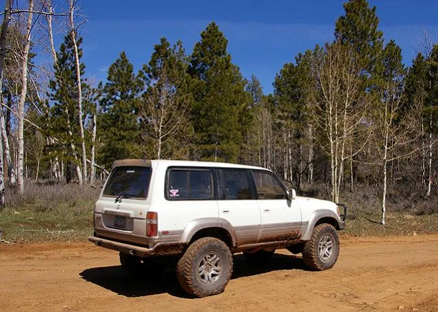

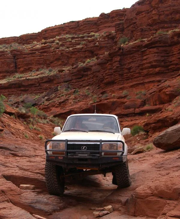

I have run Moab a few times with 33’s (295-75x16), this was the first time running the 37’s. Way happy with them, places where it struggled before, it easily walks over now. Brother Rob’s with the 315’s has historically had an easier time in rock than mine.
Other than my front arms allowing slightly more flex our setup is the same, J’s, L’s & 1.5” front spacers. Our trips usually include a mix of rock play and long distance touring and both rigs are close to stock weight. For our use the OME setup works well, they are soft enough to give a good ride for long days and flex well without unseating. If anything I would prefer a slightly softer spring.
