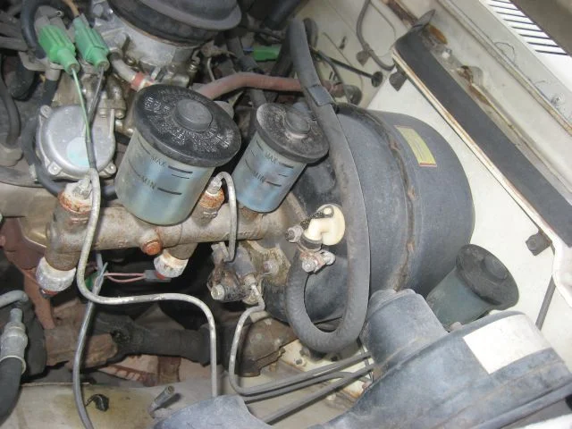

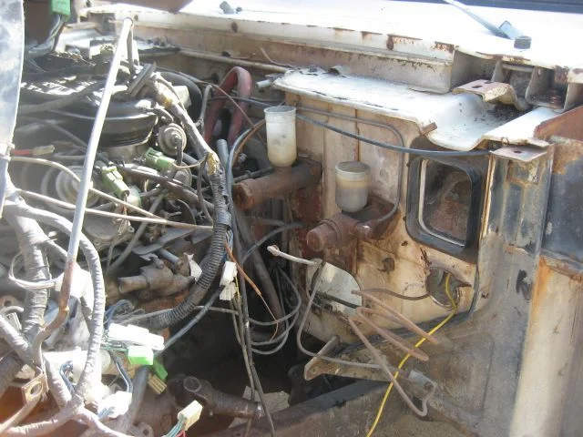

Have posted this in the 55 section on "body transplant" but it might have a lot more exposure here and is pertinent to all that have single system brake master cylinders and want to upgrade BOTH brakes and engine
Question; has anyone used a remote brake booster when there has been a 2f install in an earlier pig or other LC with a single system nonboosted master?.......I personally do not like the idea of a single system although we drove around for years with them......and without a booster
in this transplant 69 body to 79 frame with 2f; there is just no way that the booster + master cyl will fit with the 2F and carb........the toyota brake booster and master unit would knock out the carb.........hotrodders use a remote booster and we had the hydrovac/bendix remote booster for single systems in the 50s ; europeans used the old ATE-50 series also same time period and single system; these folks make a dual system remote booster Engineered Components, Inc. - Hot Rod Brakes and Brackets - Your One Stop Brake Shop!
any thoughts and comments are welcome; TIA
Lou
picture on left is 78 fj55 with dual system and booster
picture on right....transplanted 69 body on 79 frame with 2F in place showing single system original unboosted brake master cyl clearence situation!
