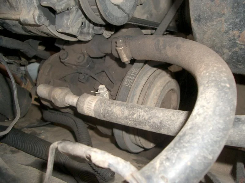

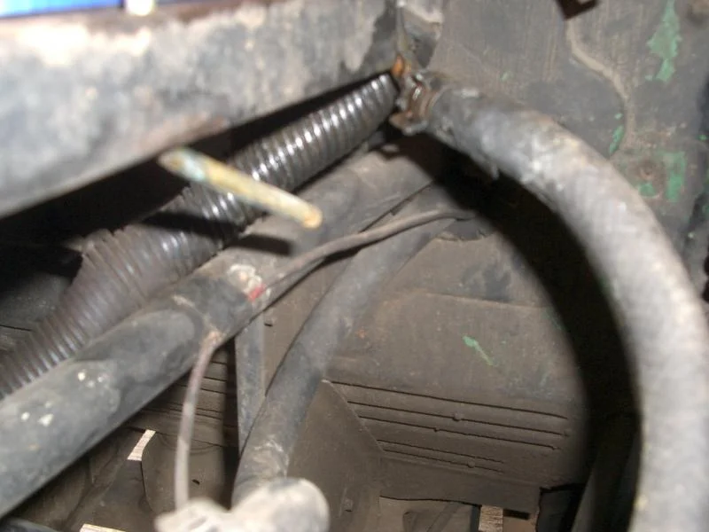

It also looks like you have the a/c condenser there, and the a/c in-cab unit. Is the rest of the a/c system in place? I didn't spot the compressor or the dryer receiver in your engine bay picture. Pretty rare and desirable if you have that set up. Let's see some more engine bay pics.

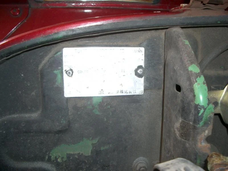

Wow thanks for the info. Please keep it coming especially regarding my mystery dash switches. Now as to the items that you noted I was able to sand the paint soot etc off of the firewall plate. I tried to shoot a photo of it but the numbers are the same as the background just in relief . Here is the info:
TOYOTA MOTOR CO. LTD. JAPAN
MODEL: BJ40LV-KO
ENG: B
FRAME: BJ40-047640
COLOR TRIM (JAPANESE CHARACTERS)
681 LP11 C-18?
PLANT: H41-KO82
A11
36415 (JAPANESE CHARACTERS)
Per the Production code chart this means (assuming a tub/ frame match) that I have a B engine made on the J production line, 40 series hardtop with a left hand drive, 4 spd, ambulance doors and I think that the loose A11 means that it was meant for the North American market. Per the color and trim codes the rig was originally medium green offered on 40's from '81-83. Given the transmission engine combination, the H41 transmission with the B engine was offered on 40 series rigs in 1981 and not in the USA.
Given your observations I am now intensely interested in getting everything off the frame to see if the frame number matches the one listed on the factory body plate. I'm starting to think that the PO and DMV registration of this vehicle are off and that in fact this is an '81. A/C: The rest of the system seems to be in place and connected see pics below. Mileage: The odometer stopped at 198,298km. Windshield Washer nozzle: before I read your post I was cleaning out the rig and running basic safety checks when I noticed that the wipers worked but there is no washer system. Repeat no nozzle above or below the windshield and no washer fluid tank in the engine bay. As you correctly observed no heater either. This will have to go onto the to do list as I plan to take this rig back to the U.S. with me in 18 months when my tour is up and we do have winter. RUST: the lack of rust in these areas is what won me over to this truck vs. two others. Passenger front foot well three nickel sized rust holes. Drivers side: none but has bee repaired with sheet metal at some point ( all solid). No rust visible looking up from the underside at the drivers foot well. Air Vent/Washer Arm compartment under the windshield: no rust visible from the outside, minimal rust from the inside after I removed the covers. Rear door sill - no rust. On the exterior of the sill, facing out a quarter sized rust hole ( that is the largest one on the entire rig.) It would be great to find a regular owners manual for a 1980 BJ 40, that would help me decipher the dash at least.
