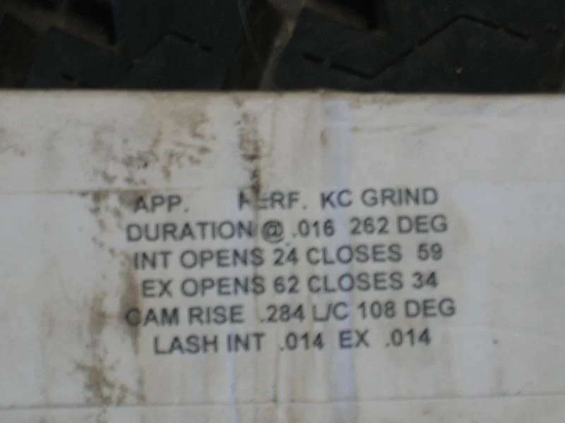

Had my cam reground by Delta. Specs are below. Great improvement on top and bottom end IF combined with header, shaved head, engine balance etc. By itself I don't think you would gain much.
