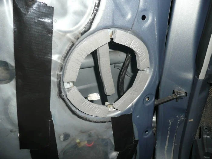

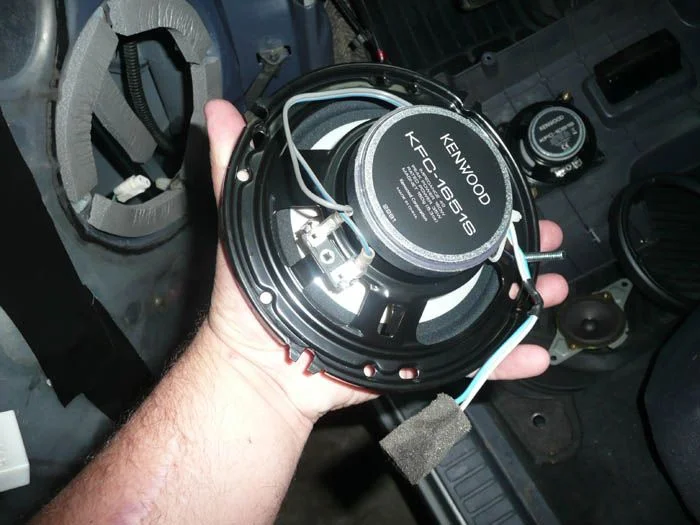

Pic 1 shows the factor wire soldered into the Kenwood speaker.
Pic 2 shows the foam in place on the window run and around the speaker well to act as spacer and cushion for the speaker. It bolted in place using the stock holes, but I had to use longer screws.

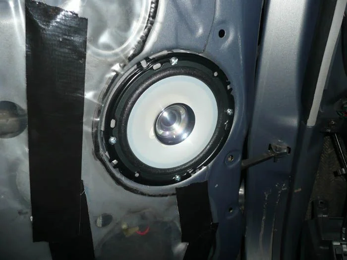

Pic 3 shows the speaker mounted...pretty much hassle free.
