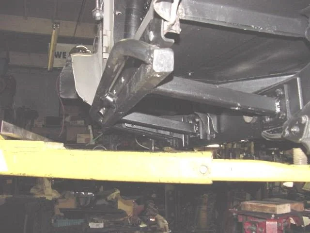

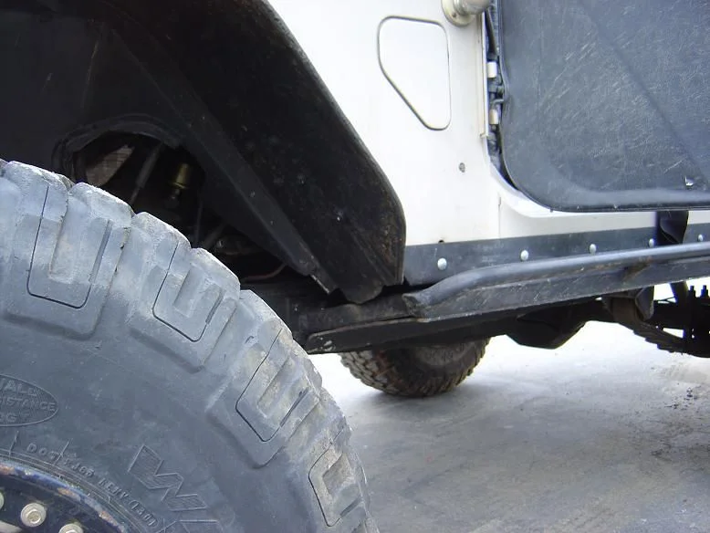

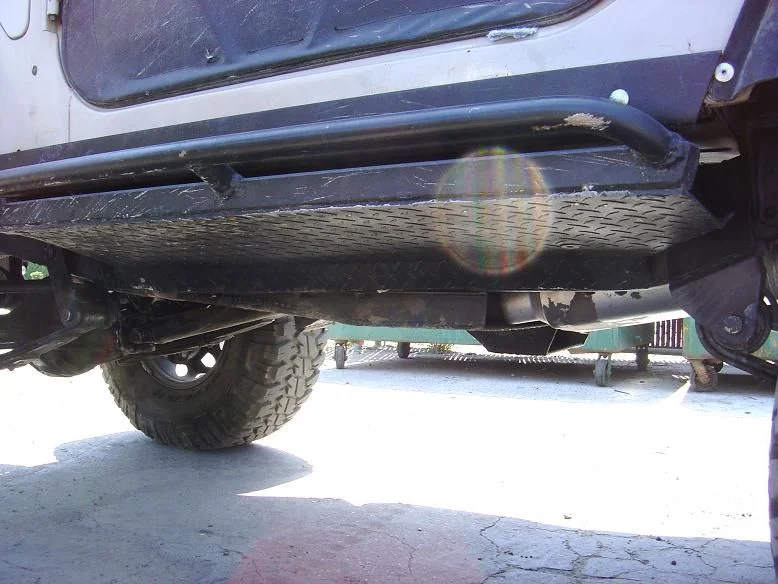

Cut about 3 or more inches off the rocker panel. Fabricated some rock sliders. Welded 3 oversized scab plates to the frame then drilled and tapped. Then fabricated some square stock extensions. I like the design because they are strong and removable. I then used some diamond plate aluminum sheet and cut it to match the underside of the rock sliders. Drilled and tapped with inset allen heads. They work great.
