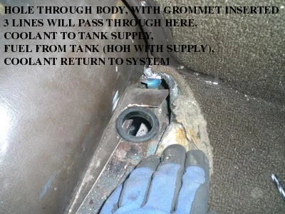

I poked a hole in her! Started with a very small bit to determine exact location was OK from above and below. Once I determined it was ok, I got out the hole saw, and finished the hole off with a nice grommet. This hole will be one of the very few places that is not insulated, but it is a very short distance! This hole will locate the fuel lines right beside the tank when it is installed, and comes out just above the frame, so the lines will be easily secured under the truck.
