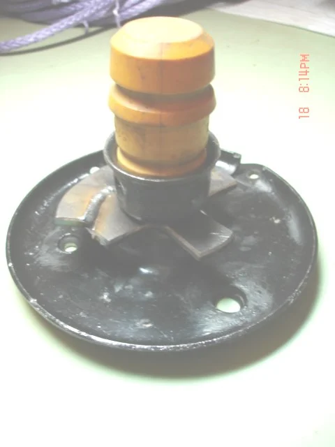

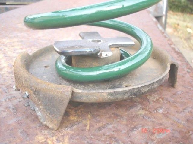

And capture both ends of the coil spring. It really won't be that hard and will do a lot for stability..
Here's how I captured my coils top & bottom. I'm using rear TJ coils & buckets. In the 1st pic, I have since countersunk the plate that holds the spring:
